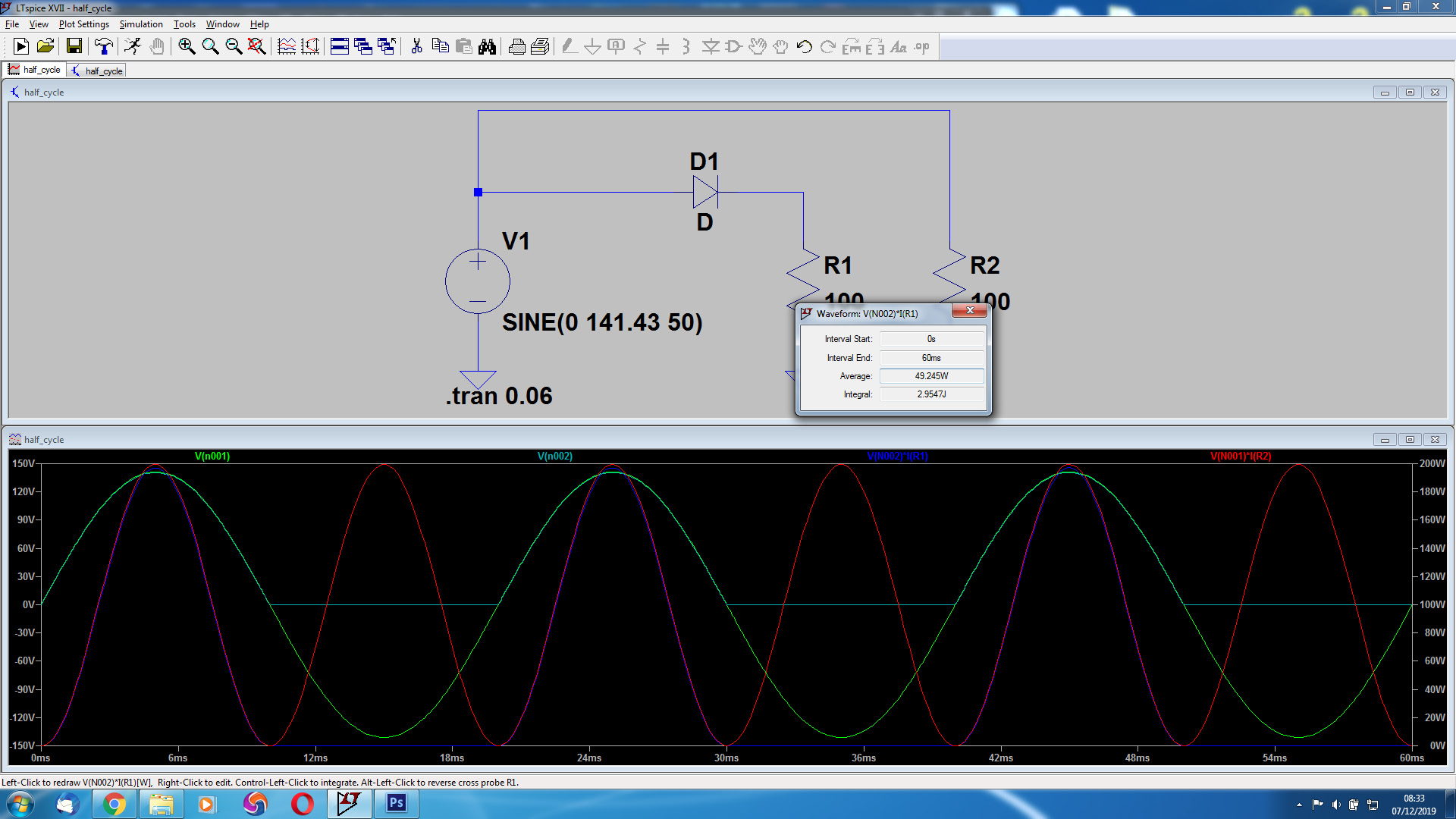

OK, I had to find out if I was cracking up or not....
LTSpice sim attached.
100V RMS 50Hz sine and 100 Ohm load resistors. Showing six half cycles as a convenient plot size.
On full wave 100W is dissipated in the load resistor and one joule is transferred each half cycle. (OK, 99.99something watts).
The load resistor with the diode in series dissipates 50W and transfers one joule per full cycle in round figures, just a fraction under due to the diode voltage drop.
The load fed through the rec definitely dissipates half the full cycle power. Check it for yourself.
(To get the power display popup in the simulator, control-click the label of a wattage trace).
[Edit - six half cycles not full cycles.]
