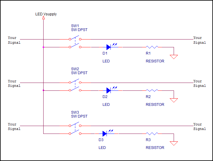

OK, So here's the schematic.
The signal generator on the left is just going to be a guitar input. The example is how I want an LED on each switch. So when a switch is on, the LED is on.
While I don't fully get what is going on with the circuit you could likely save some headaches and rather than use SPST as shown use DPST switches dedicating one pole to the LED.

Using a DPST would mean it turns on when the switch isn't on the right path, unless I used a transistor, which I was trying to avoid to keep costs low.
No thats SPDT, Single Pole Double Throw
You need DPST, Double Pole Single Throw
Okay, all is sorted now, thanks a lot Reloadron and 4pyros. Now just to find some DPST footswitches... That are cheap. :| Hahaha.
Like the attached DPST. Each LED is a separate circuit. When switch is closed your signal is passed and LED illuminates.

Thanks buddy. I think I'll end up using DPDT switches as latching foot switch in a DPST config are a huge annoyance to find at a decent quality/price. ^^
I'm still not entirely clear on how this would have worked, but I think your original scheme was to carry both the guitar signal and the LED voltage in a single circuit, with the guitar presumably going into the input of an amplifier, correct?
While you could have made that work, another problem would have been a tremendous "Thump!" out of the amplifier every time you switched inputs. You could probably have filtered it out somehow, but as I said earlier, it would have been something worthy of Rube Goldberg. The double-pole switches are actually a much more elegant solution.
