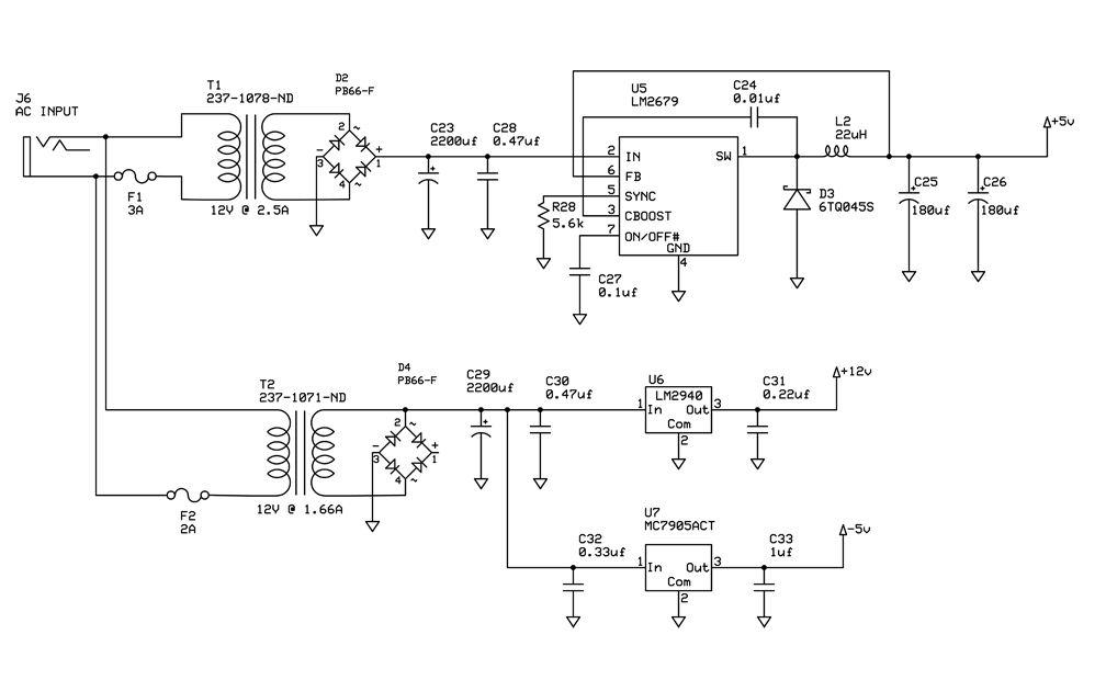

Ok here is my current design for a power supply for my project, here are the outputs I need:
5V able to drive up to 5A of current.
12V able to drive up to 1A of current.
-5V able to drive up to 1A of current.
As you see from my design, this is quite expensive for a power supply. The transformers alone are $30. Add the Regulators and its $40. Add the Misc components like the rectifiers and capacitors and we are talking $50 for this supply.
Are there any inefficiencies in this design? Any way to make this power supply cheaper and have the same capabilities? Any input would be appretiated.

Whenever you build one of something you're kinda stuck paying quantity one prices. $50.00 does not seem like a big price tag for this power supply.
Cost savings:
Is there any advantage in using the same 2.5 A transformer for both parts. I see no advantage in using a different smaller transformer for part of the supply.
2200 uF is a pretty beefy capacitor. Check the voltage ratings and see if you can get by with smaller capacitors on the inputs of the regulators.
Use a full wave rectifier made of diodes instead of a bridge rectifier.
It's not much but you gotta start somewhere.
I would be tempted to run the whole thing from one transformer, as I can see your not afraid of using a switching regulator. But, then, the thing that drives transformer cost is often the current rating, so I can see why you thought it would be better to go with a higher voltage and just switch down to +5V. The thing that bothers me about this is that a 5A switcher of such a simple configuration is going to be noisy, both electrically and magnetically and may be a hassle, forcing you to add some additional output filtering which may reduce your efficiency. I wonder if it might be better to go the other way, that is to just get only one transformer that can put out enough power for all outputs, then use a linear regulator for the 5V output (perhaps the transformer is a 6.3V type), and switching regulators to generate the +12 and -5 at 1 A. This will need a bit more thought.
By the way, your circuit can't work they way you've drawn it, since you can't get a negative voltage from a positive voltage using a 7905. And your rectifier configuration on the output of T2 doesn't make any sense. Why have you taken the output from the terminal 2 of D4 rather than terminal 1?
Sorry about the error in T2, that wasnt intentional I just made an error being lazy and copying and pasting and not paying attention, I wouldnt actually hook it up like that :p
What do you guys think the minimum filter caps I can use after the bridge retifier? Also, I wanted to use 2 transformers because of size considerations. And I can't use an ATX power supply because this power supply is just part of a bigger project i'm working on thats going to be enclosed in its own case.
Also, yeah i looked at the spec sheet and it does require a negative voltage for the negative voltage regulator, what was i thinking. Would I have to use some kinda of rectifier that only gives me the negative part of the AC or something?

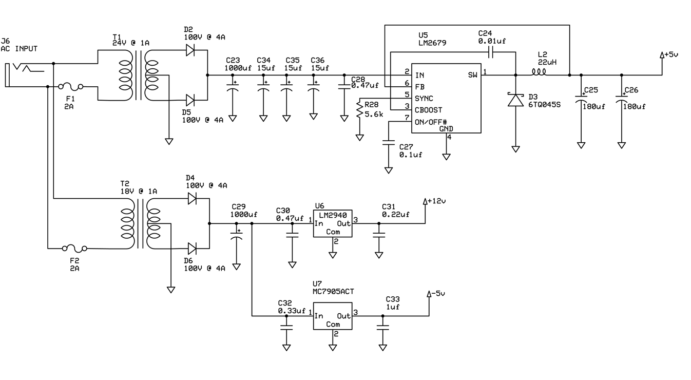

Ok I redid my power supply a bit a brought down the cost of the parts to about $35 by settling for 4A at the 5V and bring down some of the ratings for the parts. Can anybody else think of anything else I can do to bring down the costs? Also, how do I go about getting the regulated -5V out since the current way I have it setup wouldnt work?
Russlk said:
Make D4 into a 1/2 wave rectifier by disconnecting D6 from C29. Reverse D6 and connect it to U7. You will have to add a 1000uF cap.
Would that mean that 1/2 the power from T2 would be supplying the -5V and 1/2 the power would be supplying the +12? Would this work? Because the +12 needs 12VA of power and the -5 only requires 5VA of power. So that means the +12 would only get 8VA of power instead of the 12VA it needs to drive 1A.
This is logic correct?
The transformer will supply whatever the load requires (unless it burns up). The disadvantage of the arrangement is: 1. the ripple frequency is lower, so a larger filter cap is needed. 2. Since the load is unbalanced, there is a DC unbalance in the transformer which could cause more heating. If your transformer has excess capacity, that will not be a worry.

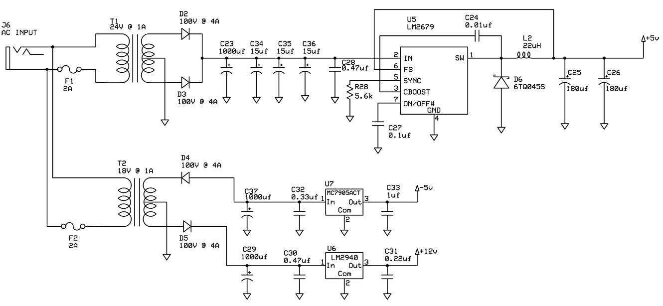

Ok here is the final schematic I'm going with.
Do you guys see any problems before I go ahead and order the parts to test this?

Nigel Goodwin said:
I would suggest replacing D4 and D5 with a bridge?, a half wave rectifier isn't much good at 50/60Hz - a bridge as two full wave rectifiers is MUCH better.
Do you mean replace both D4 and D5 with a single bridge or a bridge bridge replacing each diode?
I ask this because I need to be able to rectify a negative voltage for the negative voltage regulator (the -5V output). If I replace D4 and D5 with a bridge I wont be able to do this.
FusionITR said:
You do the same as D2 and D3, that's a full wave rectifier, add two more to give the negative half as well - it's normal to use a bridge to do so.
Sorry, to be mean, but if you don't understand such a simple basic circuit perhaps you shouldn't be looking at vastly more complicated switchmode regulators?.
