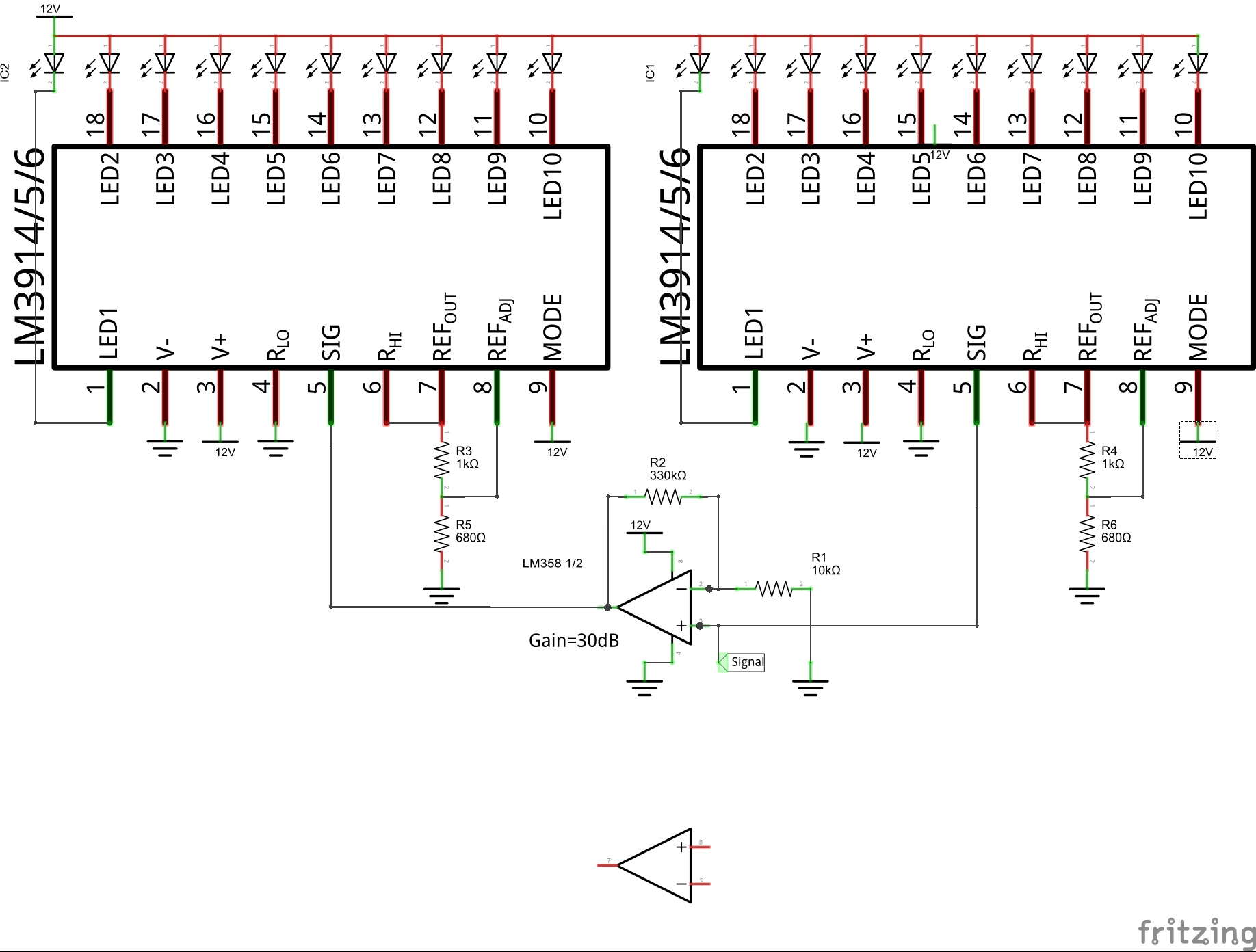

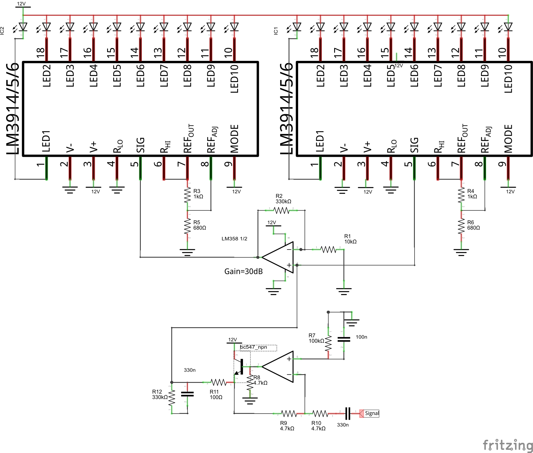

Hmm, i now noticed something that's not intended behaviour: bar has less leds lit in peak-mode, shouldn't it detect most-highest peaks? instantaneus-mode has more
Hmm, opamp should have gain of 1, as in your peak circuit, but in mine i measured with generator:
input:416mv
output:820mv
so somehow i have gain messed up or something?
i don't have 2n3904 so i used bc547
oops, i measured opamp gain totally wrong, it is correct

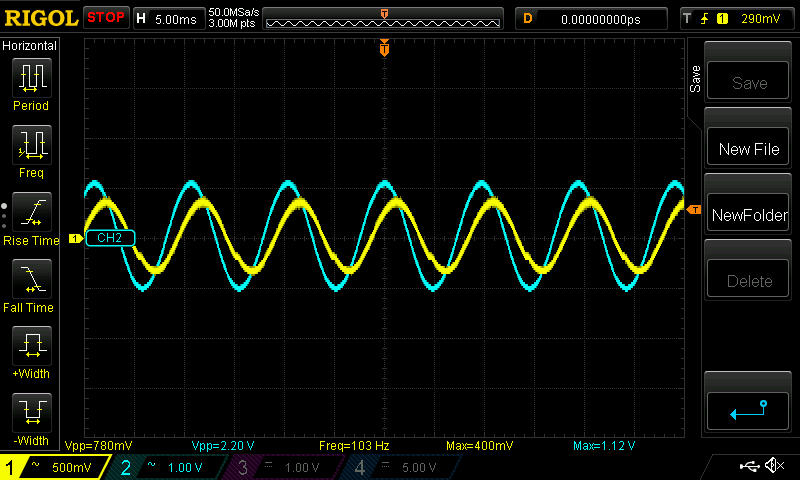

Here's shots, both sections go via opamp amplifier
so, yellow is generator, blue is opamp amplifier input, also other 3915's input
peak: NewFile3.jpg
hehe, feeling quite dumb here now, i placed 330r resistor in place of 330k in paraller with c8, well now it works! sorry for false alarm, quite EE hobbyist i am -_-
Only now there's another problem, lower set, -30db is lit even without signal applies, checked with scope and there is 1.2v dc bias so no wonder they are lit. Placed capacitor, dc is gone, but now it behaves even more strangely: at first, leds light like they should, but when second set starts to light, lower ones start to fade?
so, instant-mode works, but when i put peak-circuit, no matter before or after amplification, things go sour, only first few leds light. I don't have virtual ground anywhere
and both amplification and peak-detection is built in same lm358
what is strange also, when i switch that 330k to 330r, it works better in peak-mode, more leds are lit?
The 330k resistor being 330 ohms explains the very high ripple and quick release time shown on the 'scope.
The fairly noisy LM358 might be causing the -30dB LED to be lighted all the time.
Yes, please post your schematic.
sorry guys, forgot that schematic earlier in a hurry

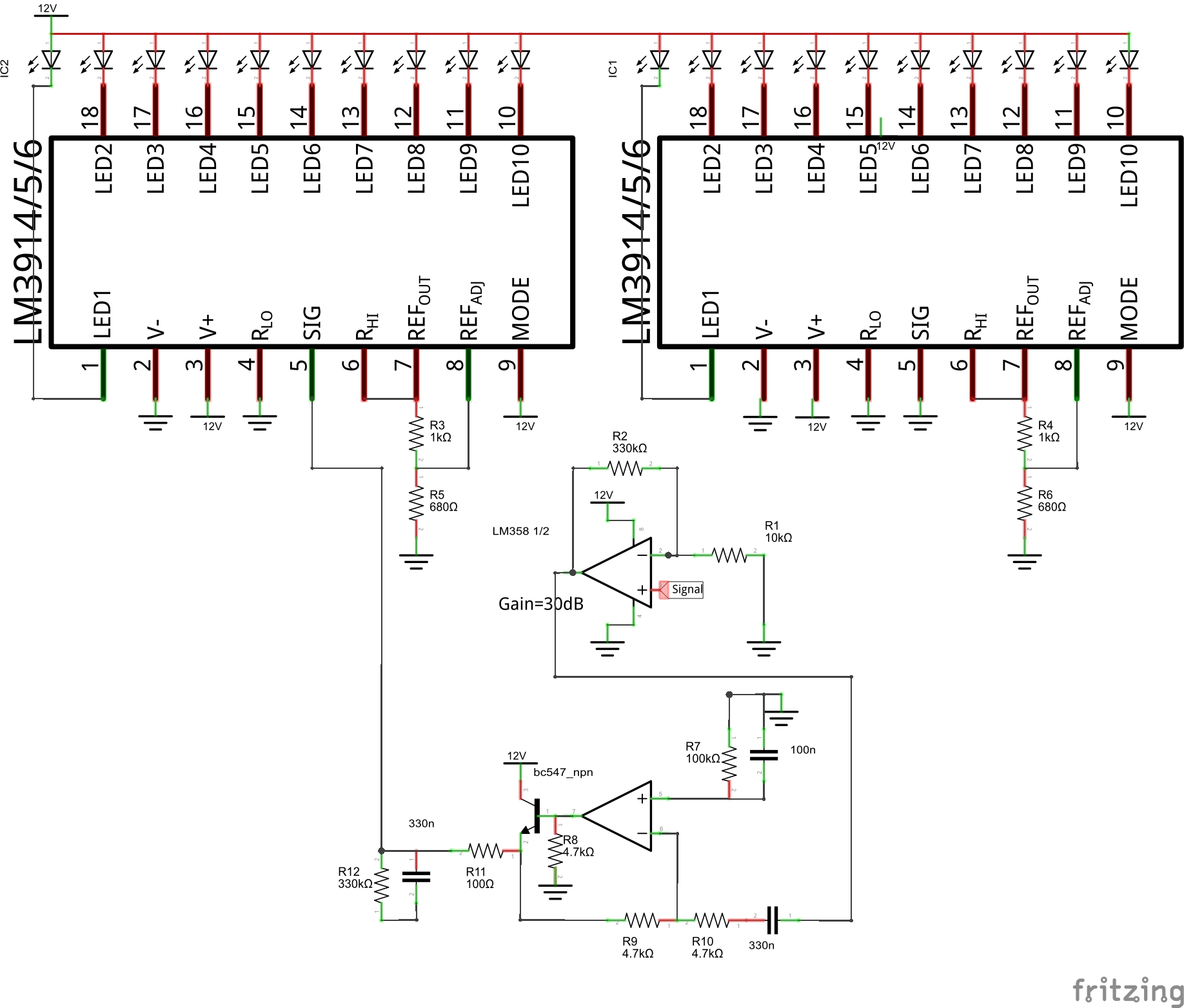

here's what works fully as intended, even with speaker hooked:
Then these variations won't work, first peak detetor, from there to amplifier, some leds lit even when signal is grounded (dc in amplifier output)
then backwards, first amplifier, then peak, works but only first two leds light in first, lower set of leds, nowhere near instantaneus-mode (only other lm3915 under test this way, i have only one lm358 on board now).

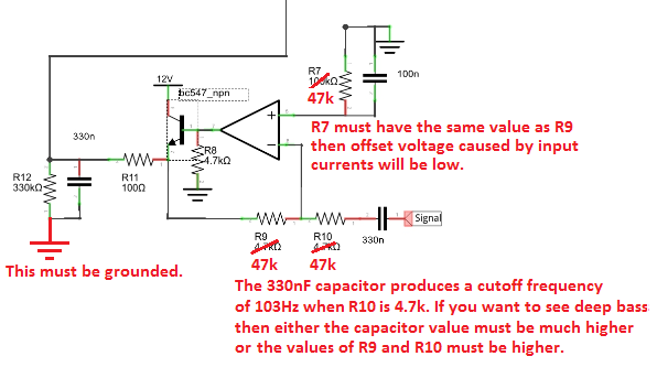

You made a few mistakes with the peak detector that I corrected for you.
Your reference voltages are only 2.1V which is a low sound level in a speaker (the 20th LED will light when an 8 ohm speaker power is only 0.28W). Then the 1st LED lights when there is no input because it will show the noise and the input offset voltage of the peak detector opamp. With the 20th LED lighting at only 2.1V then the 1st LED lights with only 3.0mV. If you change the voltage reference to 10V (6.3W into 8 ohms) then the 1st LED will light when the input signal or the input offset voltage of the opamp is 14.1mV. The max input offset voltage of an LM358 is 7mV.

Thanks for pointing stuff, again, out guru! that ''this must be grounded....i have it grounded, but missed it when drawing schematic. I'll try those what you corrected. I never listen more than 1w at home even when alone, so i adjusted reference voltage for that. But, i'll try those.....
Your second schematic correctly shows the peak detector feeding the 30dB amplifier and the SIG input of the high levels LM3915. But first fix the peak detector.
Your 3rd schematic is completely wrong and the opamp will be damaged by the sound signals feeding its input way below 0V.
The 30dB amplifier is supposed to amplify the output of the peak detector (not amplify the signal) so that the first LM3915 shows low levels.

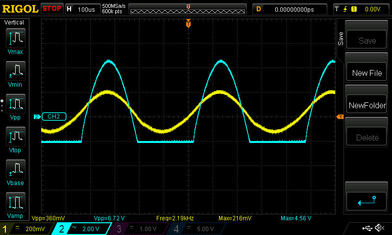

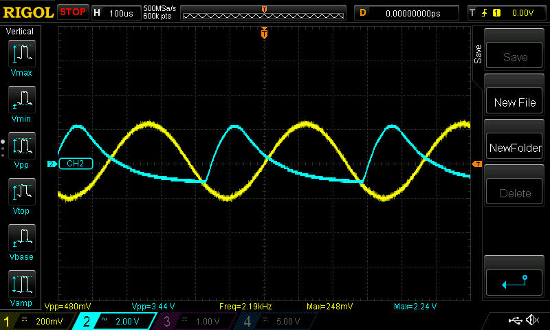

But, back to this one, i have now all those resistors value of 4.7k (r7, r9, r10), and here's shot
blue=input from generator
yellow=output from peak detector
ac-coupling set at scope, with dc coupling, yellow shows dc-offset
and, only peak-detector now in use here, changed opamp just in case
and i made mistake in drawing that schematic earlier, i mean other that that grounding: r9, r10 were 100k (seems copy-paste got me when i coped resistors....so it was complete replica from what you posted: r7, 9, 10 were 100k)

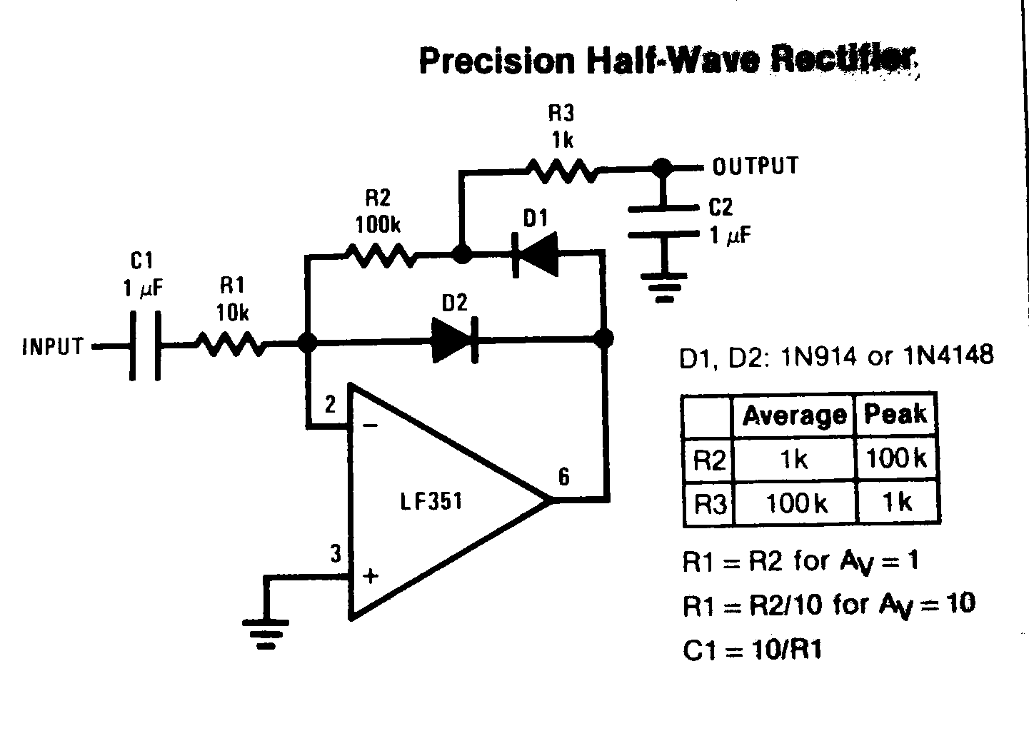

But, just to clear things out, i now built that your original version, and, no idea why, but output is quite noisy to say the least....
peak-detector-png.95063
It would be better to Build this Peak Detector.
A TL071 or TL081 can be used, But it Does require a Plus / Minus power supply
