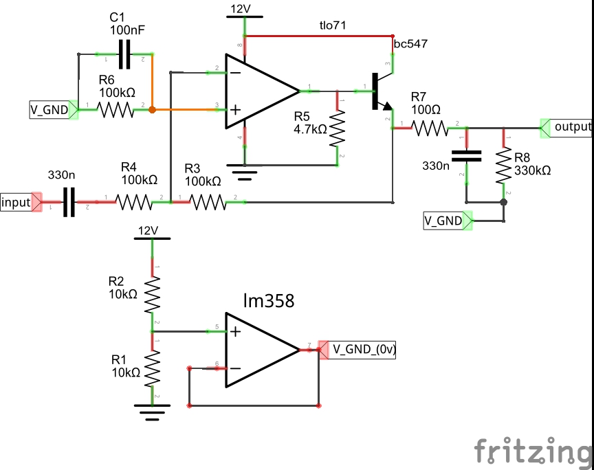

Your new peak detector has its output reference voltage at half the supply voltage which is not compatible with the LM3915 that needs it at ground.
It does not have the current-boosting transistor at the output of the opamp so it might not charge the capacitor fast enough for high frequencies.
The output of the opamp will suddenly go as low as it can for each negative half-cycle of the input and the delay for it to come back up to normal ruins it at high frequencies, it is missing a second diode to prevent its output from going too low. The 100k at the output should be 330k for good low frequency detection.

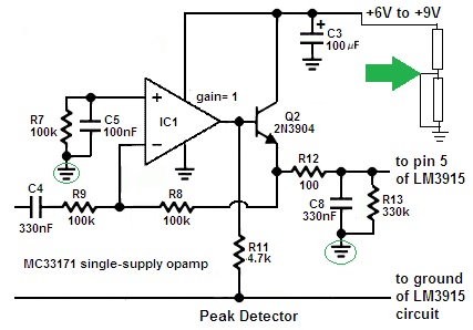

With a single +9V supply its input can go from 4V to 5V.
missed this one here, seems tlo71 is no-go then, well, my supply can go only to 15v but 5-12v would be best supply voltage range
Somebody on one of these threads is going to try using an ICL7660 voltage converter to make -5V from +5V for a dual polarity supply for his opamps. But the converter produces 10kHz interference that might be heard.
The negative supply pin on a TL07x connects to the negative power supply voltage and the connection where the positive supply's ground and the negative supply's ground connects to the circuit's ground. Then the input and output of the opamp can swing above and below ground without going near a power supply voltage.

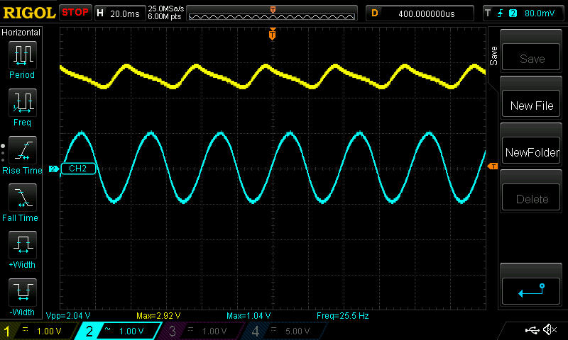

hehey, seems now there is output we're after (at least much closer), except if my circuit is wrong but why it would work then hehe....so, here's circuit i have now (your circuit) for tlo71 & shot from skope
blue=input from generator, yellow=output from peak detector.
i'm not entirely sure did i hook this correctly, but you tell me....what i wonder is that virtual ground is tied to normal ground and shorting that other resistor?i used two 10k resistors to create virtual ground, green stuff at schematic is virtual ground

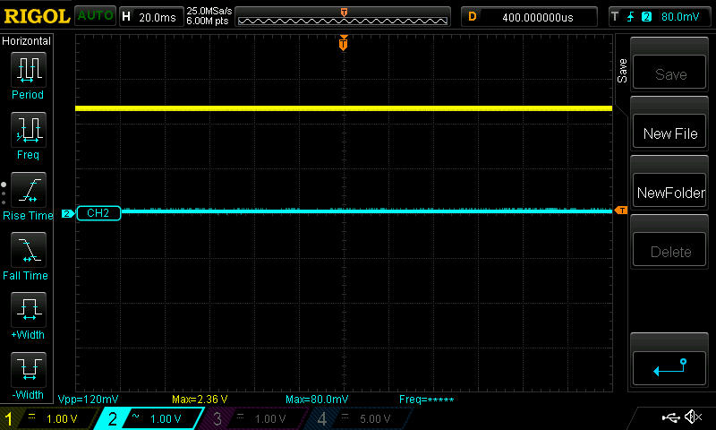

also, without signal applied, peak detectors output stays at 2.52, supply voltage is 12v one sided

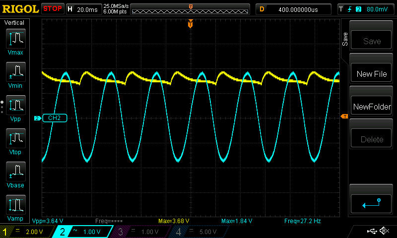

so here's now circuit, measured towards power supply ground as reference, +9v
again, blue input, yellow output
output, same as earlier, only changed both channels to same volts/div
and output without signal

With the virtual ground voltage at +6V then the peak detector signal to the LM3915 ICs can be no lower than +6V so 18 of the LEDs will always be lighted. That is why using opamps with inputs and outputs that work all the way down to ground (single supply opamps) or using a plus and minus supply with the bias at 0V must be used. If you tie the virtual ground to the power supply ground like you said then you do not have a virtual ground and you are shorting the output of the virtual ground opamp.
A virtual ground can be used when the input and output of an opamp has a series coupling capacitor. But the output of the peak detector is an important DC voltage so a coupling capacitor to the LM3915 input cannot be used.
In post #85 you show an opamp wrongly because it has no negative feedback and its output will be latched as high as it can go.

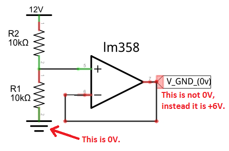

You cannot use a virtual ground for the peak detector circuit because its output needs to go down to 0V so that the LM3915 ICs work properly.

whaa? well that makes sense now that you mention it, i thought opamps that need split supply need also virtual ground....sorry!

A single supply opamp has inputs and an output that work all the way down to 0V (ground) that you want for the peak detector.
But an ordinary dual-supply opamp will have inputs and an output that work all the way down to 0V (ground) only if it has an additional negative supply so that its inputs and output stay in their working voltage range which is around 0V.
0V is where the negative of the positive supply joins the positive of the negative supply.
A virtual ground is used when an opamp has a single positive supply but needs its output to swing up and down around its biased point like with audio.

You need the output of the peak detector to be 0V with no input signal, a small positive voltage with a small audio input signal and a large positive voltage with a large audio input signal.
If your positive supply is +12V and the virtual ground voltage for the peak detector is +6V then you need a voltage shifter to change all voltages down 6V. The voltage shifter can be a single supply opamp. BUT then you should use the single supply opamp as the peak detector in the first place so that you do not need to shift the voltages.
