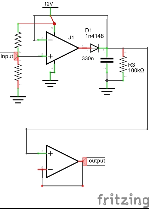

The 330nF capacitor will charge very quickly for each cycle then slowly drop its charge in (330n x 330k=) 0.1us which is 100ms to 37% of its maximum charged voltage. One cycle of your 147Hz is 6.8ms so the charge on the capacitor should not drop much for each cycle.
Is your 330nF capacitor 0.33uF or is it wrongly 330pF? What resistance is your 'scope probe? The LM358 is noisy but with a gain of 1 it is not that noisy.
The peak detector circuit from the datasheet uses a diode and my circuit uses an emitter-follower transistor as a current-amplified diode. Therefore it is the same circuit as mine except my opamp does not need a negative supply. My circuit charges the capacitor 10 times faster than theirs.

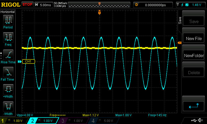

any suggestions what would cause so fast decay on peak detectors output? i measured capacitor with meter just to make sure it is 330n
The amplifier has a gain of 1 but the 'scope has a gain of 5 for the amplifier output signal.
The amplifier is supposed to have a DC output but your 'scope shows no DC.
The signal input is fuzzy like a hacksaw blade instead of being smooth, maybe the 'scope shows the teeth 5 times larger.
The output has repeating bumps 6 times the input frequency. Maybe they are from the signal generator? Edited
Where did you add the 10k resistor to ground to reduce the noise? The input of the amplifier is where the signal generator feeds. Edited correction. The input of the amplifier is where the output of the peak detector circuit feeds. The input of the amplifier must not have a 10k resistor to ground and must remain a high resistance. The signal generator is supposed to have a low impedance output so a 10k resistor parallel to it will make no difference.
Since the amplifier is a DC amplifier it must not have an output coupling capacitor. With no input signal the output should be 0V or maybe up to 7mV which is the max input offset voltage of an LM358. Maybe your input wire is picking up mains hum? Maybe your IC is fake or is not an LM358? Maybe the output capacitor to ground is electrolytic that stores a phantom charge instead of being a film type?

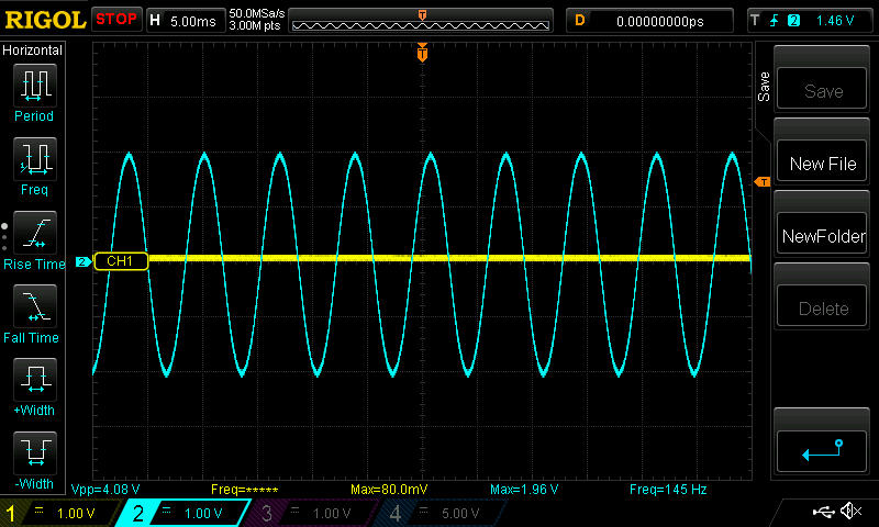

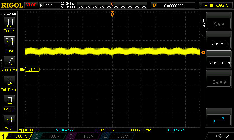

without signal at all (grounded just to make sure), peak detectors output shows this, could be picking noise as i'm using breadboard, but please judge
I really can't tell or to be sure whether these lm358's would or not be fakes, of course it is possibility which must be taken in consideration
Output capacitor is not electrolytic, it's these, ceramic monolithic, all capacitors i use in this circuit are ceramics, excepct main filter which is electrolytic 100uf

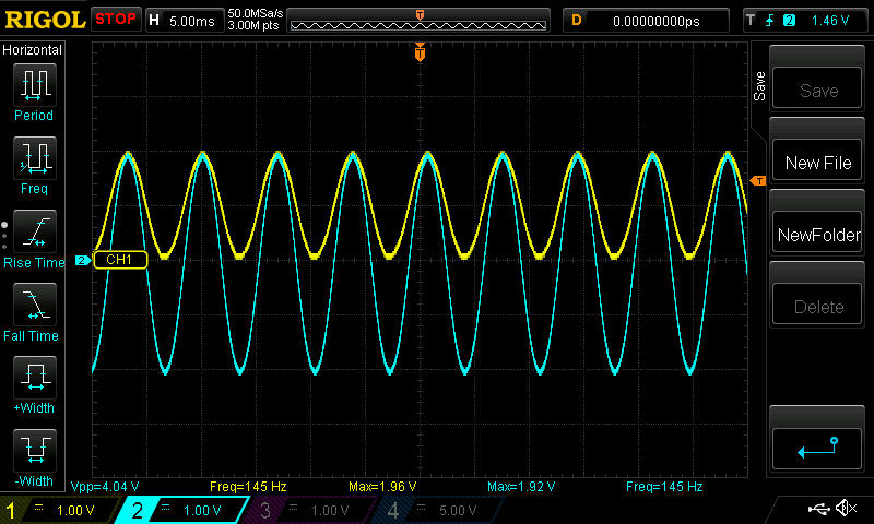

made again measurements, this time from bit more places, ONLY peak detector here,
Blue is input from generator at all these
output from peak
where 100k resistors meet, non-inverting (+) input
inverting input
and, output from opamp, which is connected to bc547 base
and, dc coupling in both channels

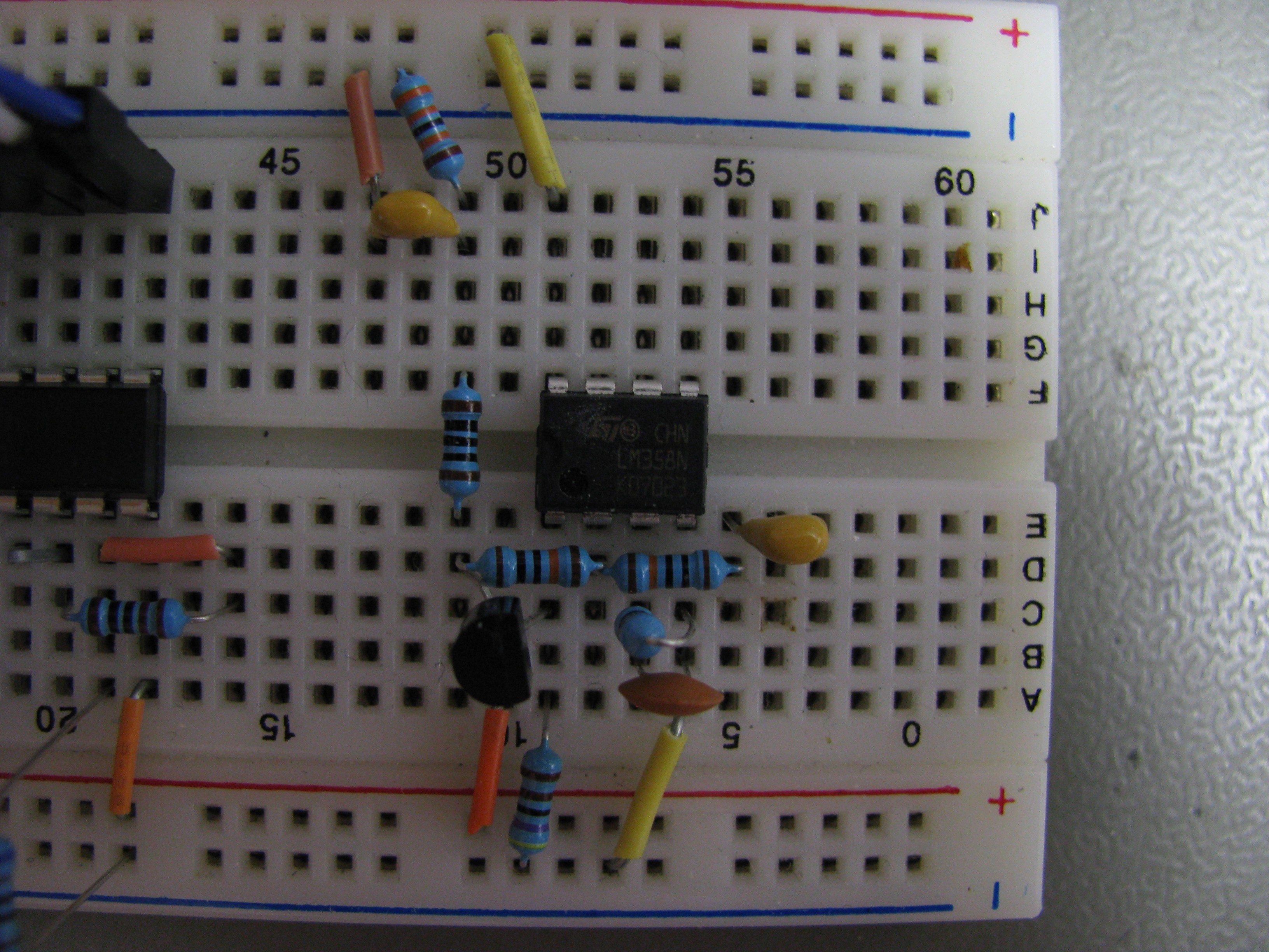

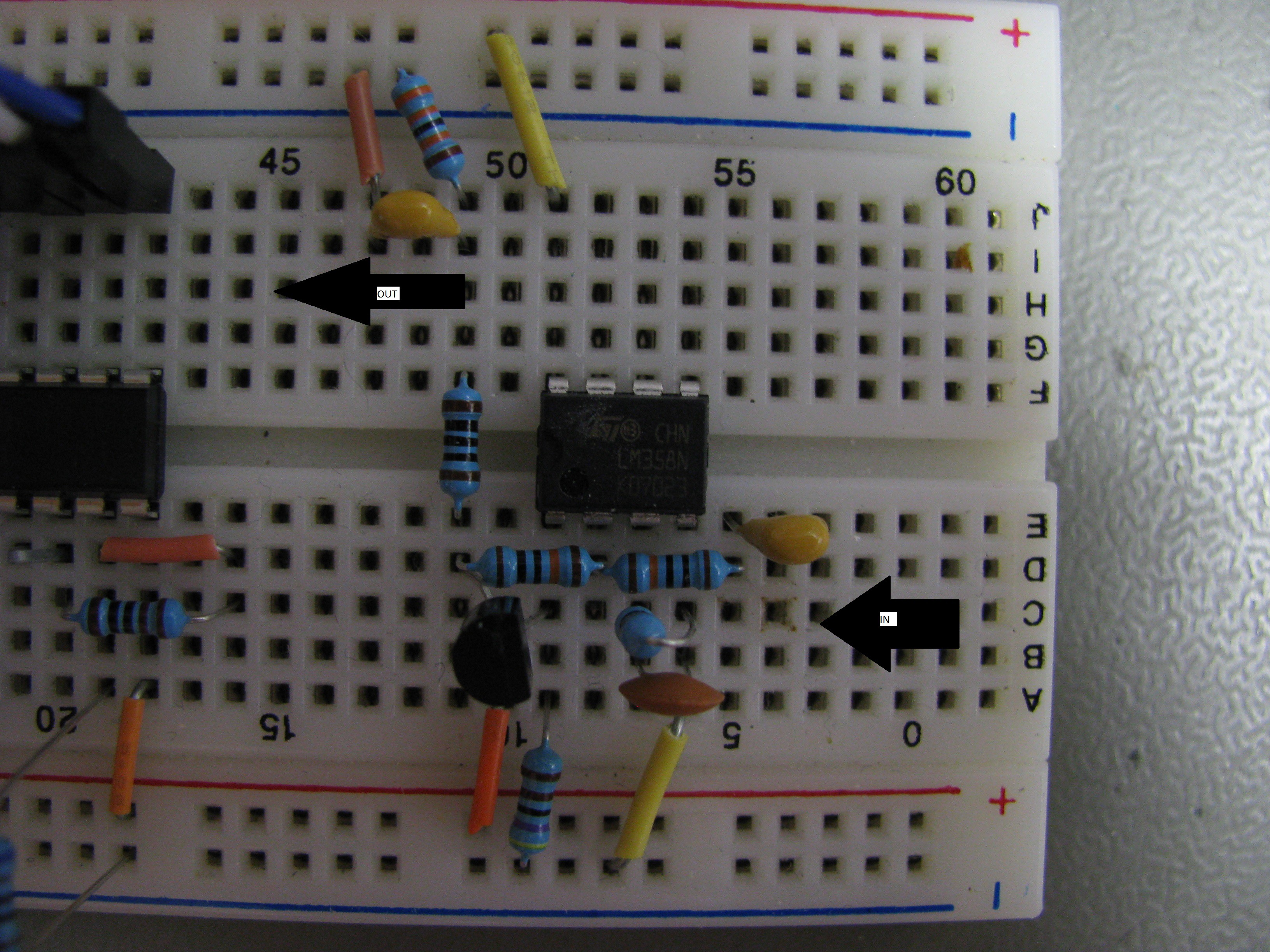

and here's pictures from actual breadboard, if i've just made connection error?
A breadboard has many rows of contacts with a lot of capacitance between them. It also has many fairly long jumper wires with fairly high capacitance between them and between the many rows of contacts. The rows of contacts and jumper wires are antennas that pickup mains hum, light dimmer hash and all kinds of interference. Use a pcb or compact stripboard layout instead.
A ceramic capacitor is a microphone. Use film capacitors instead for audio or low frequency coupling.
Your 'scope chops up the traces because it is a digital 'scope.
The scope should have a 1M input resistance, not 240 ohms and the peak detector output parts are designed to feed a high resistance input on an LM3915, not a 10k amplifier input resistance.
The opamp has sharp narrow pulses on its output and I do not know why. It might be caused by the very slow speed of an LM358.

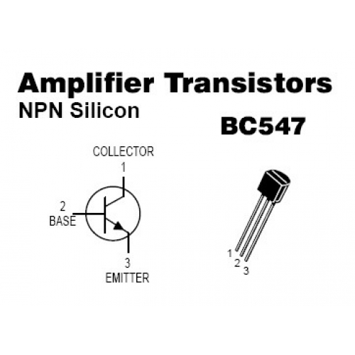

Double-check the layout of the pins (CBE) on the BC547 transistor that are the opposite to an American one (2N3904) that are EBC.

well i've checked pinout for bc547, and it should be correctly, colletcor is directly to VCC
Tap on a ceramic capacitor or vibrate it with sounds and it produces a signal. Ceramic is similar to piezo material.
Does the 1M 'scope probe have 240 ohms in series with it? Then it will be fine if the peak detector output is not overloaded with a 10k resistor to ground.
There are many opamps that work fine from a single positive supply without needing a negative supply and they are much faster then the slow LM358. I used an MC33172 which might not be available anymore in a through holes package and might be in only a surface mount package now but there are many others.
The peak detector output is supposed to have peak DC voltages that slowly drop when the signal stops. Your scope shows plenty of signal on the peaks which is wrong.
You have shown the correct pins on a datasheet but I cannot see them on your circuit's photo.

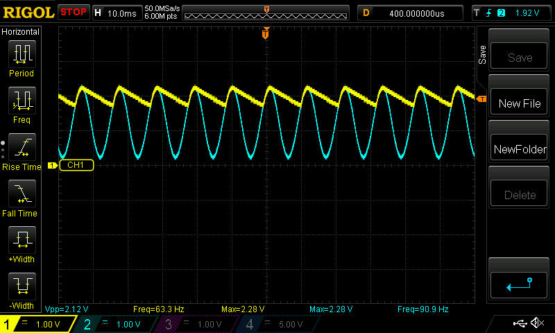

OK, tested totally different circuit, much simpler and worse but just tested, and at least here it behaves like peak-detector.
blue=input, yellow=output, dc-coupling on both channels. biasing at input so it won't damage opamp, just simple ''super diode'' but solely for testing, i suppose this is sort of waveform we're after at output?

The datasheet of the TL071 shows that its inputs do not work if they are within 4V from the positive or negative supply. So if the supply is 8V then its inputs cannot go positive and cannot go negative. With a single +9V supply its input can go from 4V to 5V.
Also, the TL071x and TL08x have a fairly common problem called "Opamp Phase Inversion" where the output suddenly goes as high as it can if an input goes closer than 4V from the negative supply. The circuit can be modified to use TL07x opamps with a plus and minus supply.
