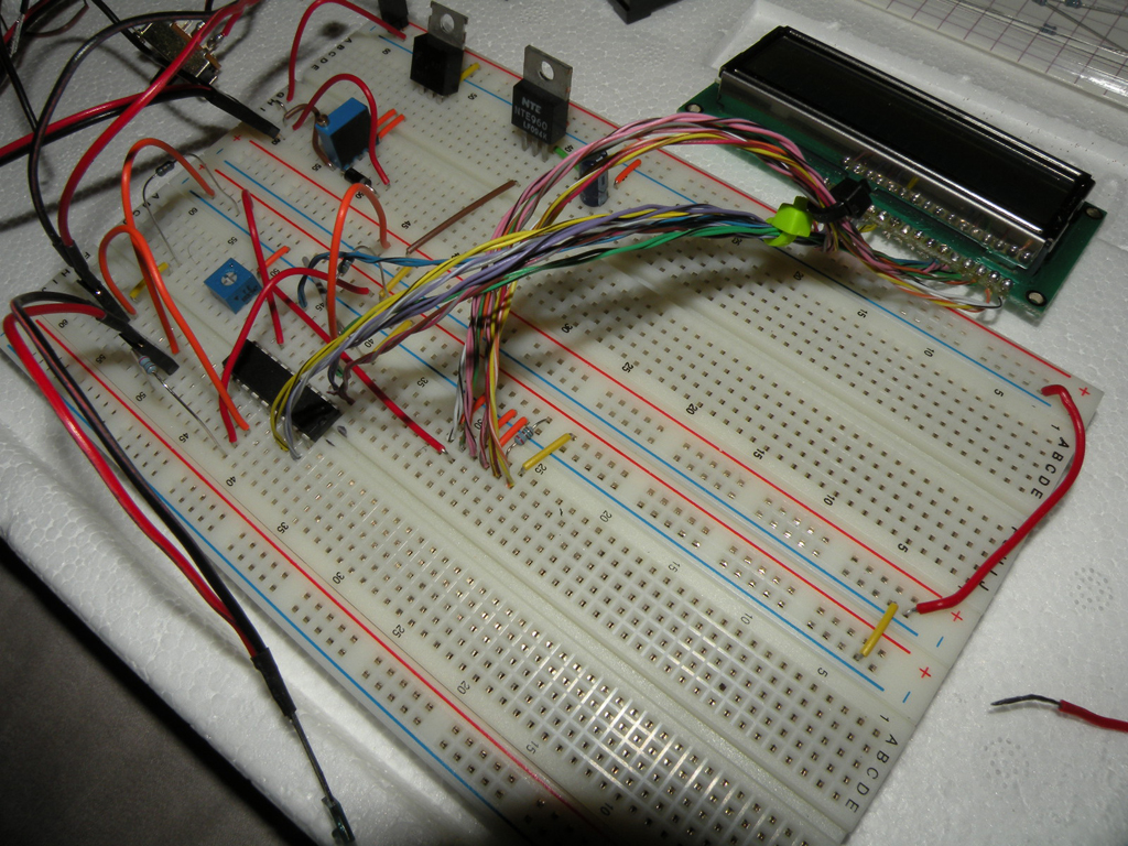

I'm also attaching a picture of my breadboard.
