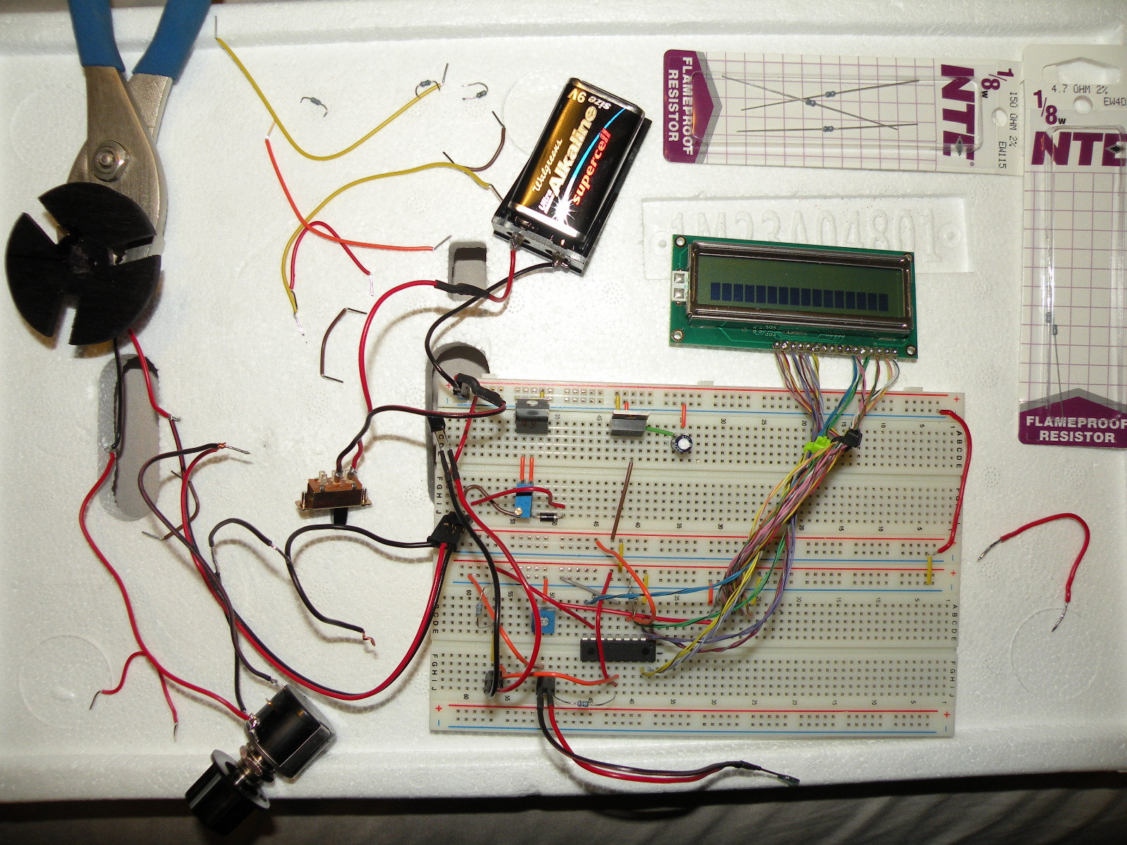

I'm also attaching a picture of my breadboard.

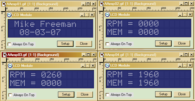

Ran the TACH.hex file with the Oshonsoft Simulator, got these images.
I used Nigels WinPic to disassemble the hex into TACH2.asm
It appears that the LCD is being initialised OK.

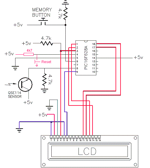

hi Dustin
Checking Sarma's post, the 4k7 is not on MCLR its on RA4, which the RS control to the LCD.!

So that could be the problem, having a resistor going from +5v to pin 4 on the lcd and pin 3 on the pic? I noticed on the voltages I listed I was still getting +5v on those pins even with the resistor.

Yes, there is a small 10k pot between pin 3 and ground. I'm trying to get my girlfriend to e-mail me a picture of my breadboard viewing straight down so you can see how I have it setup better.

can you imagine what I did, i had a display with berg male connector
plugged on to breadboard and jumper straight to PIC.
generally i locate that area only for lcd

Your schematic has shown the green wire direct to ground !! btw , how do you manage to post image or text file?

hi Dustin.
On that that 10K pot, one end is connected to 0V and the other end to +5V , with the wiper connected to the contrast pin for it to work correctly. Adjust the pot until you can just see the black blocks.
