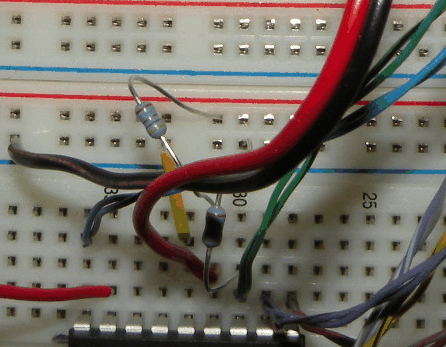

Correct, this is the component side. Well I had this setup laid out on a pcb and all I got what a steady solid top row on the LCD.

Well I got it all setup at the top of the breadboard correctly with the new wires on the lcd. The decoupler caps got rid of the pulsing. However, the lcd is still showing solid black squares.
I know the pic is transmitting data running the dustin1.hex file because the 4 data pins on the lcd are all changing voltage. I'm thinking I may have killed the lcd somehow.
Either way, I'll have another lcd tomorrow to test again with. If that doesn't work then I will try to build a basic pic circuit on a pcb to see if I can get the lcd working. If that option works I will go ahead and build the tachometer pcb.

This weekend I did however build a basic board with bus wire for just the 7805, pic, resistors, decoupling caps, and header pins. I kept the pins lined up in order. I am still getting the solid black boxes on the top row, even with the 10k pot for contrast adjust. I really don't know what is going on, it does it with both LCD screens so I know one isn't bad. The data pins are still seeing voltage changes so I know the pic is transmitting data. The only thing I can guess is the programming is wrong for the setup. Same pin assignments as I have been using. I guess I'm going to have to try and learn some ASM to see if I can get this thing to work. I don't get it, it should work.

Hey Eric, I tested the program last night and still no luck. The LED was blinking though. When testing voltages something weird did happen though. I looked down and noticed the screen was initialized. I was finally able to turn it off and reproduce it. When touching the RS pin with the positive meter probe, with the negative probe not touching anything, the screen will initialize and be blank.
This is crazy, the chip works, everything seems to be hooked up right, LCD will initialize with a little positive voltage on RS from the meter probe. Yet it still doesn't display. I've tried several different schematics, verified all connections, and still nothing but trouble. This really can't be that hard. :mad:

hi dustin,
Dont go mad just yet.:)
The RS pin is connected to PIC pin PORTA.4 which is an open drain [ no internal resistor] thats why the 4.7K is connected to it and the other end of the 4.7K to +5V.
Try reducing the 4K to say about 2.2K.
The effect with a long meter wire is to be expected.???
Are you saying when its initialised you can see characters on the display.
No, still no characters. The screen just initializes and goes blank. You can adjust contrast to be sure it's still displaying. At one point I was touching some other pins randomly and actually got some oddball characters to display IE: ($&%_@*). I think this was from the meter seeing the different signals as binary display input.
It sounds as though you have an hardware wiring problem on the board to the LCD.?
As you can see the Basic program could not be simpler, as you can see the LED is flasing about 0.5sec so the program is running OK.
Are you using the project board or the PCB for these tests.?

The 4.7K on this picture shows it going to 0V not +5V
hi dustin,
Did you see my EDIT regarding the RA4, pin #3, its connected to 0V not +5V.
