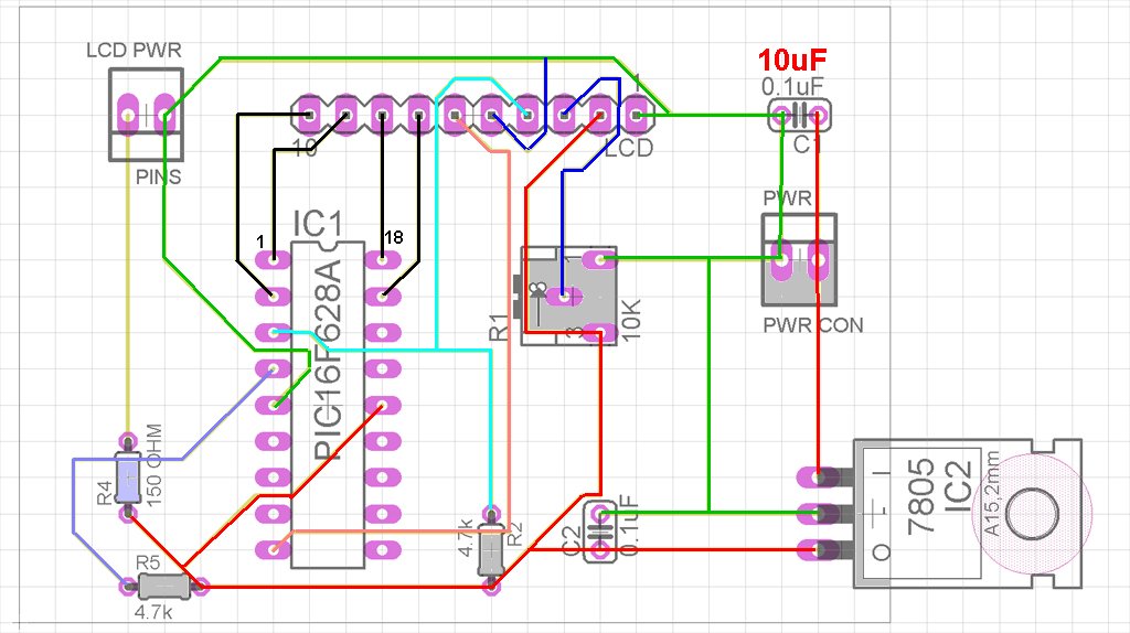

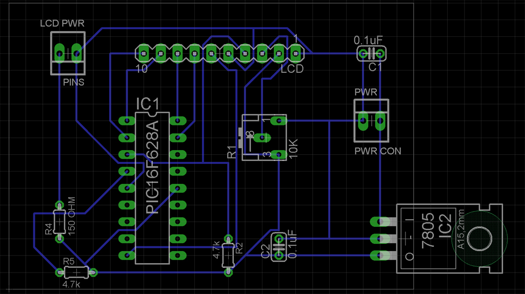

I'm using my own PCB I made for just the PIC, 7805, and LCD, with a 2K pot on the lcd contrast pin. I made the PCB layout based on your edit from this:
Same connections as this, only there is no reset button, no sensor line, and no memory button. I have a 10 pin header with all the wires of the LCD lined up in order as well(1-6,11-14), then a 2 pin header for LCD backlight for 15&16.

I know its a pain, but since you have relaid out the PCB can we have a picture of both sides of the PCB.?
I double checked the program and the wiring diagram, looks OK.

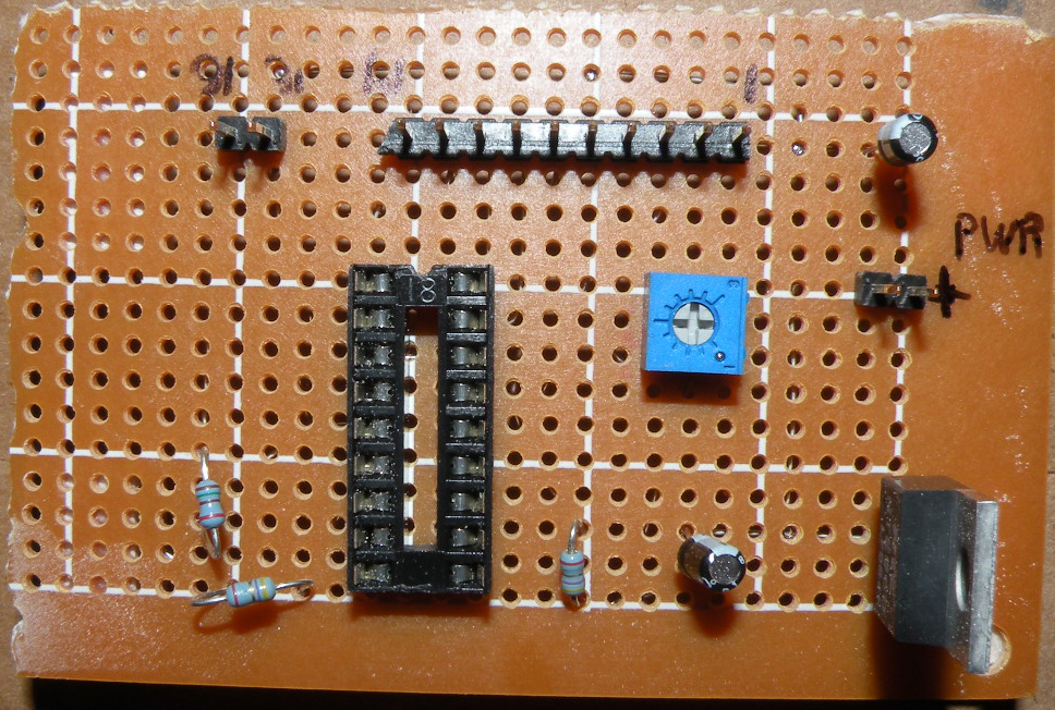

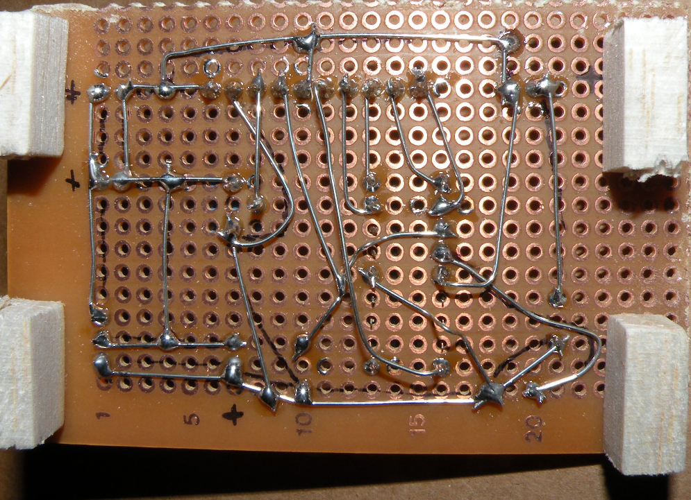

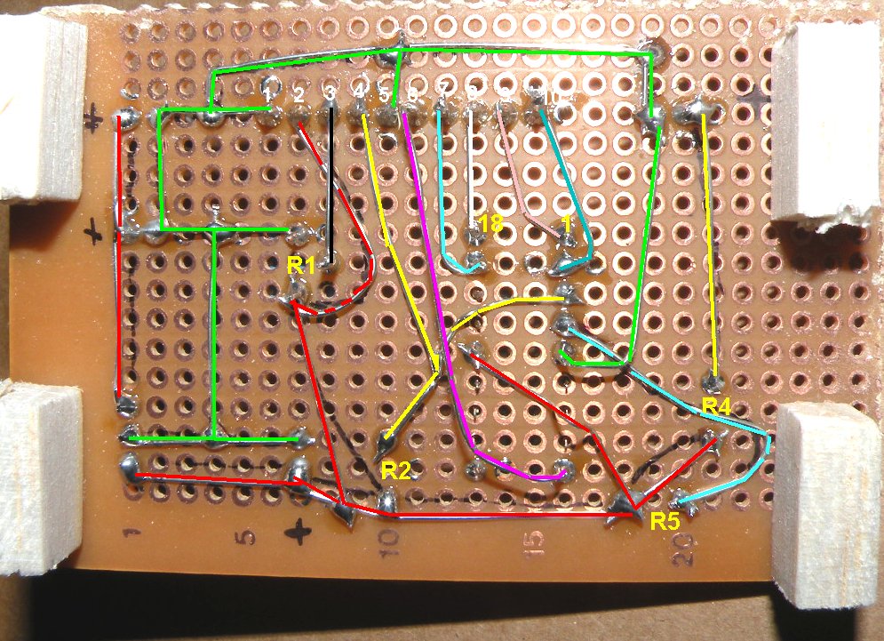

Ok, here's the pictures. First picture is of the eagle pcb. The other 2 pictures are of the board. You will notice on the board I ended up doing jumpers over some things instead of going between pins like on the eagle layout. No overlapping wires are touching on the bottom. I put small wooden feet on the bottom of the board to prevent anything like that.

Download your pics, will look them over.
The circuit looks correct.
You should have a 100nF cap across the PIC power pins as close as possible to the PIC
The 10 way connector looks OK.
I cannot see the LCD pcb, do you have a pic.?

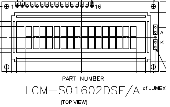

dustin, as you see the LCD panel from the top ( able to see the screen).
the counting 1 to 16 starts from left to right . a part diagram from datasheet attached
but how do you count 1,2 etc from left?
are you seeing from bottom ?

On the actual lcd pcb I cam counting from the left side at 1. My board is marked on the back which pin is 1 and which is 16. I know they are in order.
On the images I posted of my pic pcb board the header pins start from the right at 1.

By the way Sarma, I was going to ask. If you don't mind, could you post the eagle schematic and board files for the last layout you did?
I wanted to edit some values on the components. I'm going to try and build the tachometer board over the next few days and see if I can finally get this optical tachometer finished.
Thanks for the explanation Eric.
happy to share them and they were made for serving you. as theay are a set of files, perhaps it is better to send zipped. unfortunately zip format is not permitted here
you may pm me your email address i shall send forthwith.
