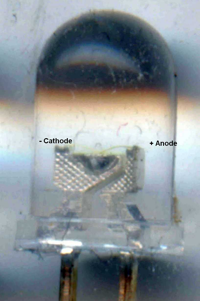

Getting back to the LED, despite what I said in reply 14 and upon further playing with the system, I cannot get the LED to come on with the key. The unit had 2 faults held in the ABS ECU, one was low battery voltage and the other was ECU trouble - operation abnormal (from a wrecked donor bike). I cleared those faults as per the manual, checked that they were clear, as per the manual, turned off the key, unplugged the front sensor and turned the key on for a bit then off. I put the system back into fault code mode and it had the code 43 - front sensor shorted or open. The really odd thing is that the LED works the opposite way it's supposed to in 'fault code' mode ie, it's on when it should be off and vice versa. I confirmed this by comparing it with my series 1 1400GTR (the type of bike the unit is from) in fault code mode for the same fault - front sensor unplugged, cleared and rechecked both a couple of times. So I have come to the conclusion that the bike's ECU, which is connected to the ABS ECU via the dash/meter, controls the LED and makes it works as it should and that having the bike's ECU out of the circuit on the 1000GTR I'm fitting it to causes the LED to work in reverse - if you follow what I'm on about. Page 12-44 (shown on page 2 of this thread) shows when it should be on and off under which conditions. It's actually off when it should be on and on when it should be off, so instead of counting blinks, I count blanks and get the correct fault code. Follow? I tried wiring in a change-over relay to reverse the operation but the current draw thru the ABS ECU is too low to activate a relay.
Any help on how to get it 'into reverse?'
LED operation can be reversed between Active High or Active Low easily with Anode on the + side always and using low side drive on the upper LED or high side drive on the lower example.
I dont know where the LED is physically located or wired, but this involves changing two connections on the LED as shown. From one to the other.
{Perhaps it is easier to add a 2nd LED and resistor to correspond with your active signal High or low.}
LED mount or unmount and rewire is up to you.
IF 5mm it looks like this.
No only one wire is reversed , the other changes power polarity + or gnd.
In order to help you, I need to know which configuration matches your circuit.
If the red lead is always on 12V change that to input or visa versa.
If the black lead goes to input , change that to gnd or visa versa.

The LED red wire is always +ve.
Thanks for you help.
LED's must all have some current limiting resistor.
Yours must be built into the wiring, so ignore that.
read my previous post , it still applies. YOu havn't told me what polarity your signal is.
We call that active low, or 0V in to enable LED when Anode or Red wire is connected to 12V.
Dont you have a volt meter.
If not, disconnect and ground input and LED should turn on.
Then rewire as directed before
