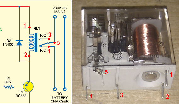

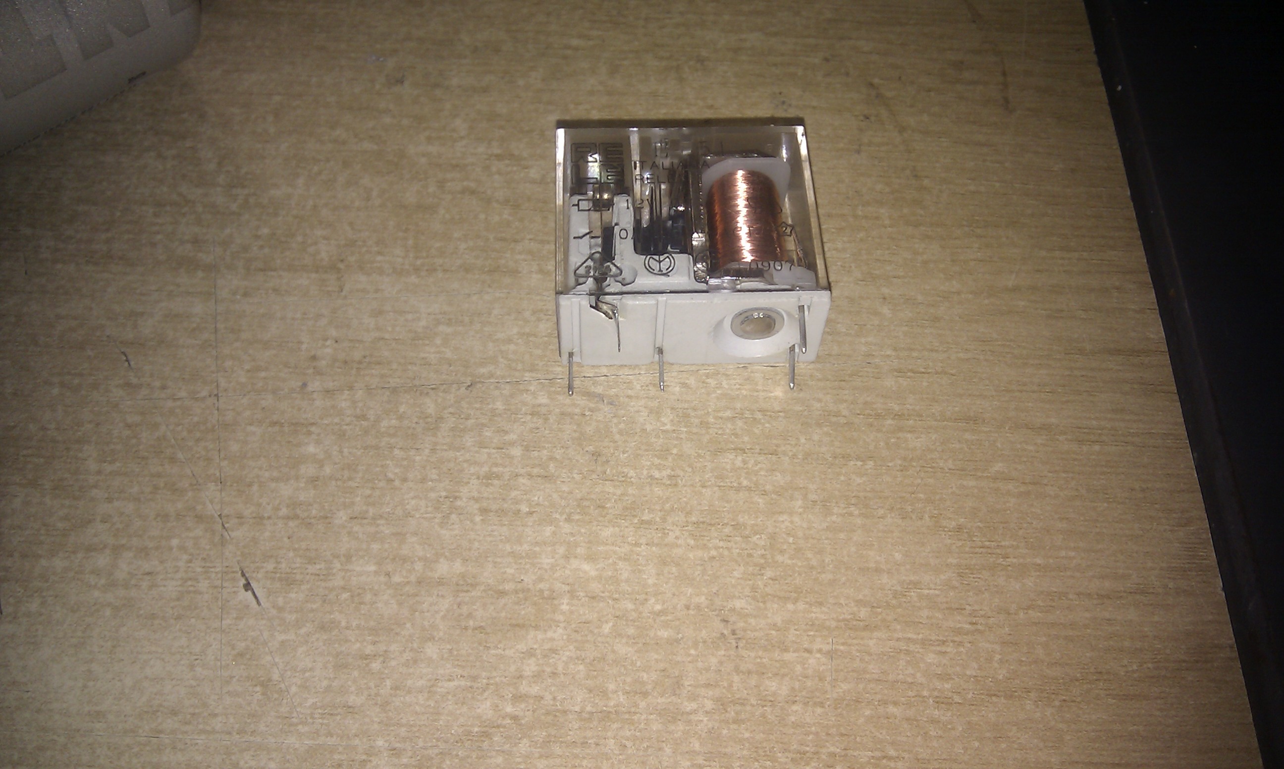

I need some help,I haven't used a relay before and would like to know if someone could help on how to connect the relay of the image i uploaded to the same configuration as the circuit it's being used in, i also uploaded the circuit diagram pdf document.I could not find the datasheet to help me figure it out.The name is ITALIANA RELE' 12Vdc 10A.

It looks like a SPST relay. Check out this link. The two pins on the right likely go to the coil and the two pins on the left to the contacts. I'm not sure if 12VDC 10A is the contact rating or if 12V is the coil voltage and 10A the contact rating. Probably the first one if I had to guess. If you're unsure about the coil voltage just start with a low voltage and gradually increase it until the relay closes. You should be able to hear it when that happens. As far as how to hook it up to your circuit. Look at the attached picture. That's what I'd try first.
EDIT: I didn't notice when I glanced at the picture the first time that there appears to be a third pin on the left side of the relay. If that is indeed a third pin then the relay is likely SPDT with one NC (normally closed) contact, one NO (normally open) contact, and one COM (common). If they are not marked, to find out which one is which you'll need a multimeter and a high enough voltage to actuate the relay. Take your multimeter with no voltage applied to the coil and of the 3 pins on the left, test for continuity between 2 pins at a time. When you find which pins have continuity, one of those pins is the NC pin and one is the COM pin. Next, apply a high enough voltage to the coil to actuate the relay and test for continuity again. Which ever pin had continuity when the coil was both powered and un-powered is the COM pin. The other is the NO pin. Lastly, you can unpower the relay.
I updated the pic to show what I'm talking about. I don't know if I identified the NC, NO, and COM pins correctly. The picture is just an example. You'll have to verify which pin is which through the method I described above.

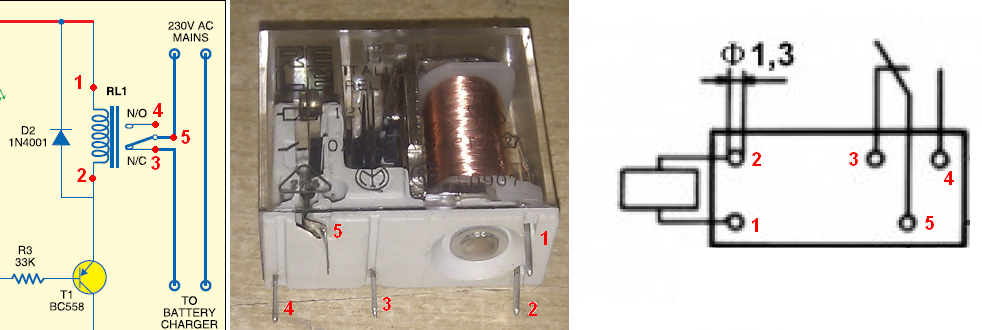

This data sheet may help Finding the company is easy and they can be found here so if you have the part number off the case it should turn up. I believe vne147 pretty much has it covered. You should be able to see the pinout through the plastic case.

thanks for the datasheet Ron....could you help me also on how to connect the pins according to the circuit i uploaded.
VNE,Ron helped with the datasheet of what the pins look like,could you please help what to connect where.I'm a student and know little about relays.thanks
If that is indeed the correct datasheet for the relay you've got then pin 3 is NC, pin 4 is NO and pin 5 is COM. I have updated the picture accordingly.

thanks vne,i have tested for continuity,there is continuity between 3 and 5 when the relay was not supplied with voltage.
In the drawing VNE provided the Hot or Live runs through the relay as drawn and the mains neutral is on the right. The relay is switching the mains hot or live. Does that make sense?
Ron
That confirms the picture is probably correct. 3 = NC, 4 = NO, and 5 = COM. To be 100% you can apply a voltage to the coil and verify continuity between pins 5 and 4.
