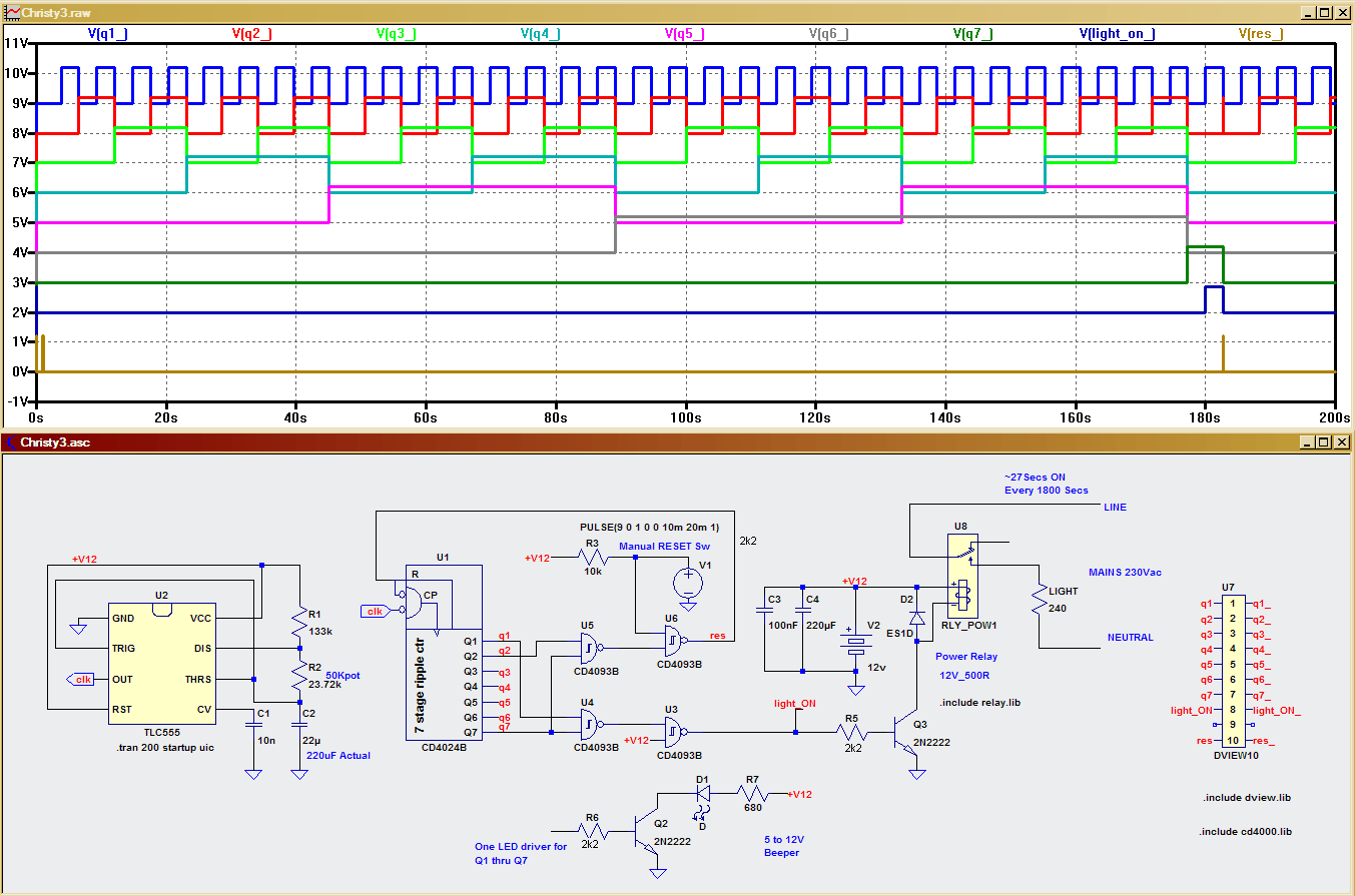

Look at this circuit showing the relay, note the circuit is powered from 12Vdc.
NOTE: I would recommend that you use a buzzer in place of the mains supply and lamp in order to test the project, BEFORE using mains and lamp.
BTW: I hope to be in Port Elizabeth, Jan thru Mar next year.

I'm not going to try to explain that circuit or the original one because in all honesty it would take me a little while to figure out what's going on there. I will however post a diagram of how the relay connection should have been made and how you can take the fan out of the circuit. At least now if you decide to try it you won't be dialing 911 or whatever the South African equivalent is.

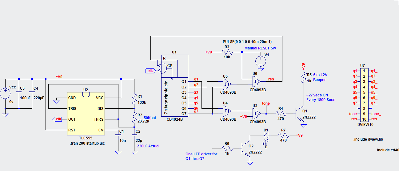

Hi Eric,
I finally understood your diagram.I'm not the worst noob at this.I noticed you used the CD 4024 instead of the CD4020.is it the same principle coz i already bought the CD4020,or should i just get the CD4024? plus if i would want to change the clock duration for the timer, what formula should i use for the 555 timer to achieve a certain duration? and which capacitor should i change ,C1 or C2 or both?
I think u wasted your time on that vne,coz i told them the same a few weeks back but no response from them.Thanks for the reconfigured relay connection...u saved my life!

The CD4020 doesn't have all the lower order outputs, so its not directly compatible with CD4024.
Note for the 1800Sec period, C2 = 220mF.
With R2 then 50K pot at max , the period will be 3600Sec.
If you half the value of C2 , say 100uF, you could set the period for 900sec.
I will post a link...done
Look at this link for a 555 calculator.
https://www.electro-tech-online.com/blogs/ericgibbs/125-simple-7555-cmos-timer-calculator-v1-2.html
wow,did u create that 555 calculator with VB?the 555 timer that u designed to help me,is it a monostable or astable configuration?seen astable to me.I would really like to know the formular on how to calculate the period because my lecturer would want to see how i went about calculating it. is it like T=0.7(R1+R2)C2 ? just to clarify is that buzzer at the bottom of the schematic u posted?which output pin of the cd4024 should i connect the driver to?
