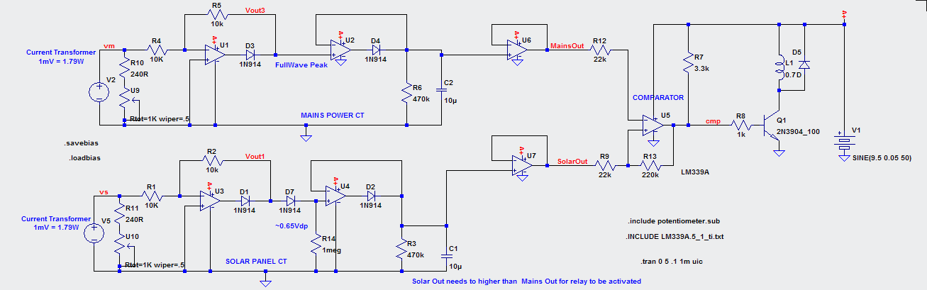

This is the full circuit, a LTSpice file and a screenshot.
I am still looking over you schematics and LTSim.
The relay is being operated at close to the minimum of 9V , actual 9.5V, the transistor base current is ~0.7mA and the relay coil current is ~36mA..
I cannot see a transistor type number.???
EDIT:
I suspect the reason you couldn't get the hysteresis to work is due to the lack of 10K input resistors to the final comparator, the 10uF caps would cause oscillation.
EDIT2:
What are the OPA types.?

The transistor is a BFY53 (that I bought 30 years ago and never got around to using!!)
The OP amps are **broken link removed**
Would the inclusion of 10K resistors on both the inputs to the comparator, effectively isolate the op amp functions from the comparator function and enable me to then include an element of hysteresis?
Apart from the relay problem, the circuit works very well, and has performed well aver the past month or so.
I have tried to introduce some hysteresis without success, as the input voltages into the comparator vary between 600mV and 3V , so the feedback voltage has little effect when the input is 3V but a overwhelming effect when 600mV.
I have had partial success, by linking a 10mf capacitor and 500k resistor in series between the output and input of the comparator, which when the comparator state changes, it provides a feedback pulse which provides hysteresis for a few seconds.
Not ideal....but..

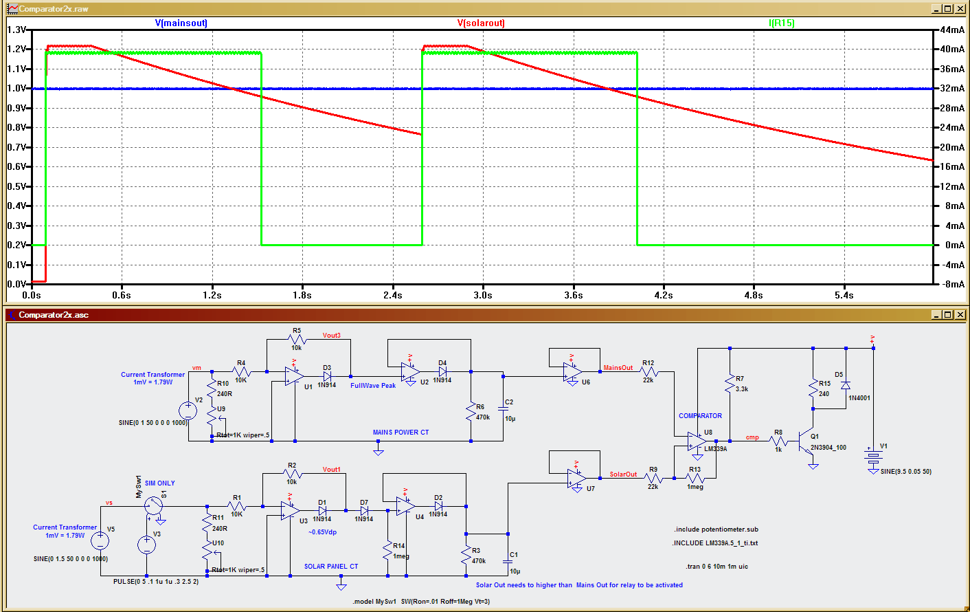

hi Rosso,
Like you I am looking at the LTS circuit, I can improve the hysteresis if I remove that diode/1000uF and connect to 0V.
I am trying to introduce that 0.7V offset at the solar OPA output, I will post later.
Look at this option.
Added buffers to isolate the 1meg/10uF from the FWrect outputs to the comparator., which now has hysteresis.
Removed the diode/1000uF to 0V from the mains opa's.
Added a diode/1meg between the two sections of the solar rectifier to give the 0.6V offset you were requiring.

I don't seem to be able to replicate the 0.6V offset, instead I get about 250mV?
I like the idea of using op amps to isolate both sections, and it makes the hysteresis work. Presumably by adjusting the feedback resistor value, I could fine tune how much hysteresis is applied (only need about 10 - 20mV).

I have posted the LTS asc I have be working with, for reference, you may have to insert your model for the LM339.??
I have added a voltage/controlled switch on the solar current meter, in order to try the solar levels.
Lets know how it goes.

Thanks Eric, yes, that works fine and moving the diode to create the 0.6V bias is a much neater solution than what I have.
The hysteresis also works well, just providing a little bias to ensure that the relay energises cleanly, without undermining the work of the comparators.
