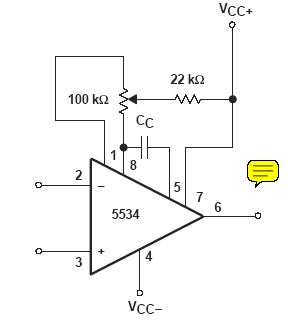

And, for the question is why the result from the real world different from the simulation. Currently, I experimenting an negative feedback OP-Amp using ne5534. I've follow the schematic and assign the Cc = 47pf, 22pF, 0pF (according to the datasheet). None of the configuration show the result of amplification (including the inverted signal).

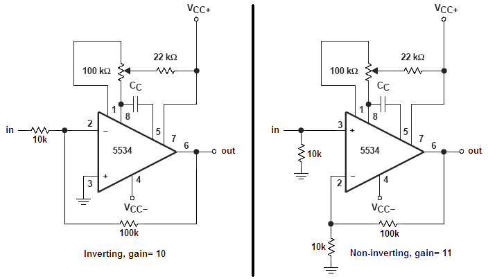

It looks like you forgot to add negative feedback and an input voltage reference.
I have do that.....just forgot to include....

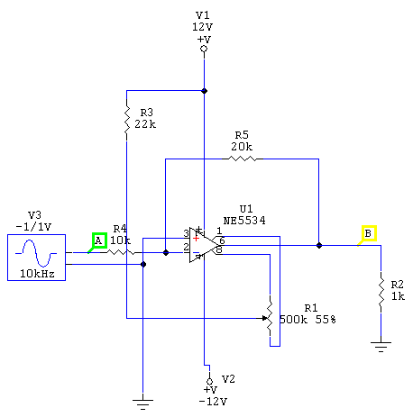

Your schematic has a gain of only 2. The NE5534 will oscillate without a compensation capacitor for a gain less than 3.
The value of your offset adjustment pot is 5 times too high.
What is your tested result and what is your simulated result?
The result of ne5534 from ti:
o/p = 72mV without invert signal
and the result of ne5534 from phillips:
o/p = 480mV without invert signal
Also, I have tested configuration of gain = 22(r4=1k,r5=22k) and the result quite same.
forgot to mention that I've also put the Cc with the value 47pf, 22pf and 0pf
Adjust the offset voltage pot. That's what it is there for.
Anyway...I've solved the problem. Looks like my ne5534 has burned. The result from the experiment as expected. Thanks for the help...... :oops: :wink:
