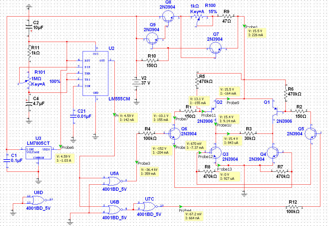

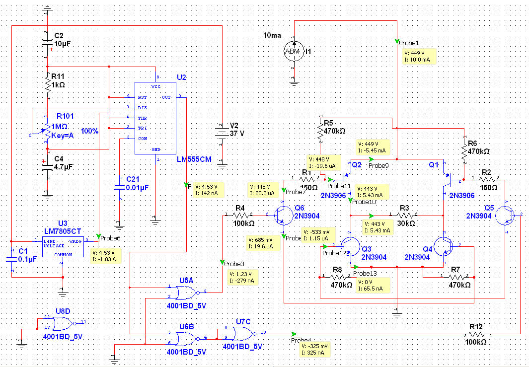

Ronv,
Thanks again for building and testing a schematic on your end making it available to me. I believe that I have recreated your work to the best of my ability and the Multisim's available parts...
Anyway I have spent 4 or 5 hours trying to get Multisim to run the simulation without throwing an error, but I can not seem to get it to run for more that 4 or 5 seconds without popping an error about "Timestep too small" It is my understanding that this is more of a catch-all message when the software is having a problem trying to nail down some type of an algorithm for a component. (i.e. It tries one algorithm that isn't quite right and then tries another and so on, etc... Eventually it times out...)
This is not to say that your design is not spot on, just that I have either made a mistake or the software is having a problem with a circuit that works in the real world...
Anyway I have attached to images of the few results that I was able to retrieve. The first is my representation of your design. The second is a test I did eliminating the Current Limiting circuitry and substituting a 10ma current source.
I am not sure I am interpreting the results correctly, but I am not sure why the source starts out @ 10ma yet appears to end with 5.43ma near R3...
Sorry to trouble you after you have already done the work, but I thought you may be able to see the error of my ways...
Regards,
BHinote
OK. I could not get the LM317 to act right for all the conditions, so here is the Fry's special.
Sorry, it is a bit more complicated but I think it will work for you.
Here are some things I noticed along the way.
The 10Ufd on the Con pin of the 555 should be a .01ufd.
You should have a 10 ufd. from 5 volts to ground at the 555.
I simulated with 4.7 Ufd. for the timing cap on the 555 and get 3 seconds or so with the pot at 50%. That would make your timing 300 seconds at 50%. I'm guessing this is what you want.
I didn't know what S2 Motor was so I tied the input of the NOR blocks to ground to make them active. Is S2 a timer or something?
I would make R8 220 ohms for the LED.
So here are the changes:
Replace the 317 with a current source.
Replace the base resistors with 150K,
Replace the transistors with Fry's available.
With this setup the single pot should get you from 1ma to about 12 or so.
I'm not sure I understand how this works since it would appear that it just plates from one electrode to the other and then back again. Does some of the silver stay in solution?
If so it won't take long for the resistance of the water to go down.

BH,
The 150 ohm resistors should be 150K.
LTSpice had trouble finding the operating point when I attached the IC's. Don't know what that was about either. I think it may work better with the 150K's.

Actually if your local Radio Shack has parts they should have the transistors, but they are quite expensive - then so is gas.
Crap... I tried to check and double check the components before I assembled the circuit, but it figures...
Anyway I changed R10, R1 and R2 to be 150K. The simulation is still throwing an error, but I am looking at the results now...
BH,
