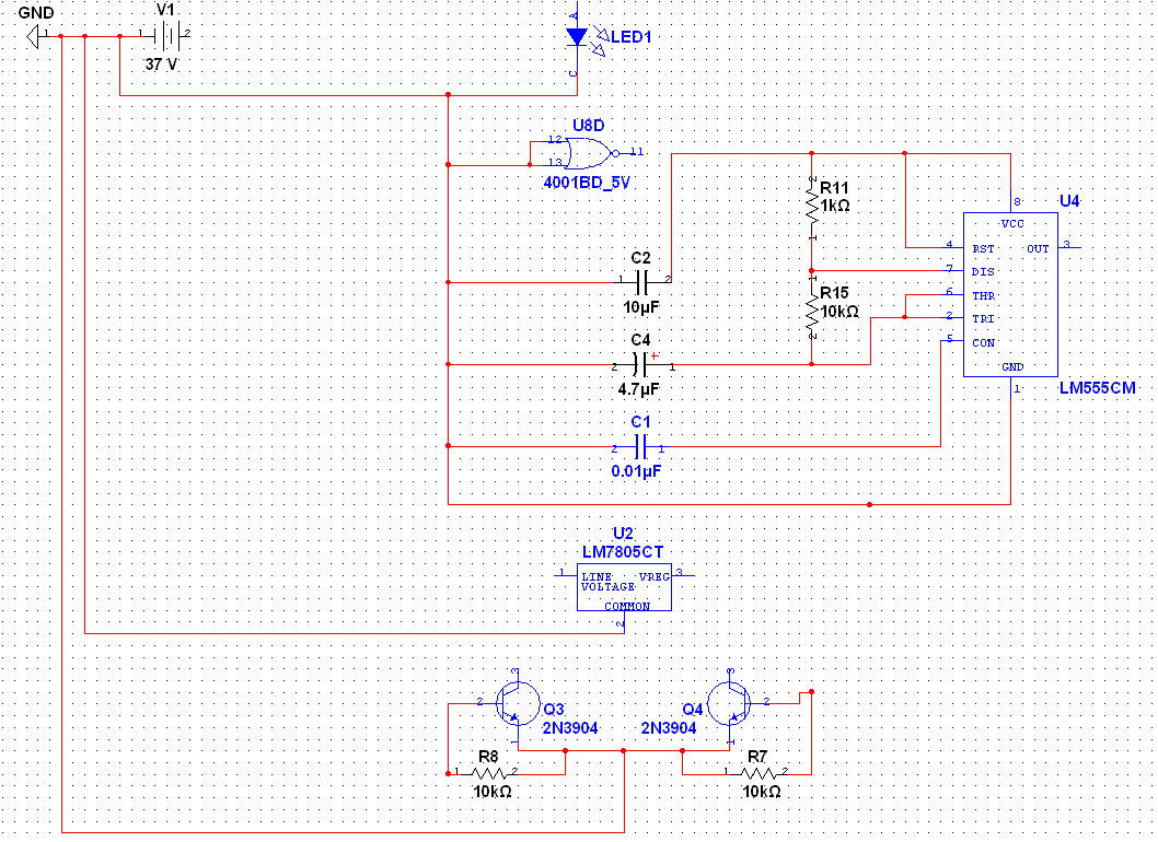

I have attached a crude example using grounds. The left being different than the right.
So when you say "separated until they are joined together at a single point" are you saying like the left side and not the right side OR are you saying something else..

I should have covered that a while back. It's a rough topic.
In general you need to keep high current grounds, noisy grounds, reference grounds separated until they are joined together at a single point.
While we are on this subject, bypass capacitors located near the power pins of an IC can keep that IC from oscillating. For the purposes of your circuit 0.1 uf metalized polyester should be fine.
The ground at the bottom of the bridge and the power supply grounds and the ground from the rest of the circuit should meet at one place.
There is a LOT involved in this topic.
I'll bet that with Multisim, it probably expects the power to have some designation such as Vcc and have it connected to a virtual power source.

What you drew is IDEAL, but not practical. Daisy chaining will be fine for all but:
1. Ground of the regulators
2. Ground of the bottom of the H-bridge
3. The daisy chain of all of the other parts.
You can think of 1, 2 and 3 meeting at the power supply ground.
Make sense?
BH, The grounds were just a simulation problem in this case, same with the Vdd (no +5 for the 4002).
In real life there a sometimes several "types" of grounds - Power, digital, analog. You like to keep the switching noise from the digital separate from low level analog signals and the same with high power "stuff" like motors or heaters that can create a voltage drop due to high current. You then bring them together at a common point close to the power supply like your picture.

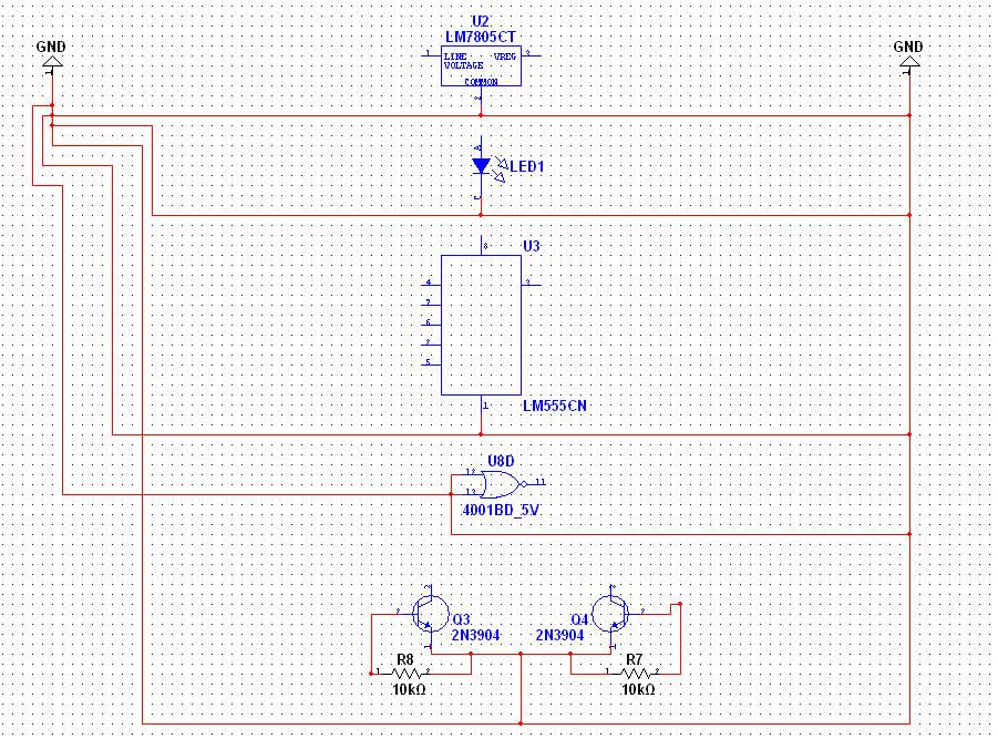

Grounds
I understand what KISS is saying as it pertains to the items in the example, which I believe I have reflected in my new example attached.
Where I am not up to speed is recognizing what exactly is considered "Digital".
I am pretty sure I understand the difference between Switches, High power supplys, Motors and Heaters, as Ronv has indicated. However I will probably still mess it up. :D.

I gave you all you need to worry about.
1. The bottom of the H bridge
2. The regulator grounds
3. The power supply ground
4. All of the other ones (555, gates, etc.)
These should all be separate paths to a SINGLE point.
There is a lot to keep in mind when you are worrying about noise. Maybe more important is power supply decoupling. In the case of your circuit the 555 draws high current when it switches. That is the purpose of the 10 Ufd. cap across it. The cap will supply the power for the short time the current is high. The H bridge has the same problem. When it changes state there is a short time that the 2 transistors on the same side are on at the same time. In this case you can't put a cap there because it would screw up the current source. But the current source tries not to let the current change, but alas, it is not super fast. The best you could do in this case is a cap from the collector of Q8 to the H Bridge ground. Then the battery (power supply) is the common point ground, so a cap here will eliminat probles caused by a long wire to the power supply. The 4001 switches fairly fast so a small capacitor from 5 volts to ground would be good. Last the control input on the 555 has fairly high impedance so is susceptible to noise, thus the small cap there. Often you can find recommendations in the data-sheets.
Having said all this, this circuit would probably work without any of these-just good practice.
