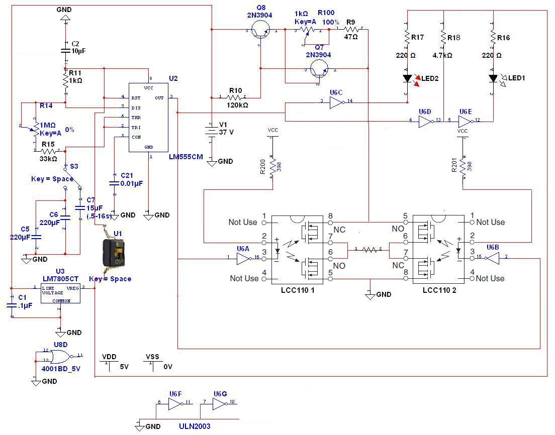

No resistor changes, but we should change the 2N3904 to BC547 and the 2N3906 to BC557. Make sure you look at the picture to get the thru hole part and not surface mount, cause they are really tiny.
Your 99% there.
You need a single resistor from the junction of U6d(13) and U6e(5) to +5. Make it 4.7K for now.
The ULN2003
1. Will not have a + power pin
2. COM will be unconnnected
3. GND will be connected
4. Is not sensitive to unconnected inputs
One section of the ULN2003 and 1 resistor COULD be eliminated. The resistors reflect this.
I'll verify the resistor values. Do you have an LED part number/datasheet?
If you want to PM me your e-mail I'll try to make you a bill of material for Mouser. They have a nice system you can click on the part and get the data sheet and you can one click the order. I'm pretty sure I can get it done before time to order on Monday, I know you are against a deadline on your simulator.

KISS,
I have added the Resister to the design you were mentioning, see attached, however I am not sure what your statement means. (i.e. One section of the ULN2003 and 1 resistor COULD be eliminated. The resistors reflect this.)

Guys, I don't think you need all the inverters to drive the leds. The 555 can drive them all.
Ronv,
This is patterned after your design. How does it look?
BHinote

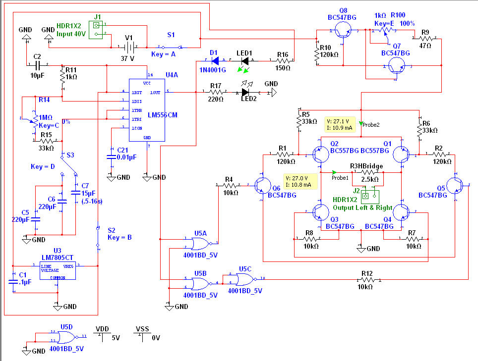

I don't think you need D1. When you take it out R16 should be another 220 ohm.
I worry about S2 as the rest of the circuit will still be powered. What was your intent for it?
My comment about the inverters related to the SSR design. I think this will also work and is easier to build, but I can't model it.

You guys know better than I do, so I can remove D1. KISS had indicated that LEDs should not really have positive voltage going the wrong way, even though 5V was probably not going to do any harm. So I thought I would add it as extra protection...
MY idea for S2 was to stop the timer so only one side of the H-Bridge would be active and the LED would still be on. Is there a better way to do this?
I can not model specific components of the SSR design either, specifically the LCC110's, but it makes sense so I though I would buy those components too.

Make R200, R201 closer to 270 ohms, not 390 ohms. ronv's right, the inverters can go if you check the resistor calcs again.
I fell asleep and didn't get to go over thing with a fine tooth comb.
But just a reminder for LED driving (sourcing and sinking).
You have a term Vce(sat) usually from 0.2 to 0.8 volts
You have a supply voltage: 5V or slightly less than 5V (The 555 won't go to 5V, nor 0 volts) It will get close. You would use these numbers if directly driving LEDs from the output of the 555.
You have a LED voltage drop, called Vf. It's 1.2 V for the LCC110. Could be 2.1 or higher for other LEDs.
There is a min/max/typical drive current for LED's. 20 mA typical, 50-70 mA maximum. The LCC110 has a 8 mA typical. Would probably drive at 15-20 mA.
There is Vbr or V(reverse breakdown) for the LED and all diodes. The mechanism is usually non-destructive. Depends on design.
There is resistor power rating: (I^2)*R; 1/2 W should suffice
LEDs age, output does diminish over time. There is lots of variation.
Basic formula is (5-Vce-Vf)/I for that series resistor.

I think for the most part your set. I'll continue to look at it. Migraine, recovery and catch-up takes a while. The main trigger is weather changes. Crief comments are:
These are mostly questions.
1. Need a small cap on the output side of the 5V regulator (0.1 uf) should be fine.
2. I'm still confused about the manual mode of plating polarity (S1)
3. Reverse polarity protection? A fuse/ and reverse biased diode across the 37 V input is one such way.
4. Misc parts. (assuming breadboard)
5. Connectors to bring switches, pots outside of the board?
6. Breadboard choice, if your going that route?
7. In the SSR version, rather not try to eliminate the inverter/drivers.

Plating mode select switch suggestion
I may have a better way to force the direction. Threshold and trigger are tied together, so locate this point, call it C.
Take an SPDT ON-OFF-ON switch and tie the center terminal to C. Tie an outer terminal to Vcc and tie the other outer terminal to ground.
So, the switch would be labeled, FWD, Normal, and REV.
The LEDs should not be reverse biased more than 5 volts, but since there is 5 volts on the other side of the LED it is not reverse biased at all.
If you remove the reset pin from +5 and add a resistor (10K) from reset to +5 instead, you could then use the switch to ground the reset pin and stop the timer.
Yes this will work beter.
