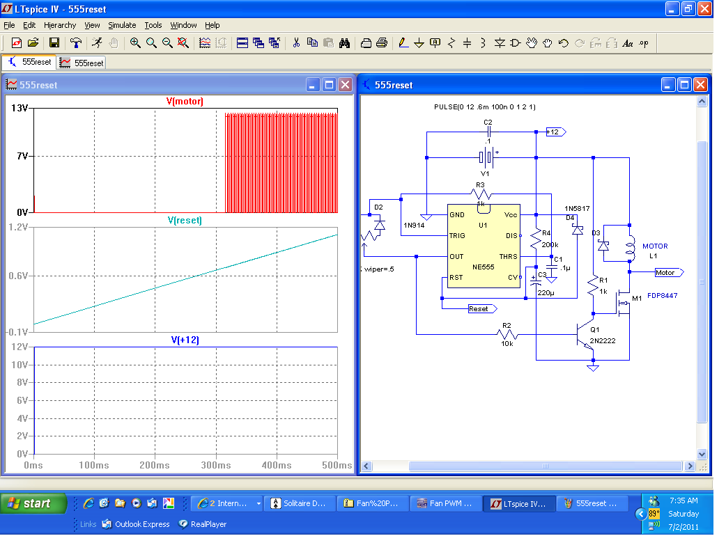

Sorry, I'm to old to wait for that simulation to finish.:)
So I ran it in Spice. The only thing I see is that the 10K on the base of the 2N2222 should be between the base and the output of the 555.
Remove the cap on pin 5 and use the 220 Ufd as the power on reset cap (In place of the 47Ufd.) It simulates a ok now. I'm not sure of the condition of the 2N2222, but probably ok.

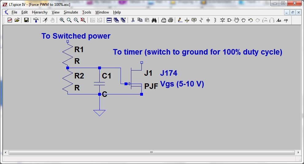

Here is my suggestion for a "force PWM to 100%"
Unfortunately, haven't learned to simulate things yet. The R1/R2 divider must be greater than Vgs.
It is possible to use lower values for R1/R2 and a high series resistor to the capacitor as well.
The idea is that when power is off, the cap will discharge through J1. A small series resistor to limit the current to about 100 mA could be usefull 12/0.1 or 120 ohms.
When power is first applied,J1 will be shorted (and shorting a pin on the 555) moves it to 100 duty cycle.
R1 charges C1 until it exceeds Vgs, then the JFET opens. The "to power" should be after the power is switched to turn on the motor.

I couldn't get it to switch clean. Did you mean to use a JFET transistor?
Yep, a P channel JFET, p/n J174 https://www.electro-tech-online.com/custompdfs/2011/07/J174.pdf
For the power pin use a triangle source. (0 to 12 and back down to 0). A ramp would even be better
At the Top of the JFET, use a LED and resistor to ground. It can sink 100 mA when Vgs is 0V and it woul d have an 85 ohm resistance. Probably could add about 22 ohms in series with the + of the cap.
Try 100K for the top resisr to +12
1 Meg for the resistor across the cap
Make the cap 100 uf.
