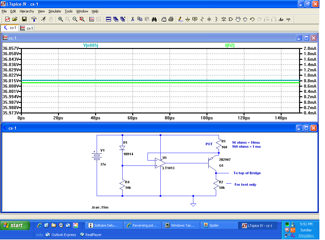

Put your current meter in series with the resistor. Measure the voltage across the current meter. Do a R = V/I thingy and get the resistance for that range.
Usually it's below 0.6V at full scale.
I'm not sure where you are measuring the current, but a few 100 micro amps flow thru the bias resistors from base to emitter of the top transistors. This is a higher percentage at the low current/high voltage. The current source is not very linear at the low end.
It is just the current source being non linear at the very low currents. Try setting the pot for say 1.3 ma and see if the voltage doesn't pop up with say the 50K resistor.
Sorry, it's just to confirm that there is not a problem. I was referring to your experiment with all the resistors along with the current and voltage. So you could set the current to 1.4 ma @ 2.5k load then repeat the same experiment to see if it is not more linear at slightly higher current.
How does this work in real operation? How do you set the current and when and why do you set it high or low? I would think the resistance of the solution would drop fairly quickly as the silver goes into solution. Have you tried it?
Better current source
Here is a circuit that will run with only about a volt of drop. You might be able to find a current source chip but the ones I found only went to 40 volts at 10 ma. If I remember correctly your voltage was right at 40 volts with no load.

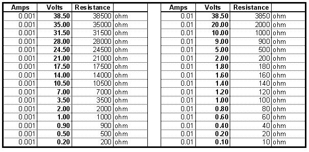

KISS based on this it sounds like every volt counts.
Well, not exactly, Although, I would recommend to start with a close electrode spacing.
Two things are competing: R = V/I or 40/1 mA
and probably something like 18 M ohms or from I = V/R; I = 40/18E6
At the high R values, voltage measurements are going to be impacted by most DMM's. High value of resistors will kill the ability to measure the current.
I've done a lot of stuff measuring currents on the order of a few tenths of a PA. Wierd stuff happens there. The triboelectric effect, the piezoelectric effect, leakage, feedbackammeters, electrometer amplifiers etc.
Intuitively I agree, but B says it goes fast at 40 volts and slow at 36. Maybe it's chemistry.;)
