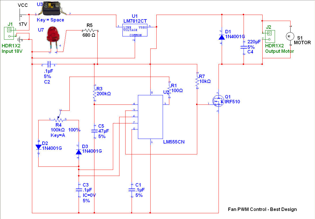

Waiting for Parts / PWM Verification
I am still waiting for parts and my simulator expires in 2 days.
So I thought I would post my PWM design, just in case someone noticed a blaring issue I did not consider. (It is currently functioning on a bread board, but that does not allways mean that it is correct.)
Anyway, I again want to thank both KeepITSimpleStupid and Ronv for all their time, efforts and commitment to making my circuit the best it could be...

I would tie the reset pin directly to pin 8 and remove the 220 Ufd. across the motor. If you are worried about motor noise add a .01 Ufd. across the motor at the motor terminals. R7 is not needed as the 555 drives both high and low. How much current does the motor take?

Thanks for the quick reply...
I tested a couple of your sugestions and received the following results:
1. Change C4 from 220uF to .01uF. Result: 220uf=(240hz - 270hz) ; .01uF=(116hz - 260hz)
2. Connect Rese to pin 8 and remove R7. (Timer never started. Please see my thoughts below)
Thoughts: Based on my understanding, I designed about a 2 Second delay in the timer so that it would initially start with close to 12V and then adjust once the time started junctioning. With that all said, when I changed Reset to pin 8 and/or removed R7 from the circuit I beleive R3 and C5 do not allow pin 4 & 8 to build enought voltage.
What are your thoughts?
Cost Reduction
:DI guess a picture is worth a thousand words.:) Pin 8 and 4 would still go to +12. R3 could go away. The reset is a neat idea, but the turn off is much less graceful than the turn on. But it certainly doesn't hurt anything.

I did not see one part of your reply, about the current of the motor.
I believe that it takes 0.12A.
After reviewing my delay circuit, I discovered that it was not actually providing 12V non-pulsed. It appears that the timer was not doing anything.
I believe that i need to build something to hold pin 2 (Trigger) to ground for about 2 seconds to cause the output to go high for 2 seconds. (i.e. Start the motor with full power and then drop back to whatever the Potentiometer was lasts set at.

You know you are Right...
Ronv,
If I am slightly qualified enough to say this, "I agree". ;)
I just posted something similar when this one came through...
I have removed R3 & C5 and I connected Pin 4 to Pin 8. (This all works well...)
So now my only issue is how to make the timer output High for 2 seconds and them go into the regular pulse.
I am experimenting with a NTE123ap or 2n2222 transistor and the R3 / C5 idea, but this is not working at this time. (Back to searching the internet...)
Concur with 220 uf being way to big. A 0.1 uF ceramic cap for brush noise suppression. The frequency you'll have to play with. The beauty of PWM means the torque is constant. but the motor has to be able to respond. 0.001 Hz is too slow and 1 MHz is too fast. Motor may "sing" at audio frequencies.
MATH: Never use .1. ALWAYS use 0.1. i.e. Always use the 0. when the decimal is less than 1.

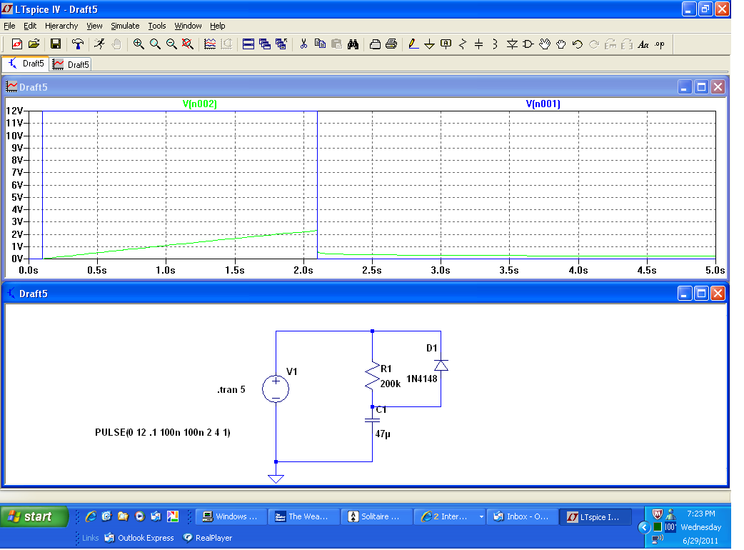

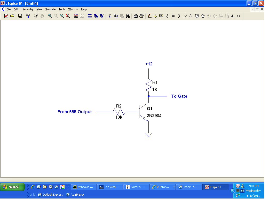

Reset
The 555 is reset with a low on the output - you need a high to turn on the FET. So we could invert the output with a circuit like this. We could also change to a PFET, but good one can be hard to find.
Reset
You might want to add a diode (the 4001 is ok) to "reset" the reset circuit. Otherwise it will take a long time for it to get into reset mode again after power has been on. Also note the reset line switches at 0.4 volts:p so you only have about 0.5 seconds:rolleyes: with full power. If the little motor doesn't start in 1/2 second it probably won't run there anyway. One of the nice things about PWM is that you get pretty much full torque throughout the speed range.
Did you add the inverter transistor?
Yes, but for some reason the motor just did not start for 2 seconds and then it turned on at normal speed.
When I tested it in the Simulator all appeared to work as expected, however so did my original delay Resistor and Capacitor idea... When I put it to the bread/project board is when it does not work as expected. Another thing is that when I applied the "inverter Transistor" it changed the direction of the potentiometer. (i.e. Originally Turn Left for slower and Right for Faster; Now Left for Faster and Right for Slower.) This really does not matter, but I thought I would point it out.
I found a 4n25 Optocoupler / Phototransistor with Base connection on a old alarm circuit board I have. I am checking to see if I can use this to connect Trigger to Ground and then open the circuit. Do you see any reason why this will or won’t work?
Best Regards,
BHinote
Interesting. That circuit doesn't like to start. Do you need the pulse to the motor? Will it not start on the lower speed settings? If so I'll look some more tomorrow.
