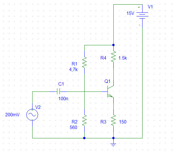

Hello,
I'm getting some concepts confused.
I'm building a 2 stage BJT amplifier, common emitter and emitter follower.
The behaivour of the circuit is quite accurate, as I measured values very near the ones I calculated on paper. The problem is the cutting frequency of the AC coupling capacitor at the input of first stage.
I use a 50 ohm signal generator, with a 1Mohm BNC scope probe to inject the AC component, trough a 100 nF capacitor. The stage input impedance is around 500 ohms.
The cutting frequency should be around 3 kHz, but the -3dB point, compared to max value attained at high frequency, is reached at 1.5KHz. It seems that the signal generator is not showing 50 ohm, but around 400 ohm, which forms a voltage divider with the input impedance (~500ohm) of the circuit.
Why? I tried to source a simple RC with a higher 2,2kohm and same 100 nF capacitor, and it corroborates it. The source is aorund 400 ohm output impedance, according to the voltage divider it makes.
Back to the bjt amplifier, at 3kHz, the theorical cutting frequency, the AC voltage in the base is -3dB the one present in the signal generator output (at the tip of the probe, to be exact). But NOT -3dB of the max value at higher frequencies, because the voltage on the tip of the generator's probe raises at frequencies near the cutting frequency, obviosly, because the capacitor impedance raises. So, the cutting frequency is the point at which the input is -3dB from the current voltage on the generator, but NOT -3dB from the maximun voltage at high frequencies. How can this be handled?
Thank you

If it helps, I calculate the input impedance of the amplifier to be 553 ohms and the -3db frequency to be 2.879khz. You may want to try a resistor in series with the hot lead of the generator around 500 ohms.
If you're using a standard scope attenuator probe to connect the 50-ohm generator output to the 500 ohm input of an amplifier, I wouldn't expect you get get hardly any signal into the amp at all. If the generator is feeding the probe 10v, you should only be getting 555µv into the amp input. A scope probe, even a 1X non-attenuating probe, should never be used to inject the signal from an generator into an amp. Even a 1X probe may have several hundred ohms resistance from probe tip to BNC center conductor.

yes... I'm using a 1X 1Mohm scope probe. It exhibits around 400 ohms, yes. So, this is normal?

First and foremost a 50 Ohm output of a signal generator MUST have a 50 Ohm load connected in order to operate IAW specifications. Check your owners manual.

Instead of a scope probe for injection, try a cable with appropriate sig gen connector on one end, and pig tails on the other side. This may require soldering to your board under test.
I know about impedance matching, L networks, transmission lines... but working in audio frequencies... I usually forget about microwave and reflexions, and try to drive an impedance with a lower output impedance driver, so voltage is mostly droped in the load.
What kind of probe should I use to avoid getting around 400 ohm instead of 50 ohm output from the generator? a 50 ohm coax cable with a BNC connector, and some kind of tip in the other end?
Just a piece of cable from the generator to your input - an obvious choice is 50 ohm coax as it will fit in a BNC plug properly.
A scope probe is for the input to a scope (and perhaps a frequency counter), not for anything else.

Thank you! Now it is clear. I'll get a coax cable and BNC connector, and try again.
I wander why, though, the scope probe exibits ~400 ohms when used with the generator, and 1 MOhm when used in a scope
It doesn't, I can't say I've ever measured a scope probe (it's not something there would ever be any need to know), but it's the impedance of the SCOPE that's 1MOhm - nothing to do with the probe.
