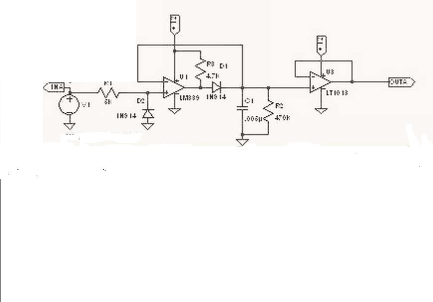

Here is an attachment of the circuit blown up, hope it works. Open it in 'PAINT'

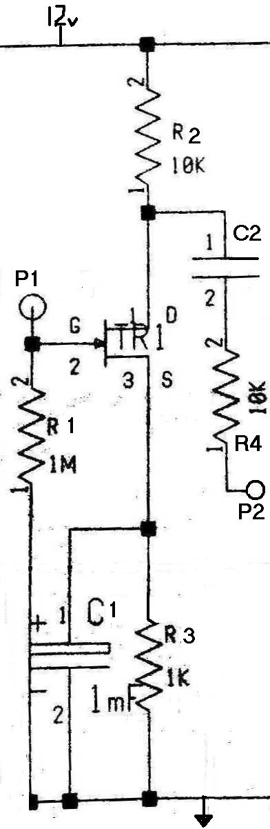

I have your circuit plus the attached 2n3819 pre amp. This is not connected to your circuit yet.
At the COIL the low voltage is 10mV. This, fed into your circuit did give a small voltage 0.05V. At the 2n3819 out the voltage is 40mV, so it has amplified 4X.
I am fairly sure I need to add this pre-amp. I tried connecting the pre-amp to your circuit but something isn't right.
Perhaps if I knew how to join the 2 together (coupling capacitors???), this might work.

The new opamp circuit has a voltage gain of ONE (it has no amplification). Your Jfet circuit has A LOT OF VOLTAGE GAIN (lots of amplification).
Adding 2 resistors to an opamp increases its voltage gain to any amount you want, then you don't need the Jfet circuit.
But the schematic of the new opamp circuit was saved as a fuzzy JPG file type so I can't read the part number of the first opamp.

The LM339 is a comparator that does not have a frequency compensation capacitor like all opamps have so it should not be used as an opamp with negative feedback because it will oscillate.
There is an application for it as a very low frequency opamp circuit.

Ronv is using the LM339 comparator as an opamp in a "precision rectifier" circuit that has no voltage gain.
An opamp is supposed to be used, not a comparator.
Since it has a voltage gain of one, if the input signal has a peak of 50mV then if it works the output will have a DC peak of only 50mV.
The output opamp also has a gain of one so its output will also have a peak of only 50mV.
If the input has a peak of 5V then the output will have a peak of 5VDC.

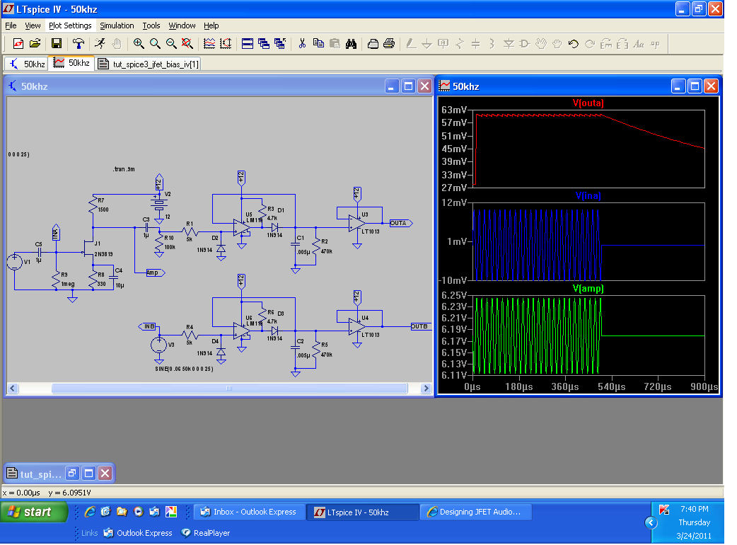

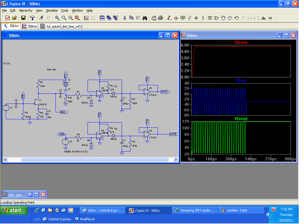

Here is a gain stage using your fet. Notice how it clips with higher input? If you can adjust this out I think you will be okay. It may be sensitive to noise so keep the leads short to your coils.

Hi Ronv and Audioguru,
This seems to work on the first test. As you say i will need to tweak it a bit to stop the sign wave banging it's head, so I'll play for a while.

I've been 'playing' with the 2N3819 Fet, and it's S and D resistors. I can get App 50X from it, Does this sound correct? It seems sensitive and 'sees' 10mV and less, in fact I think it was picking up my radio!!
Next job to connect it to the rest of the circuit (A/D input on 16F819)
It certainly has plenty of range, Near 0V to about 9V, then it clips, but this is ok.
I think it will be fine without dividing LT1013 output voltage in 1/2, to give 5V, as long as the A/D will not damage with over voltage, while I lower the WIRE signal to give max 5V. If the A/D will damage, then perhaps I could clamp it at 5V, is this possible?

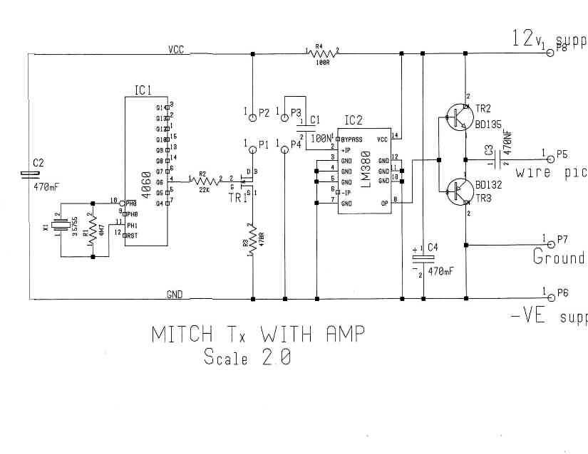

So far I have carried out tests with a short test WIRE, setting the signal using a home made COIL/Meter. Over the year or
so I have made different signal generators:
1/ Frequency timed approximately by a 555, and a few parts, no amplification.
2/ The last one is Crystal controlled, and has 2X power Transistors for output amplification. This needs to be turned
down for shorter wires or it gets hot, and it is uneccessary.
Today I carried out a tests on the longest WIRE, and they were dissapointing, and not strong enough to work. So I think
I ought to make sure the Signals into the WIRE are good before proceeding. I don't have a schematic for the 555 circuit,
but it's about as simple as you can design. Here is the Schematic for the XTL controlled circuit.
I built the XTL circuit because the 555 one wasn't strong enough for longer WIREs. Todays test showed that there wasn't
much difference in the signals between both Signal WIRE circuits (with the XTL circuit full on). I had to place the COIL
on the WIRE to get anything. I have made note of the readings from COIL to output along the Amp circuit, and there are
some odd readings, i,e, high COIL input low Amp output.
Bear in mind my test equipment is not brilliant, me also!!
Any ideas, to test and maybe improve these WIRE signal circuits?
