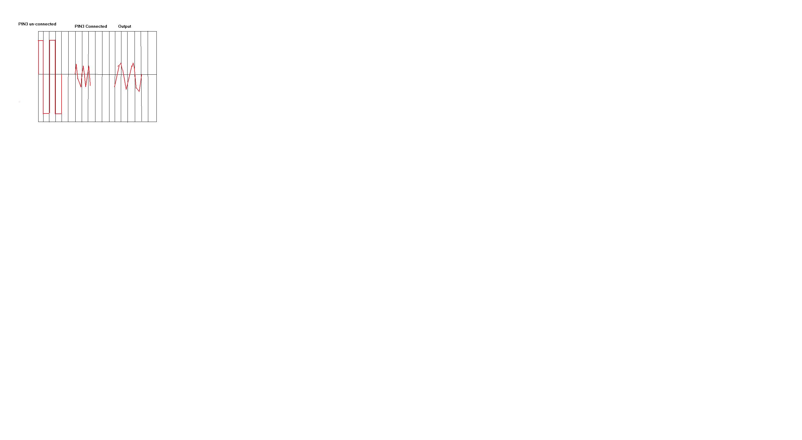

With no WIRE connected.
At PIN3 on 555 (disconnected from rest of the circuit). Nice square wave. Both FETS cool.
At PIN3 on 555 (Connected to the rest of the circuit). Distorted and small wave, PFET too hot to touch. NFET cool. Output Wave similar to PIN3.

Sure nice you have a scope. Let's try this so we don't burn things up.
Lets disconnect the 2 drains from each other and add a resistor ( 1K ) between them instead. That should limit the current.
It sounds like one of two things:
Either the N Channel is always on or
One of the speed up diodes is backwards. The way it is designed the FETs should turn on slow (thru the gate resistors) and turn off fast (Thru the diodes across the gate resistors). If that doesn't happen the current will be very high during switching.

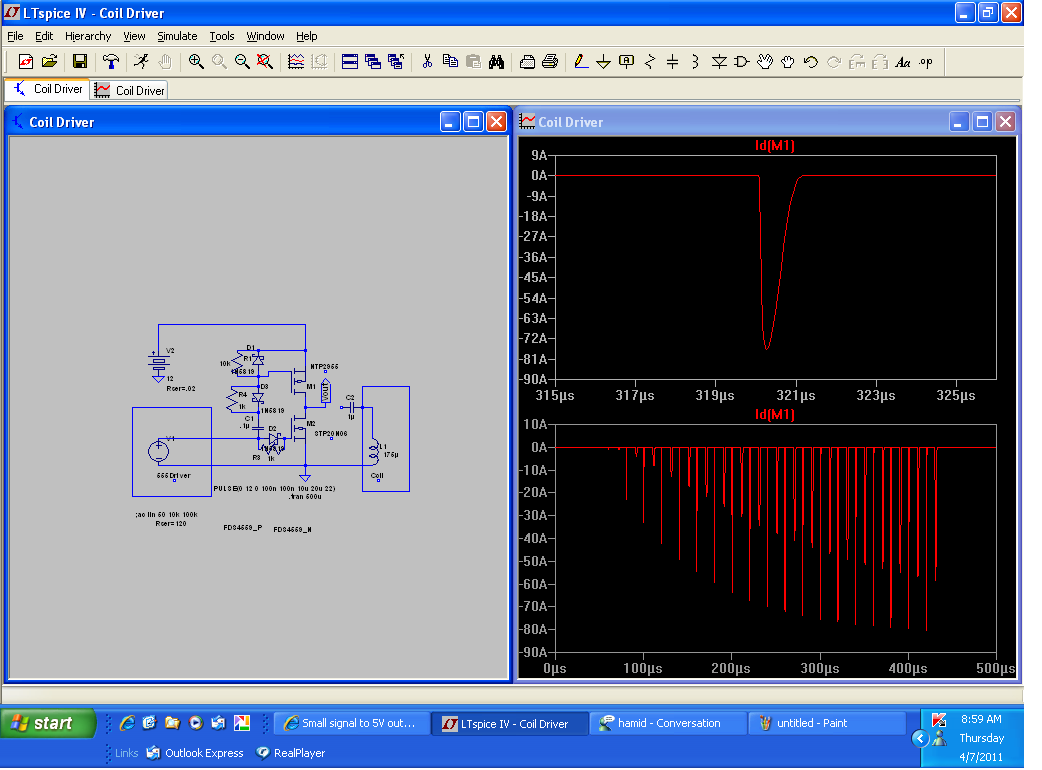

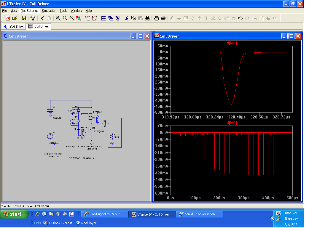

There will be a small current while one FET is turning off and the other is turning on. (first picture ~450ma)
I am also wondering about the Diodes.
If they are in backwards that would cause the problem you describe. Since the P Channel has the highest resistance it would get the hottest. (see 2nd picture for the very high current)

I see on the second picture you have turned the middle Diode around, is this the now correct way? I'll try it anyway, so watch out for smoke!!
NOoooooo. Hope you added the 1K first. That was just to show the the "shoot thru" current went up to 80 amps.
Ah, so that's why it got hot.
At one time I took the FETs out and there was a square wave at both Gates, but not with them in.
The diodes should be as in the original schematic. The resistor will just keep things cool.

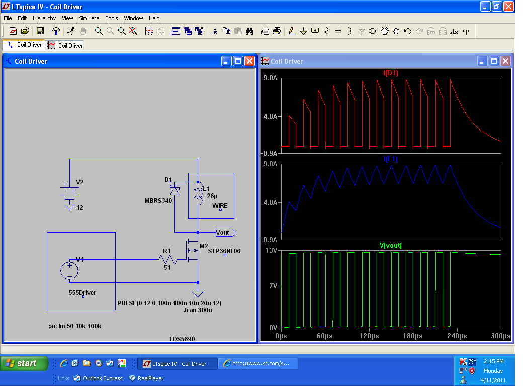

I like your idea, but it has 2 problems:
The current thru the short wire will be to high.
The current thru the clamp diode (D1 in the circuit below) is to high.
If you can make the short wire twice as long it would work!
I would use the N Channel FET, it is better (higher current rating)
The problem with the other circuit I gave you is I used the values for the N Channel FET I gave you instead of the one you had which is slower to turn off.

I can just use this Amp for the long WIRE, and for most other WIREs I can use my less strong Amps.

I have been playing with the circuit + long WIRE, including only the PFET plus its Resistors and Diodes, but without the NFET +R+Ds. The PFET stayed cool, and there still wasn't enough signal. Do you think it was because of the PFET and Diode being not strong enough?
It's hard to say without seeing the circuit.
I used the PFET in the belief that the WIRE would be connected to 0V instead of 12V, and be safer, but now I don't think it matters.
It doesn't matter, but if you use the NFET circuit and need more power it will be easier to modify.
Can you choose a different Diode as the one on the PNG is surface mount.
I think a SB540, 50 or 60 is fairly common.
So does the FET current and Diode current change the WIRE signal strength? or is it the resistance of the WIRE that draws the Current, which makes the signal stronger?
The FET and Diode just need to be capable of driving the maximum current which is determined by the resistance and inductance of the wire. We can increase the current by raising the voltage if we need to.
It's your circuit #75 minus M2,R3,C1,D2.
