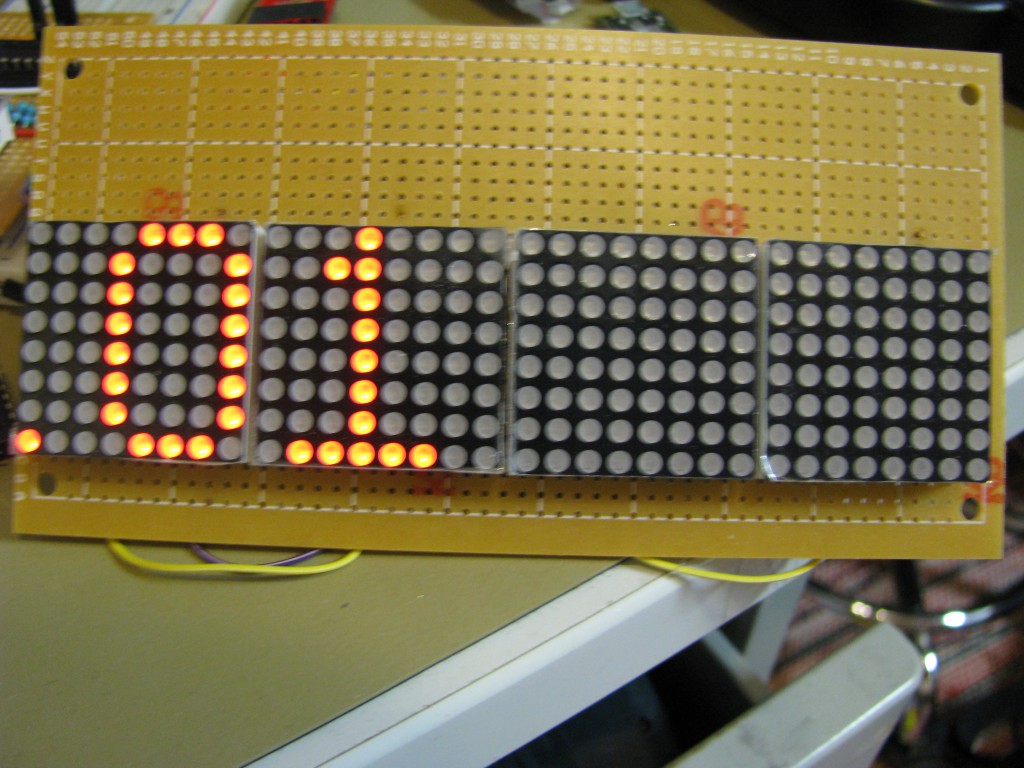

Yes, every single led is lit, not even flicker seen, tested with that new loop() you gave.

Sorry, still all lit up :/
lets take step back.. two paragraphs to change this time:
ISR (TIMER1_COMPA_vect){
if(TIFR1) // Make sure its the timer interrupt.
setcolumn(displayPointer);
setdata(buffer1[displayPointer]);
digitalWrite(latchPin ,HIGH);digitalWrite(latchPin , LOW ); // STORECLOCK
if(++displayPointer==32) { displayPointer = 0; } // 32 LED row sections in total
TIFR1 = 0; // Clear timer 2 interrupt flag
void setup() //setup runs once
noInterrupts(); // disable all interrupts during setup
DDRD = DDRD | B11111100; //port registers used to set pin directions
TCCR1A = 0;
TCCR1B = 0;
TCNT1 = 0;
OCR1A = 31250; // compare match register 16MHz/256/2Hz
TCCR1B |= (1 << WGM12); // CTC mode, free-running, clear on match
TCCR1B |= (1 << CS12); // 256 prescaler
TIMSK1 |= (1 << OCIE1A); // enable timer compare interrupt
interrupts(); // enable all interrupts
} // End main

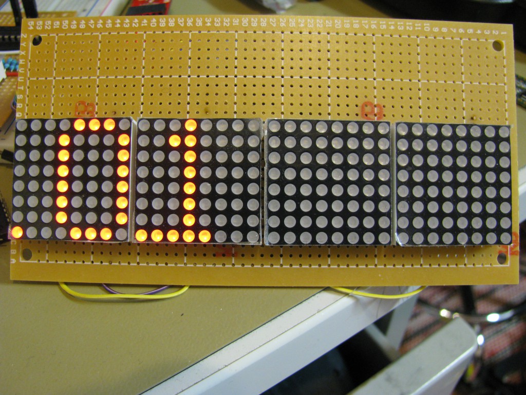

With that there is more living on matrix, quite random sequence, I'll post a shot in a few.
strange, didn't effect anything, even thought that should effect speed quite much?
oops, nvm!there came something now to screen, made typo in code, will post a pic in a few!

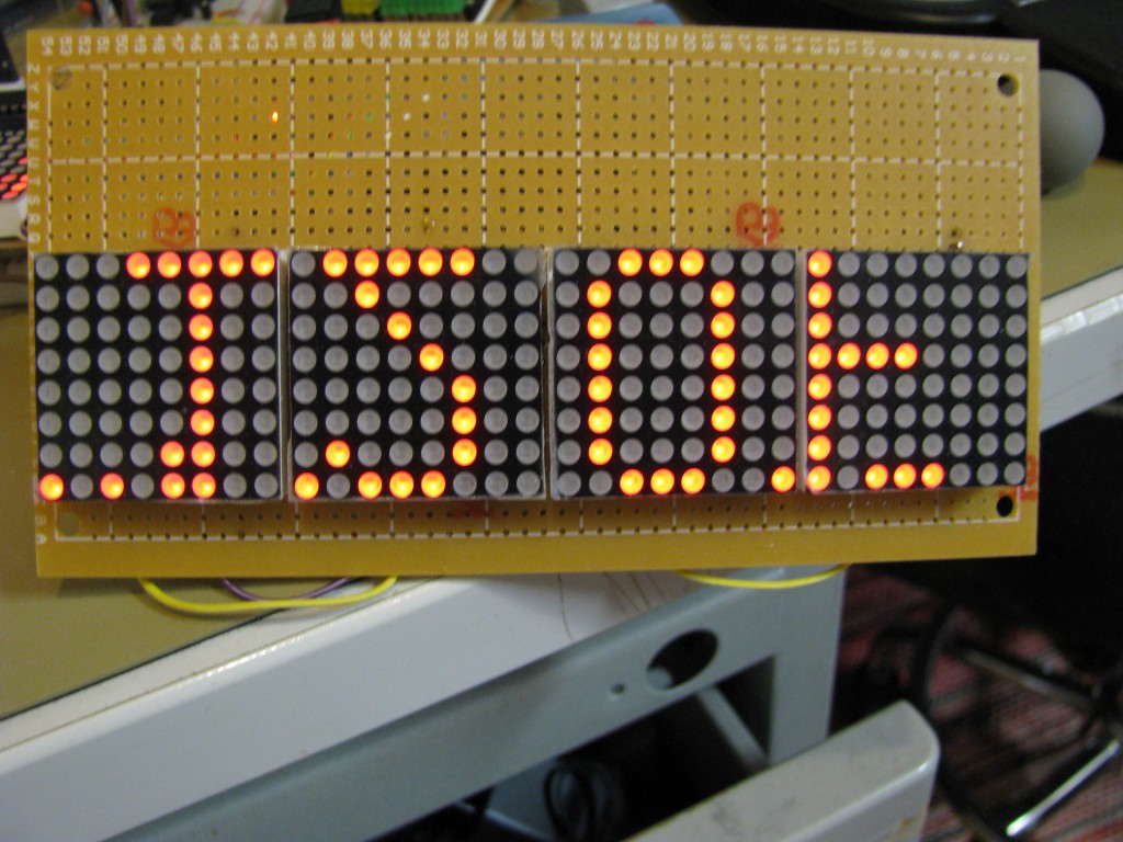

Doggy, here's output for that new FontMap:
and full code:

cant see the 1,
lets change: charput( 1,11,0);
to: charput( 1,7,0);
plus this:

Here we go:
this map should work! lookin good now!

  • FontMap.h
number one looks better now, ehh what clock?
