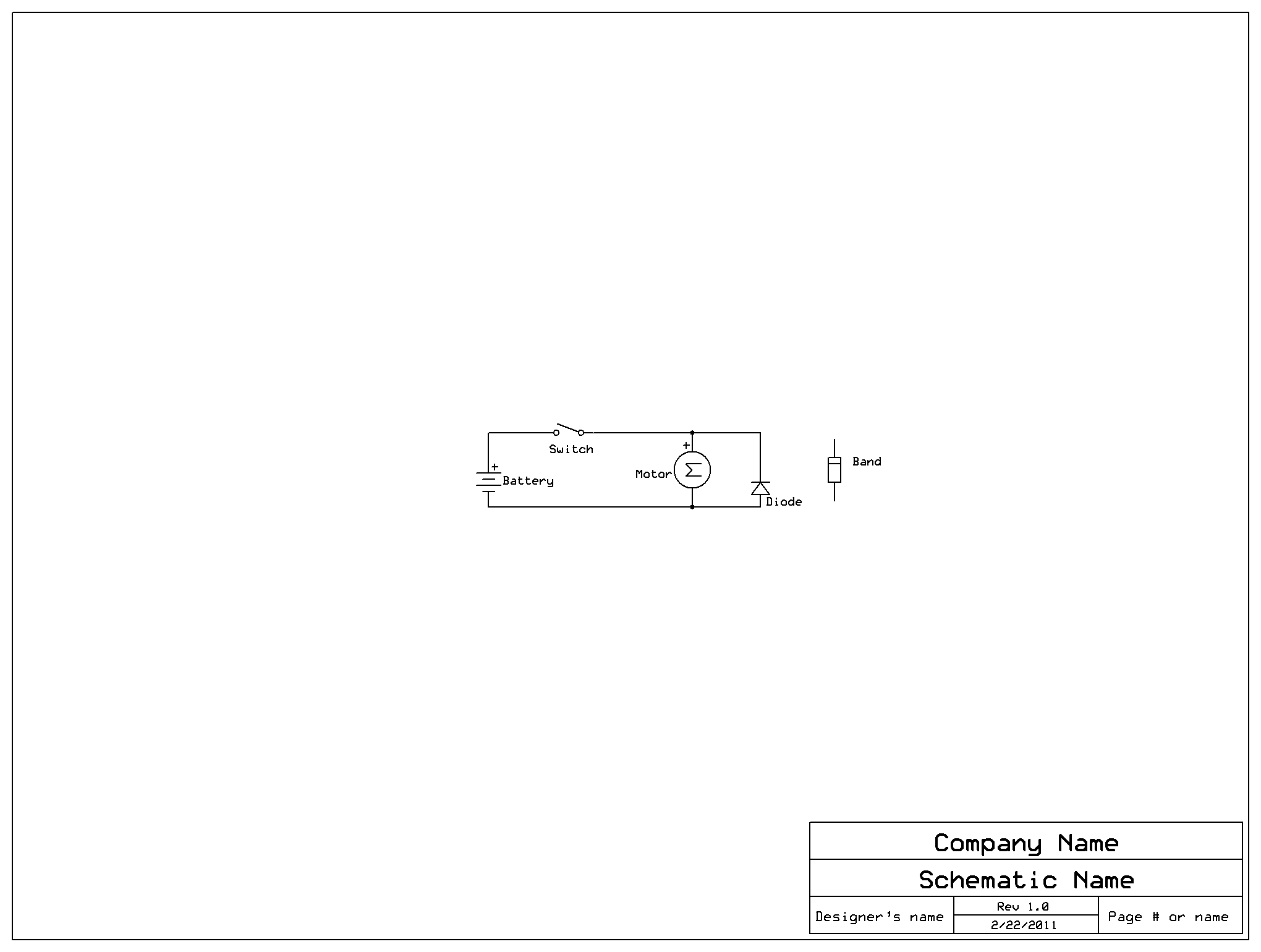

It won't do anything for you. You need to find the source of the surge and eliminate it. Please tell me exactly how you connected the diode. Saying "From negative to positive" and such doesn't mean anything to me. Where exactly did you connect it. Was it parallel to the motor, etc.

I put it in parallel with the batery in both directions, like the scketches below, one of them
batery------------0---------0(switch)------postive motor
I
I
---------- _V_--------negative motor
batery------------/\---------0(switch)------postive motor
I
I
---------- ----------negative motor
1) I don't know what your diagram means. Please post a proper schematic that shows the circuit.
2) The diode goes across ( parallel to ) the motor
3) Please look up the definition of parallel and series.

Hook it up like below if you can get to it.

I did it like that in paralell with the batery, so instead of being next to the motor, it is next to the batery.
So i need something, to protect those contacts, but to put in the batery before supplying power to the circuit.

Why not connect the way that's been suggested over and over? If you don't do it correctly, then you can't expect it to work properly.

It must be connected to the motor. It won't work by simply connecting to the battery. You don't have any path to a solution if you can't connect to the motor, as far as I know.
