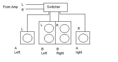

Cabinet Switcher
I am having trouble understanding how I switch a stereo pair thru the one switch. I sent a picture of what I am doing. Please bear with me and thanks.
as an aside - how do you edit or change the uploaded file associated with a post? I needed to edit the drawing and i lost my associated text in the process of 'managing' my uploads.
thx!
