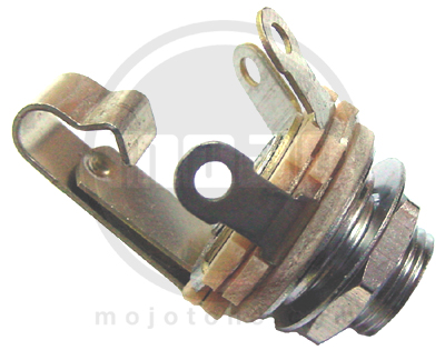

Think I found a way maybe
GtarPlaya11 said:
When only one set of spkrs is connected the unit 'knows' that and the switcher does nothing. It seems likely to me that a physical defeat of the switcher would be possible via the fact of a connector being inserted or not?
[IE some kind of cross-connection of the output connectors which is broken by inserting the spkr connector plug]
I found this connector - Switchcraft J12A Shorting JAck - which I think I could wire up to defeat the switcher, or route the connection back to the other spkrs. Am I nuts?:D
You're not nuts, but you are making this overly complicated, IMO. Why have the speakers going through the switcher if you won't be switching them? I get everything else you're saying about having everything switch simultaneously and such (I'm also a guitar player), but I don't see why you'd want the switcher to "know" if only one set of speakers is connected. If using one set of speakers, don't plug them into the switcher... simple enough, no? Just plug the one set you are using directly into the amp. The switcher will be fine with nothing connected to it, or you could disconnect it completely (the latch/unlatch connection on your MIDI controller will also be fine with nothing connected to it).

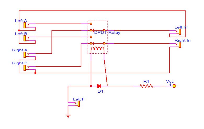

Let me make sure I'm understanding this correctly and I have exactly what you want to do down here...
You already have some sort of MIDI switching device such as a controller with a latching output (usually used so that the MIDI controller could be used to control the channel switching of an amp, basically designed to be plugged in in place of the amp's usual footswitchl). You're going to use this latching output to control this speaker switcher of yours and I assume it uses a 1/4" tip-sleeve ("phono," just like the instrument or speaker cable) connection?
What you're looking for would be something like this attachment then. You will need to provide an appropriate power source from something. A battery could be made to work, but I'd go with a DC adapter. The value of the resistor will depend on your power source and the requirements of the relay, the diode could be just about anything (as long as it has a reverse breakdown voltage greater than Vcc). You'll need a total of 7 1/4" jacks. 4 for the 2 sets of left/right outputs, 2 for the left/right inputs, and 1 more for the latch on the midi controller (preferably chassis isolated, at least for the 6 carrying the speaker signals... I can't guarantee something bad would happen if your speaker return path isn't isolated from your switching circuitry ground, but I wouldn't think it a good idea).

Thanks JB! That was very helpful. I do tend towards the overly-complicated and you are, of course, completely correct...don't plug the switcher in. Simple.
Thanks for your post and the diagram/schematic thingie. They will help me immensely as I am a complete IE dummie.
