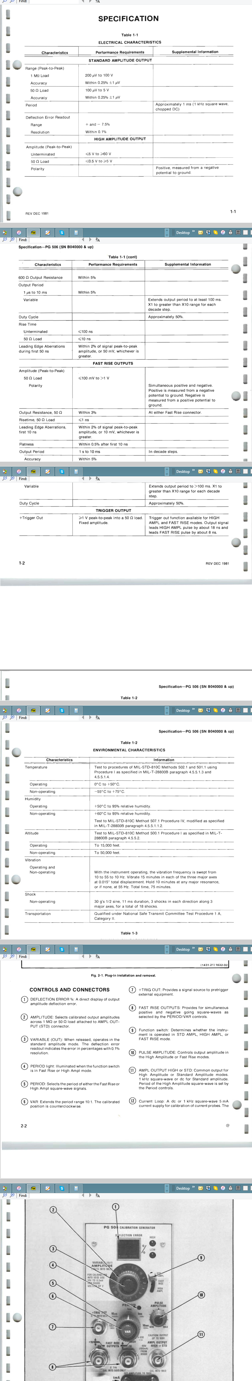

I pasted original specs in previous post link just below...
Before starting any design ( my frequent rant) you must write your own Design Spec.
If duplicating this instrument, ensure this is what you need, and we don't start chasing skinny little rats late into the design....
- for example this product has a rise time < 1ns with differential outputs +,- Is that what you will do?
if the signal risetime is at least seven times faster than the risetime of the oscilloscope vertical system, the displayed (observed) waveform will have a
risetime that is very close to the risetime of the vertical system. ...
If a fast-step signal produces a crt display with little or no overshoot or ringing, the product of oscilloscope risetime and oscilloscope bandwidth should result in a factor whose value lies between 0.329 and 0.350.
These are the specs he wishes to duplicate, because the instrument is very expensive.

I am duplicating the functionality needed to calibrate the 24XX series of scopes. The PG506 provides precision amplitude (vertical) calibration precision in this case as opposed to rise time precision. Square wave to a few Khz would be ok. The PG506 rise times are woefully inadequate for 400Mhz scope bandwidth evaluation.
The 50 ohm requirement is good enough to 5V.
For timing calibration I would need a sub 100 picosecond rise time square wave for which 50 ohm impedance matching is required to handle transmission line issues. I am considering a comparator with hysteresis control to sharpen the pulse rise times and effectively permit both bandwidth evaluation and time mark generator functionality. I am considering using this device, driven by a uC:

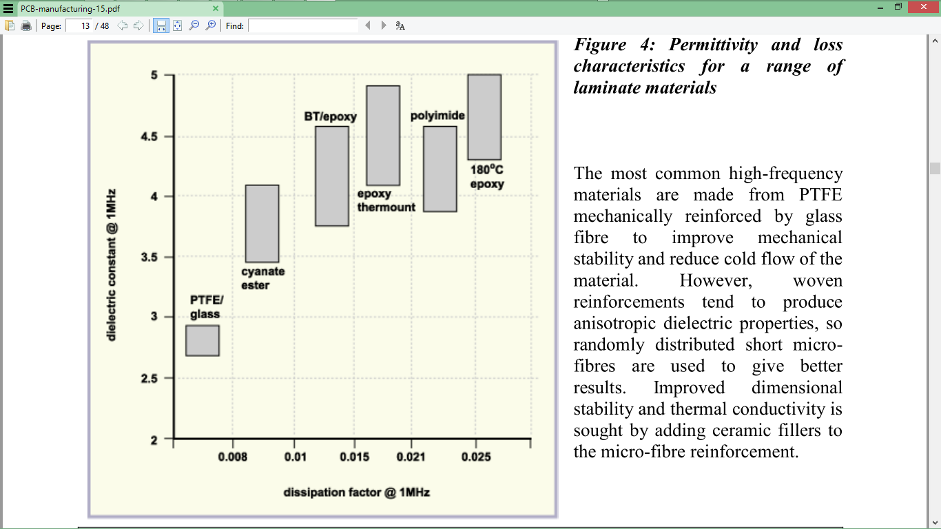

Keep in mind dielectric constant tolerance of 20% is typical which affects transmission line impedances, ringing etc.
FR1 is just a lower flame retardant spec because it is cellulose based with epoxy and not very strong so no PTH and poor dimensional stability needed for stripline.
Materials with lower values of permittivity are increasingly needed for high-frequency applications.
Figure 1 plots both permittivity and loss characteristics for a range of materials, from which it can be
seen that lower values and losses than conventional epoxy-glass boards are really only available by
using laminates based on cyanate esters or PTFE.
If you have some material etched, try seeing if it gets hot in a microwave oven ( no copper) or if it bursts into flames it has a poor loss tangent or dissipation factor and will give poor results for controlled impedance fast rise time signals.

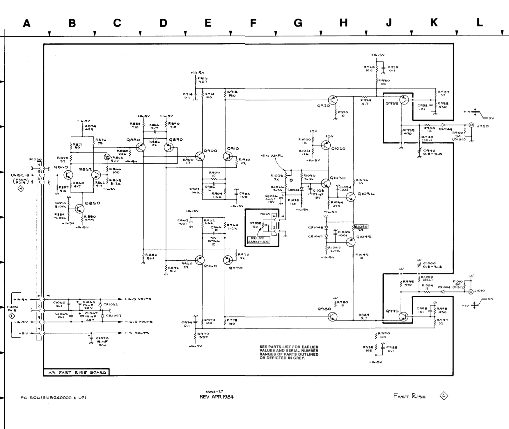

The <1ns fast pulse 50 Ohm differential output is classic Tektronix discrete design.
Here using four precision cascaded differential amps with output +1.00V to 0V and -1.00V to 0V output into 50 Ohms. Note the symmetrical 16.5V supplies and the alternating symmetrical complementary stages of NPN then PNP, then NPN then PNP for the positive fast pulses and for the negative NPN > PNP>PNP>NPN where the 1st two stages are shared.
Brilliant speed , linearity and symmetrical low differential propagation delay or skew.
The circuit has an unusual precision differential Schmitt trigger in the 1st stage that serves as a limiter and before the last stage a 40mA constant current source to drive 25 Ohms (source and load) for a switched current source with gain and offset adjust both outputs from common controls.

There are some interesting subsequent posts, especially Stuart's giving the circuit diagram of the commercial scope calibrator. Do you notice anything familiar about Q920/Q935 and R935?

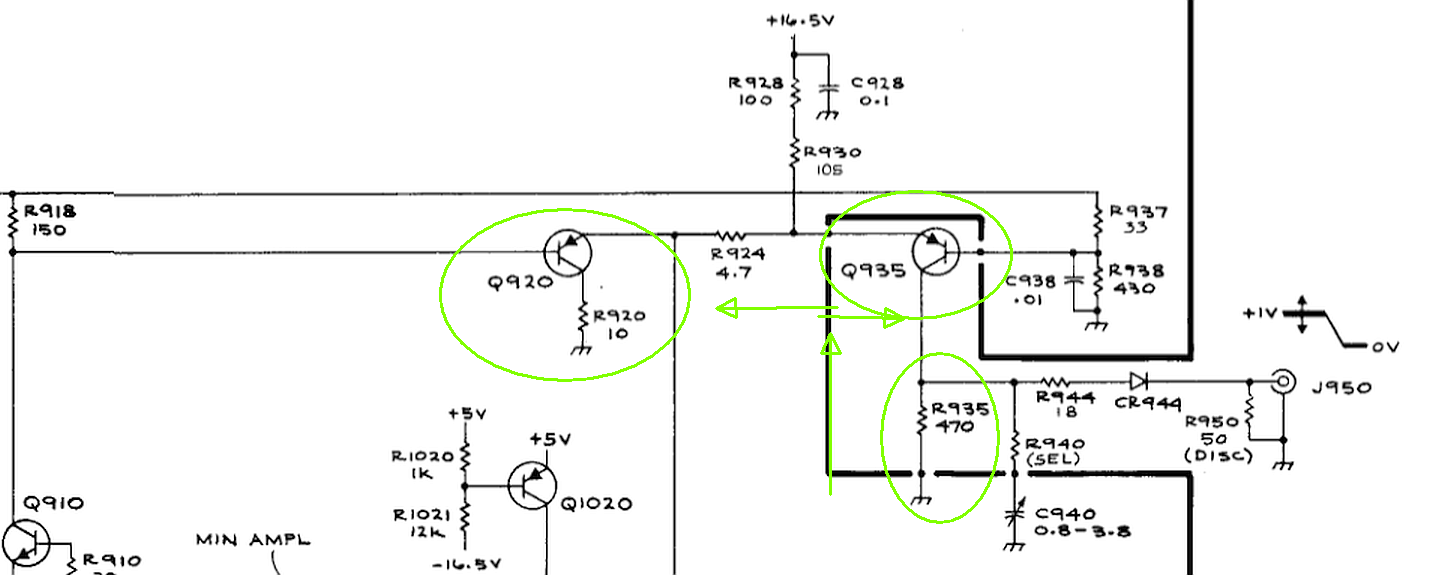

I think you meant the parts in green circles. Yes each output final stage is shielded by metal with feedthru's to prevent E-H field crosstalk for a clean signal/noise ratio and low jitter from dV/dt of >1V/ns = >1000V per microsecond slew rate with sub nanosecond slew rate. ( which is faster than "Damn") or dI/dt >40mA/ns or >40A per us or ...40kA/ms like a power supply short cct. transient in EH fields.
There are alot of biasing arrangements going on here to get a super linear super fast current switch with a common mode adjustable current source with 2 pots so that the output impedance is exactly 50 Ohms ( laser trimmed disc) at 1V , 0V and in between. i.e. high s22 broadband.
