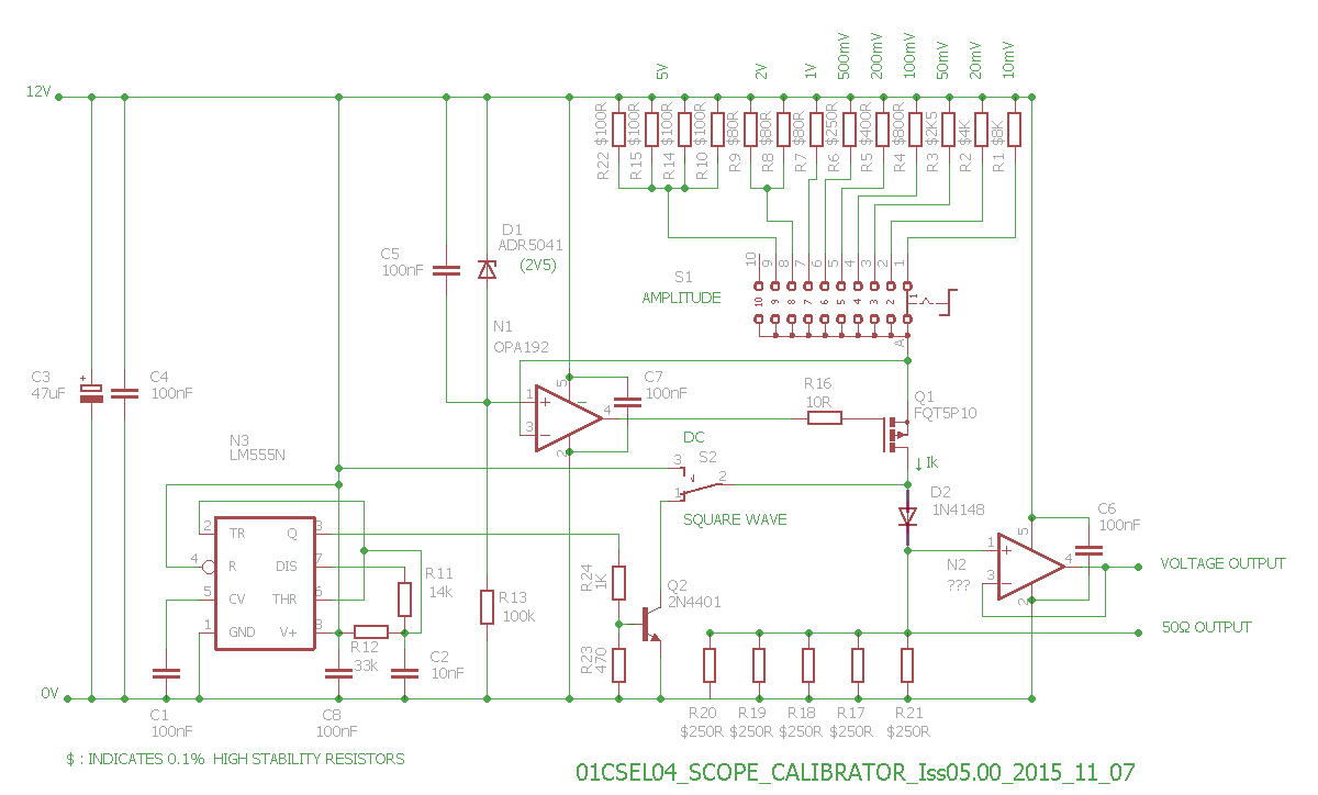

Scope calibrator circuit with the current steering corrected
ERRATA
(1) connection from S2 top to 12V supply should be deleted

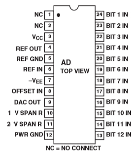

I have a thing about schematics and PCB layouts and always try to have the data and address buses in order so, for example, Do might go to pin 1 of a connector, D1 would go to pin 2 and so on. We had a great guy from the drawing office do the layout of the DAC board: it was a work of art. When I fired it up though, the DAC output didn't make any sense. Of course, being a pre-production part I thought it was faulty but apart from the weird output everything seemed to be working fine. I just couldn't figure it out, so I asked another engineer to have a look at the schematic, board, and DAC data sheet. He said everything was ok.
In the end I found the problem. This is representative of what was in the data sheet:
Would you believe it, D0 is MSB and D11 is LSB, the opposite of what you would expect. Analog Devices put it in brackets now but they still use the same back-to-front notation. So bang went the nice layout and, even though the wiring line did a neat job of reversing the connections, the circuit diagram looked like someone vindictive had been at work with the bus lines crossing and snaking all over the place.
Like you, I could tell many tales but I think I had better get back to the scope calibrator now.

Ground shift and I*R drops are easy to miss. Ensure termination is ideal for fast clocks. Current mode logic is ideal as is current loops for analog. DIfferntial loads keeps the current constant, which is why ECL is noise free. precision voltage sources can be sent long distances by converting them to precision current sources. Braid wire works well for common grounds otherwise flexible copper conduit for microwave.
That does help, the instrument looks fairly useful to 700Mhz based on its stated spec, just 4% at Full scale.
I suppose I'll have to change out the electrolytics and tantalums given its age though, but the construction should be old school serviceable!
Price isn't bad really.
But this one looks good....with all the accessories
The critical voltages are vertical and horizontal sweep. If you capture the high voltage (~100V) of the horizontal sweep with a precise S&H and the waveform required, then any accurate DMM and uncalibrated signal source could be used. The time base accuracy is easy with Xtal accuracy and the vertical gain and offset accuracy is easy with a good DMM and any uncalibrated voltage source. This is essentially how the Tektronix PG506 cal unit works, I think is the built in DMM. Deflection error is measured in % relative to 100V. Tek's DMM uses a modified dual slope integration method which has better noise immunity than older type SAR successive approximation types due to S&H errors, but modern ADC's have improved this with less crosstalk in special CMOS switches. The DMM is only 200 counts per ms. But the calibration of the Calibration unit was done by Tektronix using a JOHN FLUKE Model 8375A with 0.025% accuracy. The 50 Ohm termination is accurate within 1000 ppm. Risetime abberations were measured on DUT scope with 10 ps/div scope. or at least 7x faster than the typical mainframe scope.
Output amplitudes of 100 V, 50 V and 20 V originate directly from a precision voltage divider composed of 4 R's and a 5 mA Current Loop .
The 50Ω source section operates only when amplitude settings of 10 V or lower are selected.
The standard square wave output goes up to 100V? with 1/3 octave steps and a vernier scale. 1,3,5,...10,30,50....
The fast rising pulse source is essential to calibrating the scope's low frequency and high frequency phase and high frequency droop compensation for flatness.
I think the most important part of obtaining accuracy of 0.25% is when you use the scope in differential mode with both channels matched to get maximum common mode rejection across the entire spectrum so you do A+B(inverted) to sense any high voltage current or differential high speed signal with an offset CM DC voltage. I always found this to be very handy in my line of work.
