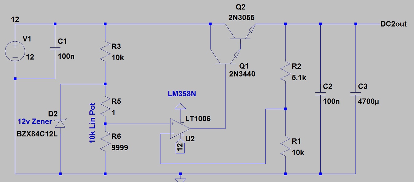

I was thinking about this last night & I can use either a rechargeable 1Amp/Hr 12V battery or a car battery for a stable power supply, would this be better?
I'm not really sure if the INA126P can operate on a single supply though?
I built a small Adjustable DC Circuit a while back to calibrate some things on my engine dyno, is something like this suitable?
Circuit attached!

That supply is better than a car battery. I have an idea, but it's not a perfect solution:
Divide that supply so that 12V (or whatever) is 5V, then buffer it with a x1 Op amp. Use that buffered reference for your setpoint divider.
Just check the 12 V voltage before each test and keep an eye on it. The 5V should be fine, but check that too.
You will at least have a ratiometric setpoint and a ratio metric output. If the voltage is "whatever", then the output in volts will be consistent and correct. The actual pressure setpoints would be as correct as the divider at all voltages.
Reality suggests, that you should build a ratiometric meter to look at the setpoints and output. You may be able to use the same display. Controllers usually allow setpoint, process or deviation to be displayed.
It's probably better if the setpoints read in engineering units anyway.
If you want the Arduino to know the pressure, then:
a) make the 12 V / 5V exact
b) Make the arduino measure ratiometrically. Possible: not sure. If an external reference is possible, then yes and you don;t have to operate the Arduino on the same 5V supply. You just might have to divide and buffer another output like 2.5 V ratiometric reference for the Arduino A/D.
Aside:
The desin has some faults for a "stable" power supply. A Zener diode is not a reference. A 5.1 V zener diode comes close because avalanche and Zener mechanisms occur at the same time. The 5.1 Zener was popular until band gap references came along.
Never drive an OP amp from a High Z source unless it's a buffer or comparator. So, to make that design better, the refermce should be buffered. So, why not use a "buffered reference?

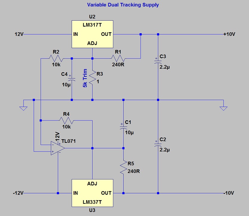

Would this be a better way to start, I could adjust it for +-10V output which would power the Pressure sensor, INA126 & the Arduino , then go from there for the reference voltages.
See Attached!

The Arduino regulates on the board to 5V, I think, so the +10 or 12 doesn't matter. 10V may be a more convenient number.
I think the way your using the IA, tracking supplies don't matter or matter very little. It depends on what you have, but it takes only a few extra parts to turn it into tracking.
Remember, the bypass caps on the OP amp.
Yes, the Arduino Mega 2560 spec sheet says that the recommended input voltage is 6V to 12V or 20V max, I looked at that before doing anything else.
Yes I did forget the Bypass caps?
I think I'll go with the tracking supply as I might need it for something else?

So, you get the idea. You scale the power to the sensor and probably buffer and apply it to the Aref pin (within the range expected), then you can read the sensor correctly.
One neat way of doing current limited buffering is to put a series resistor to the output, but take the negative FB from the other side of the resistor. The resistor limits the current, but the voltage is correct. Otherwise, the OP amp is charged with that job and might require short circuit protection.
