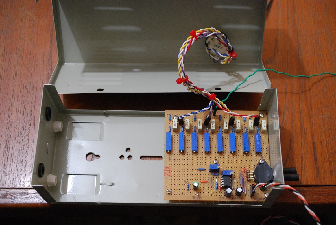

Do you think I should use a Low Pass filter on the output to the Arduino of this circuit, I did have a 4.7k resistor & a 10uF cap as a filter on the output but removed it?
I then made up a multiple Set Point Circuit basically it has 8 outputs of 0.5V to 4V (5" to 40"water) in 0.5V steps (5" water steps) using a multiple position switch.
Although not wired in properly yet I have attached a picture of the circuits mounted in a steel enclosure, I am going to mount the Arduino Board in this same enclosure & keep the Zero Cross & the Triac circuits separate in another enclosure.
I am progressing slowly & am learning a few things along the way.
If you pick anything that will cause issues please say so & I'll correct them?

One thing i noticed right away about the circuit board is there are not enough pots on the board. 10 trim pots are not enough, to get 1 percent control you need at least 100 pots :)
Seriously, i wonder what all those pots are doing and why they are not mounted at the edge of the board so they can be adjusted easily.
Yep, the orientation of the pots looks dumb or you have 20/20 hindsight or whatever perfect eyesight is in metric form.
So, why not use course and fine adjustments. e.g 10K+500 in series or whatever.
Hi MrAl,
The Eight Pots in a row are to trim the eight voltage dividers to give 0.5V to 4V output in 0.5V increments to be used with a multi position switch for 8 accurate Set Points.
Yes, they could have been mounted on the edge of the board but for this "prototype board" I decided to mount them where they are to keep all unnecessary wiring away from the Arduino, that's the only reason. They are easily adjusted.
I could have used a multi turn pot to get my set points but I have trouble now with balance issues etc making some things very difficult to achieve, so I opted for eight set points only which is all I require & at the turn of the multi position switch it makes life easier for me now with one click at a time.
The other two pots are to trim the INA126P Gain & Offset.
Could you give me some advise for a way to do it without using so many pots, resistor values are not accurate enough to get good results & they require trimming?
I need eight accurate set points, so I just used voltage dividers & trim them with the pots?.

Not really sure why I need Course & Fine adjustments, I just need eight accurate set points as mentioned each at 0.5V increments?
Do I need a low pass filter out of the INA126P to the Arduino input.
Giving way to aesthetics I thought it better to route wiring away from the Arduino rather than have something look good but run wires all over the place creating problems, my bad if it doesn't make sense or look good.
Like I've mentioned before I am only a beginner with electronics & not ashamed to admit it?
Cheers
Does accurate mean "spot on" or just repeatable? I think you did OK. You just need a crooked screwdriver to adjust the pots. No big deal at all.
The only thing I would not do, is use the power supply for the divider reference unless whatever is reading it is "Ratiometric" and not absolute.
Reference IC's are more stable. I "think" your pressure sensor has a ratio metric output.
So, if a processor reads the vacuum sensor, the output is relative to the supply voltage. D/A references can sometimes be changed so the power supply is the reference.
The aesthetics look great. The ergonomics could use a little help.
Think of it this way, I think your pressure sensor's output is relative to the supply voltage, so your setpoints also need to be relative to the supply voltage.
So, when the supply is 5.0000 V, you may want 0.5000 and 1.000 volts, but if the supply drops to 4 V for whatever reason, you don't want those same voltages. So, for the 0.5V case, it's 1/10 of 5V. So with a 4V supply, you want 0.4000 volts or 1/10 of the supply. Any noise in the supply also ends up to be ratioed as well. The sensor would see the same changes and the 0.4 and 0.5V would be equivalent. V supply is a function of time. A 5.000 reference is not. By making the reference and the sensor affected by power supply variations, the variations dissapear.
It isn't the same as having a sensor that has a 0-5 V output for say 0-50 engineering units.
Haha, no crooked screw driver required, I have very small watch makers screw drivers that fit perfectly, I looked at that before mounting things.
Spot on & repeatable is the go.
Yes, I was also concerned about variations in the power supply & it's effect on the divider reference voltages, pressure sensor supply & the INA126 so I loaded the power supply output with more than double the load it will encounter with all the circuits combined & checked to see if any variation existed but I found no variation at all.
The power supply I am using is from a computer & is rated far above what is required but I have several of them to use up.
I see no variation in the output voltages to the pressure sensor or anywhere where else even though the mains voltage does vary.
Yeah your probably right I could have done better but by the time I fit everything into the enclosure including an LCD, Led's, Switches, Circuits etc I was more concerned about the wiring & where it is to be routed rather than anything else.
Yes, reference IC's would be better, but I am stuck with what I have available at hand which is a lot of recycled components, like on the circuit shown, besides the pressure sensor, resistors & some of the capacitors which are new.
I think the biggest thing to remember is that no matter how accurate I make things, the Flow Variations of certain test pieces are sometimes not stable at all & sometimes erratic turbulent flow exists before modifications are made to the test pieces to smooth out the flow.
Sometimes the test pressure can increase & decrease rapidly along with total flow through the test pieces, this is of more concern as the PID will try to correct for the variations which are unavoidable, in fact you try to get all the test pieces unstable at first so you can see what the maximum potential flow can be once configured correctly.
Airflow through the test bench can be a violent affair as it is through engines.
I'll have a manual override switch so I can use the test bench manually when unstable flow exists, then when sorted I will switch over to the PID circuit to get final results or otherwise the PID will create havoc trying to correct for unstable flow conditions which can be very unpredictable to say the least.
Anyway I'll keep going at it & see what I come up with.
Cheers
Well in order to answer the question posed here about creating accurate voltage dividers, we first have to know what the tolerance really has to be on each voltage. You really have to think about this because if you shoot for too good of a tolerance it may be just an overkill and then it is difficult to achieve, while a more practical tolerance will be easier to implement.
For example, if you look at your circuit and find that the readings (or whatever) all come out close with 2 percent tolerance, then dont quote a 1 percent tolerance. Likewise, if 1 percent is good enough dont quote 0.1 percent. For most applications 1 percent is good enough and 0.5 percent is way good enough.
There are more precision resistor values too, like 1 percent and 0.1 percent. That could mean just ONE trimpot for any number of voltages.
On the other hand since you already have this built maybe it's good enough as it is, unless you want to reduce size or make more of them.
MrAl, thanks for the reply,
I see what your saying with the tolerance, I did spend time setting exact voltage references & have for example 0.500V, 1.000V, 1.500V, 2.000V etc, this is with my DMM of course & who knows how accurate that is anyway. I was thinking that things have to be very accurate but now realise differently after your post.
I did the same with the output from the Pressure Sensor amplifier as well and I see that I spent far to much time trying to get exact readings but they do appear to be on the money.
Yes, precision resistors would be good but unfortunately I only have 5% resistors at hand at the moment.
I will build the whole thing properly as this is only a prototype to see if all goes well to start with, it's a big learning curve for me & thanks to the input from others I will learn how to do things better or in my case, correctly.
Cheers
For giggles, post a link to the datasheet for the pressure transducer. I'm interested in the transfer function. It probably contains a Vcc term.
An example product, not available, of course, is say 10 isolated 1K 0.1% resister array. **broken link removed**
Cheers
If you have 5% carbon resistors one trick we used to use is to start with a lower value (not too much lower) and cut a "V" shape in the mid section with a small "V" shaped file. As you measure some quantity like the voltage, gently file a little deeper into the body of the resistor. As you dig deeper, the resistance goes up and that is how you adjust the voltage. Finish up with a coat of electrical clear coating type paint.
You can adjust the value this way but of course the temperature tracking wont be as good as a 1 percent or 0.1 percent resistor, and you might want to try it with carbon film type too first to see if this works with them too.
Not the easiest to do but it's cheap :)
MrAl,
Yes, that's one way to do it but pots seem to be the go at the moment, with the health issues I have now I couldn't imagine myself attempting such delicate work.
Besides brain damage among other things I am a bit unbalanced with things seemingly in constant motion & very fine work I am not good at now, it's a real pain in the butt, hence the need for automated control of my test bench. Even setting a multi turn pot to exact values is an arduous task.
