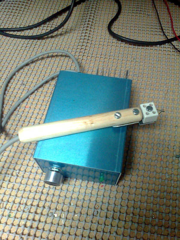

Pretty much all the tips will be nichrome wire, however pyrographers tend to use anything from 30swg to 12swg, hence the need for variable amps, to make things worse you can get branding irons to fit the pen which use a coil of a few turns of nich wire to heat the brand, not a massive inductance but probably much more than the leads, the brands are usually brass which isnt going to be an issue, the cheeper ones are cast which will bump up the inductance, I'm sure this is why they say they screw up psu's.
I'll look into measuring the inductive kick back, thats an interesting idea, the fet I tried is rated at 1200v so doesnt struggle, but I could use a lower voltage fet with a lower rdson/gate charge and dissipate even less heat.
Efficiency doesnt worry me much, so long as the 'sink isnt as big as the kitchen sink, I was thinking of using a mov accross the fet just in case the mrs gets some of the cheep iron brands and jumps up the kick back.

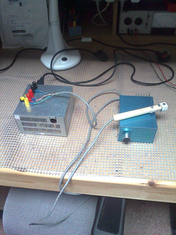

Well maybe when you get something together you can post a few pics.
OK were going to lash up a trial to make the father in law's anniversary present, I'll take some pics.
I have the pics but my camera's having a bad day.
I gave up on the transformer idea, I had a couple of pc power supplies so I adapted one and used it in conjunction with a simple circuit using a tl494 and a irf540 as a switching reg.
Works well.
One thing I'm surprised at, when burning wood using nichrome wire you can hear the switching frequency (now 1kc) from the tip when in contact with the wood, I didnt think 26swg nichrome would respond temperature wise anything like as quick as that, the wire runs off 5v so I dont think the moisture in the wood is responding to the applied voltage, bit strange that.

The nichrome wire is only around 1 1/2", I'm relying on the resistance of the cable to the wand to prevent the psu from going into overcurrent and shutting down.
Heres the completed burner as promised, the choc block on the end of the wand is porcelain, so it doesnt melt from the heat of the tip, the pot is 10 turn, pyrographers are very fussy:
