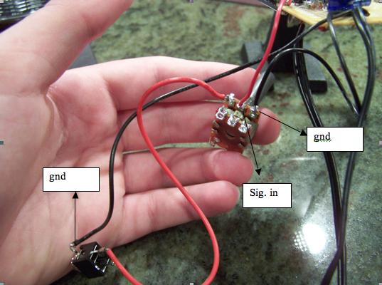

I just attached a speaker to it and it did start oscillating, the speaker was humming and moving back and forth very slowly, and the tab got very hot, yet it made no music. I am using a 100K pot that I had lying around, one of the inputs from the input source goes into the first pin on the left, and the output going into pin 3 on the IC comes out of the middle pin on the pot, and the final pin on the pot is connected to ground. The other "common ground" pin on the input source is also connected to ground. Is there anything wrong with that? Do I just need to attack a heat sink to the IC? Help is always appreciated. Thank you.
Without seeing your schematic nor a photo of what you did it sounds like there are a few serious problems.
The center pin on the volume control should have a 1uF coupling capacitor in series to the pin 3 input of the TDA7240A amp.

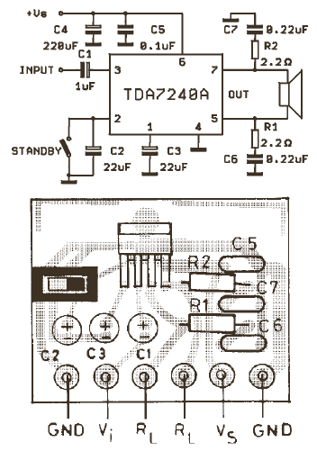

This is the recommended schematic and pcb design shown on the datasheet:

Did you use shielded audio cable to connect the music source to the volume control and short wires from the volume control to the amplifier?

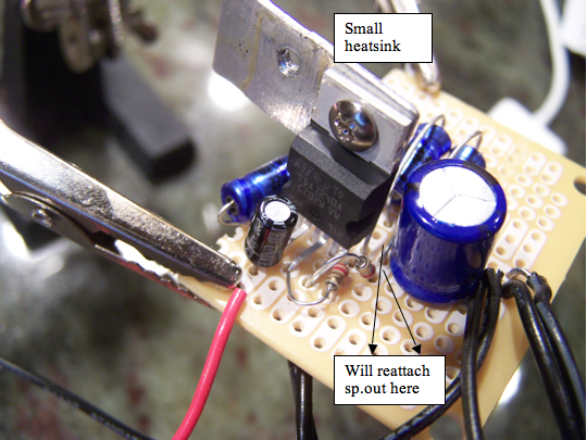

I moved it to a protoboard and fired it up, it idled at a regular temperature, but when I started playing the music, I could barely hear it, and the IC started heating up, but it is on a small heatsink. The 220uF cap attached to pin 6 is directly on the pin, because ther were no open holes, could that be the problem? Is the POT value too high at 100k? Do I need a smoothing cap along the + and - rails? if so, what value? Thank you for your time, Audioguru

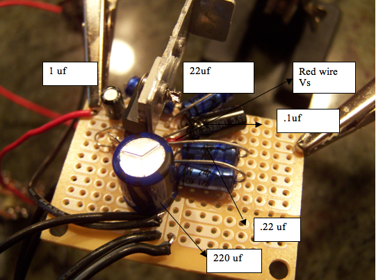

I tried moving the 220 cap lead and that made no difference, the speaker does oscillate slowly and buzz, I tried to add a 100uf smoothing cap along +and ground and it only sparked so I did not continue with that. What should I do? If you need a pic of it, i will take a few, just tell me what you want photographed, I am completely lost, help would be great. 4 of the caps are axial, and I have never used them before, so I looked them up online and saw that the dimple in one end marks the + end, so i put that lead coming from the IC into ground, are these backwards? They do not heat up so I think they are right. Help would be great because I have no idea what to do.
Modern electrolytic capacitors have a big arrow pointing to the negative wire which is ground in your circuit.
Take a clear photo of your circuit board and label (use Microsoft Paint program) the parts values.

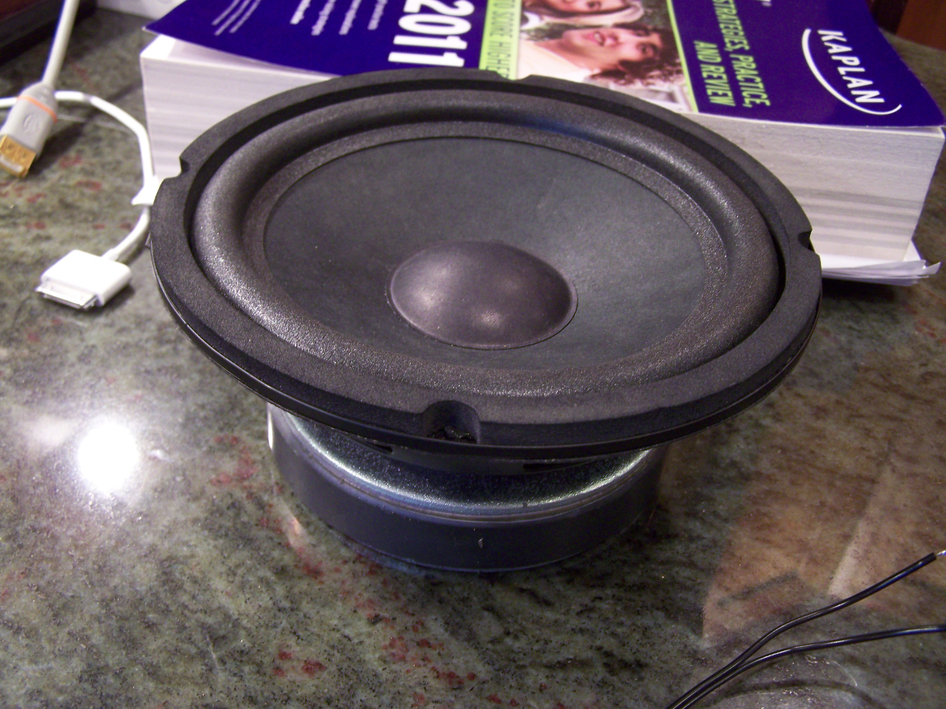

These cap dont have many markings, like a regular cap has the big strip on it, these don't for some reason, so I checked online and found that a dimple on them was supposed to be the + leads. The speaker is a 50W 8Ω, 2 for $10, couldnt resist

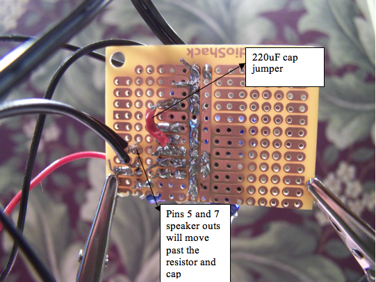

more pics, realized a possible mistake of the speaker outputs, will move them

I just moved the spk. out wires and it works when no power is applied, at the strength of my ipod. Should it do that? because when I apply power it becomes staticy and distorted
I haven't seen axial electrolytic capacitors for about 35 years. Maybe yours are old and do not work anymore.
Look closely at the schematic and pcb design on the datasheet. C5, C6 and C7 are not polarized and are the shape of ceramic capacitors that are good for high frequencies so that the amplifier does not oscillate. Replace your electrolytic capacitors.
