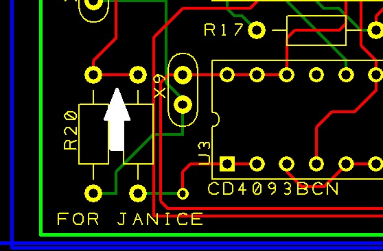

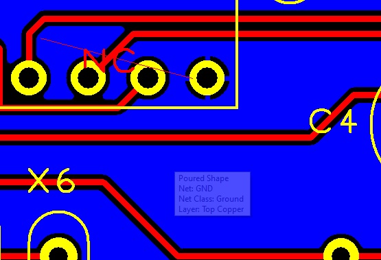

Throughout the project i would run the design rules check. I selected everything. I would only get a message about the leds silkscreen overlapping the pad. ive since corrected that. I just re-ran it again but i noticed i missed a set of checks. "NETS" how dumb. if i had seen that and had it selected it would have surly warned me about the missing route between R20 & R22. Needless to say ive got these 4 new errors or really existing errors.
if you could help me understand what i should do (if needed) about them in this report.
Results
Gap in Net "GND" between (14619.000,23117.130) and (15156.000,23742.130)
GND.
Gap in Net "GND" between (14619.000,23117.130) and (14469.000,23792.130)
GND.
Gap in Net "GND" between (15974.449,23300.000) and (15719.000,23367.130)
GND.
Dangling Track from (14215.000,23500.000) to (14250.000,23500.000) on layer Bottom Copper
Number of errors found : 4
Gap in Net
Dangling Track
I found them. the net gaps were resolved when i re-poured and removed islands and the dangling track was a tiny route under a pad that i must have not deleted when i was re-routing a track. i deleted that. reran the report and all is good.

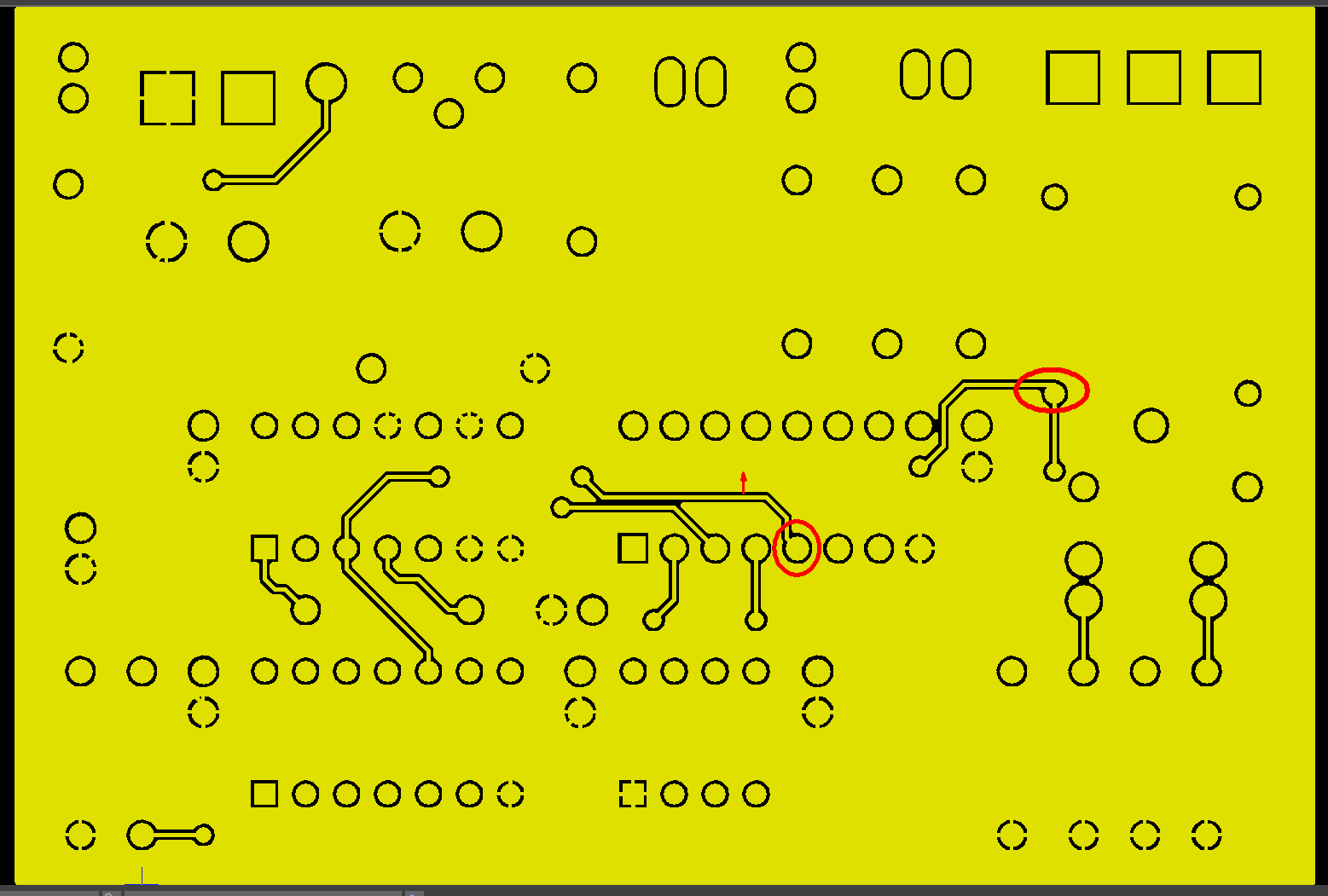

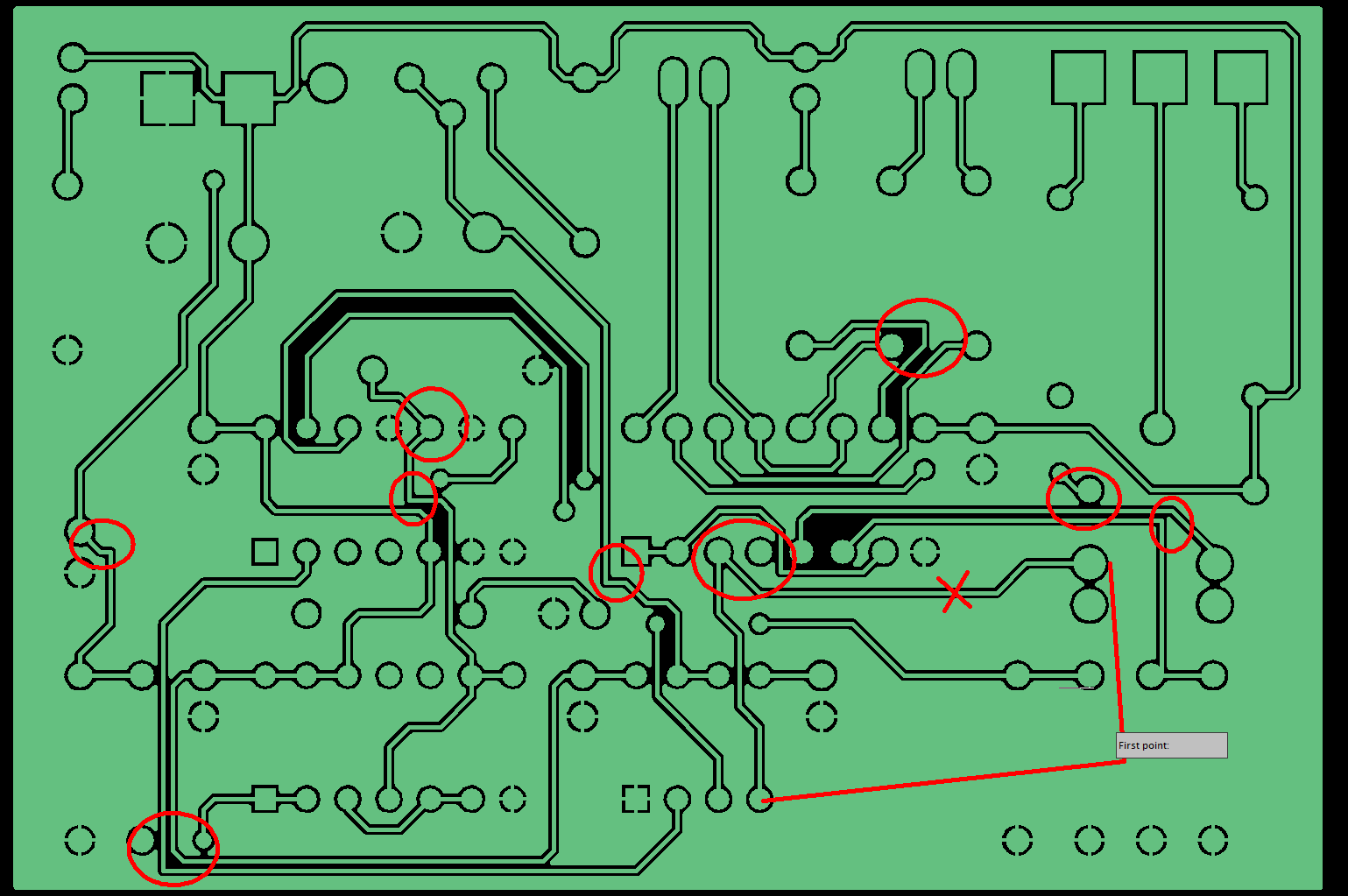

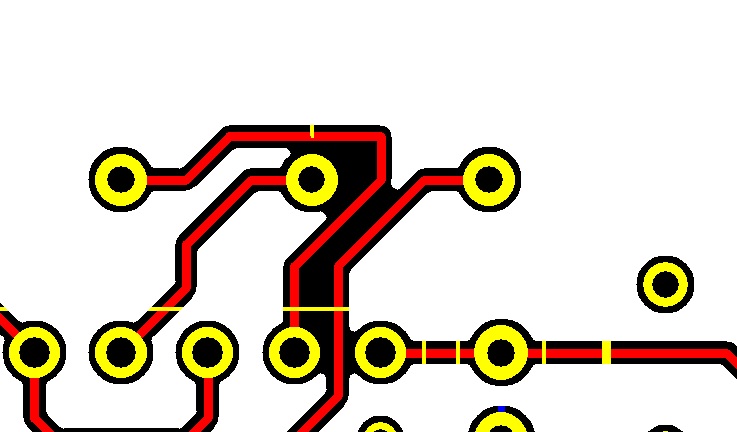

This group of files "Rev6-1-a.zip" are organized ok. However:
1. The top copper has tracks that need correction. review attached.
2. The bottom copper has tracks that need correction. review attached.
3. The bottom silkscreen has random characters on it. Review, then keep or remove.
4. The top/bottom paste is not needed (only for surface mount).
Comments:

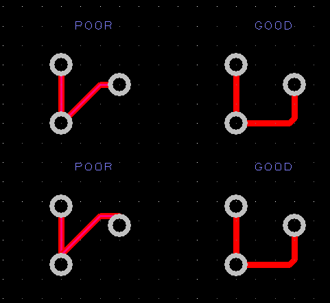

4. When you route tracks:
4.1 Try to route the track point to point using 90 degree angles.
4.2 Use no more than 2 track connections per pad.
4.3 After the route is complete, add "45 degree miters" at each "corner".
Now...I'm not suggesting to go back and re-route all the tracks. Use this info for future projects.

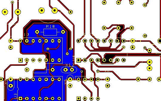

I can absolutely do #4
#3 is where the order number goes. (JLCJLCJLCJLC) thats how i was instructed to format the location. it will be replaced with whatever they are going to place there.
#1 & #2 i just do not understand. And i say that with a huge sigh. We have exchanged over 800 posts in the past few months and if there is one thing you have figured out about me is sometimes i need the stupid slapped out of me. This is one of those times. With that being said the software and or my old PC drives me insane with the screen re-draws. Ive posted some examples. Now sometimes it works great. Those are the times where my tracks look awesome. When my tracks look like crap is most likely when the program blindfolds me with white screens, half renders, and other weird stuff. Thoes times i end up setteling for what i can accomplish . Ill attempt to edit the track and add 45 degree leads but the software (and lack of experience) arm wrestles me until I concede. Now this will not stop me from trying to fix the issues but I dont know what it is your wanting me to do. Im going to add 45 degree everywhere i can and separate tracks that may appear too close to another.
OK
I cant do anything about how your computer behaives....but I feel your pain. :cool:
I already stated:
"Now...I'm not suggesting to go back and re-route all the tracks. Use this info for future projects. "
What I've shown you is where the board design could use improvement. You can ignore if you want.
The next action is up to you.
maybe this will help:
i did what i could to make it better. I received 2 net dangle errors that were difficult to clear but they are gone now.
Oh the mounting holes. The boards will be slid into a pair of miter slots. like the kind you see on all thoes movies where actors are seen ripping out p.c boards to save the planet from self destruction. here are my final data and drill files.

thank you. If you have looked at my interpretation prior to your upload of the images showing what good and poor tracks look like youll see that i have not done very well.
On the bright side I have learned to control the route tool pretty well. I had read somewhere to approach the pads on a 45 degree angle so the copper pours can have room to add their thermal reliefs.
I did not know how to remove a net and reconnect elsewhere to avoid having 3 nets on one pad so i had to leave them as is.

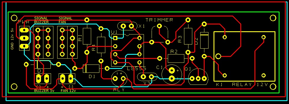

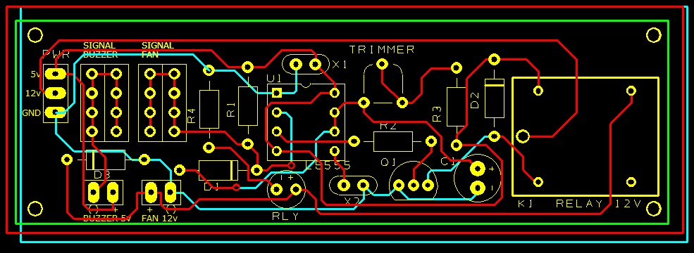

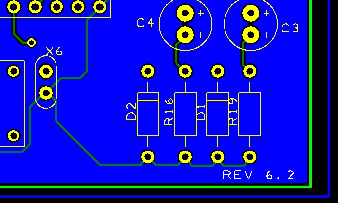

I have become pretty comfortable with the program. I plotted the fan delay off circuit you designed and made this PCB. I had no problems relocating tracks that were trippled up on pads and much better at miters. Ive altered the variable resistor library file to suit the ones I have. Snapping components to half grid makes things easier too. Seeing the PCB boards has spoiled me some so I may send this out for production.
Attached net routing. The second one is improved.
