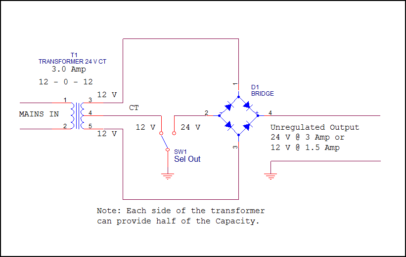

If this was occuring at 12V then more than likely you have a 24VAC CT @ 1.5A and your full winding current is actually 1.5A. In other words, if you ran it at 24V with a bridge rectifier across the full winding you would only have 1.5A available, while having 3A available in the 12V Full Wave Grounded Center Tap config.
Now if you run it with a bridge rectifier across each 1/2 of the winding you would have 12V @ 0.75A on both because each 1/2 of the winding is now being drawn from CONTINUOUSLY rather than having a 50% duty cycle like they do in Full Wave Grounded Center Tap config.

The attached image gives you options of what you have. I assume you have a 24 volt center tapped transformer rated at 3 amps. Now you can have 24 volts @ 3 amps or you can have 12 volts @ 1.5 amps but you can't have 12 volts at greater than 1.5 amps. Not with your existing transformer and a simple rectifier as I see it.
There are transformers with dual secondaries where for example two 12 volt secondaries can be placed in series or parallel with each other but that is not what you have.
If you want 12 volts at greater than 1.5 amps you are going to need a larger transformer. That is how I see it anyway. I may be wrong and it would not be the first (or last) time. :)
Ron
