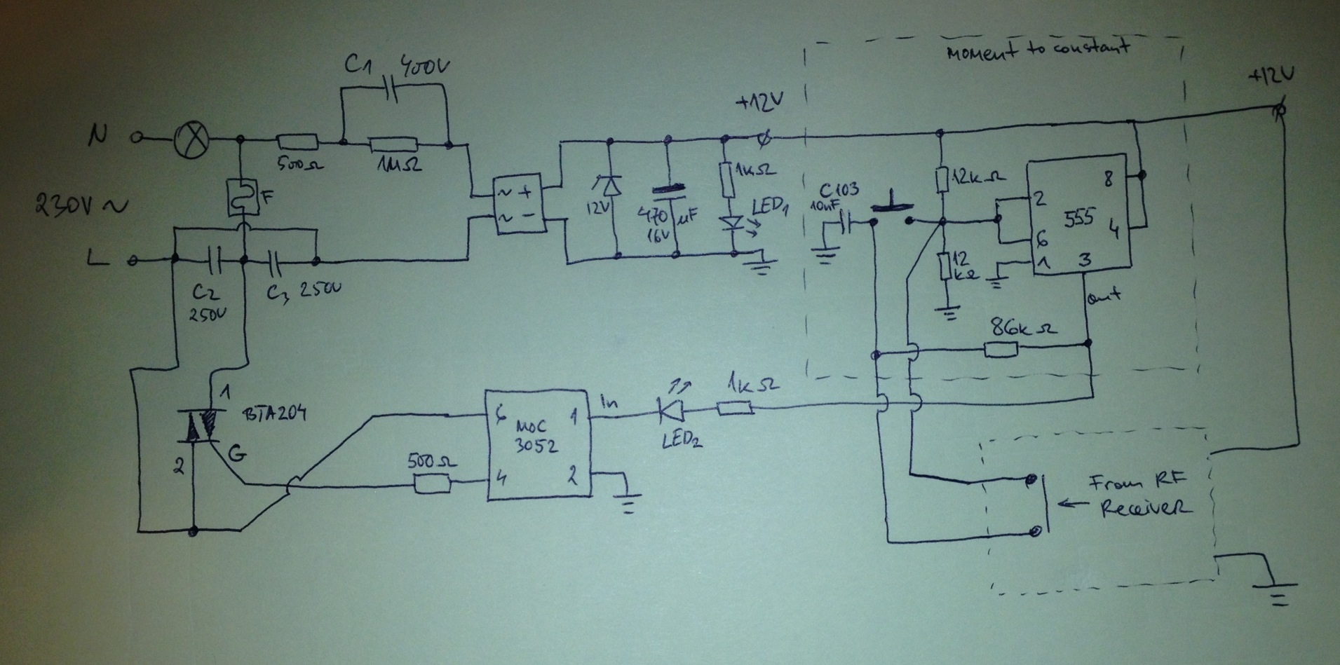

This is the last circuit I've tested and now on my breadboard.
It is working. When I press a button the bulb goes ON, when I tap it again - it goes OFF.
BUT, ...
1) The voltage of the power circuit when bulb off is 11.7V - great.
2) The voltage measured at the input of 555 IC when bulb ON - 5.7V - for the 555 ok but for the receiver?
3) The voltage measured at the input of the MOC3052 is only 1.06V - at the minimum?!
I am afraid that the RF receive wouldn't power with that voltage. I am not sure about the Current.
I am afraid also not to blow up again the optocoupler, therefore these values of the resistors.
Maybe some of the resistor values are too big?
Now I have 2 LEDs ... One is just showing 12V supply. The other one is lighting when signal from the 555 IC.
Actually I would like to have only one LED, which to illuminate when the bulb is OFF. :) ... but only if that will be safe enough.

Hello,
You can try adding the diac between pin 4 of the optocoupler and the 500 ohm resistor. That should boost the voltage when the bulb is off.
If you are not getting the kind of switch action you want then yes the 555 circuit will have to be modified.

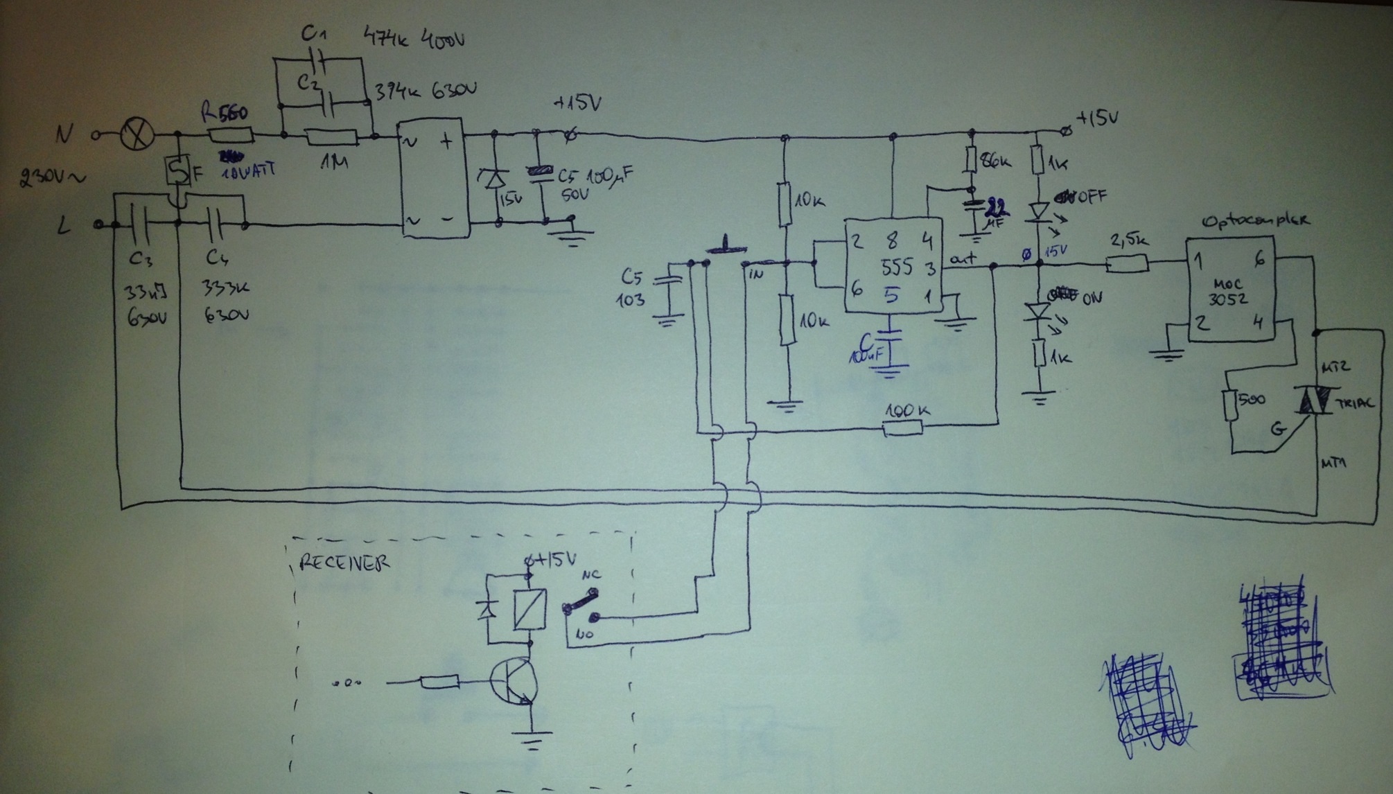

Hi MrAl, hi all,
Here you can watch what i have made so far:
https://youtu.be/fqNeXrMJf-k
Here is the circuit:
What's new from the last time:
- 2nd cap added before the rectifier in order to gain more current;
This is what i have read and indeed i can tell it is better. Actually i should get a new bigger cap like 225K = 2.2uF.
- RF receiver connected to the power supply, relay contacts in parallel with the wall button.
As you can see the wall button is going great job, the relay also triggers quite good when bulb off, but no power to trigger back (and fast) when bulb on. Some times, however as you can see in the video it does.

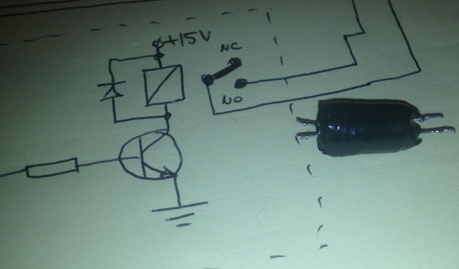

- you can check the circuit of the relay trigger transistor i have analyzed looking at the receiver.
I'd like an advice on how to get rid of the relay and "press" that wall switch with the receiver's transistor (btw SMD type). But i am not sure it will work as there will be some potential coming to the input of the timer 555?
At least can i substitute the relay then with e.g. optocoupler or MOSFET?
- Voltage when bulb off: 12.4v
- Voltage when bulb on: 8.16v
- Voltage when relay coil on: 7.15 - at this moment i think there is not enough current. Btw how and where to measure the current in this case?
- the 500 ohm current limiting R in the supply is generating too much hot! Should i get more powerful like 5w or?

Hello,
You changed the circuit again, drawing those two caps in a manner that looks more like a network than just two caps in parallel which is not as clear.
Also, there's no clear way to see how the opto turns on because pin 2 goes to ground and there is no clear path for a positive current to flow through the IR diode. So it appears from the schematic that there is no way for current to get through the IR diode, and the video does not show that part of the circuit very well.
Perhaps take some pictures, and check that opto IR diode circuit.

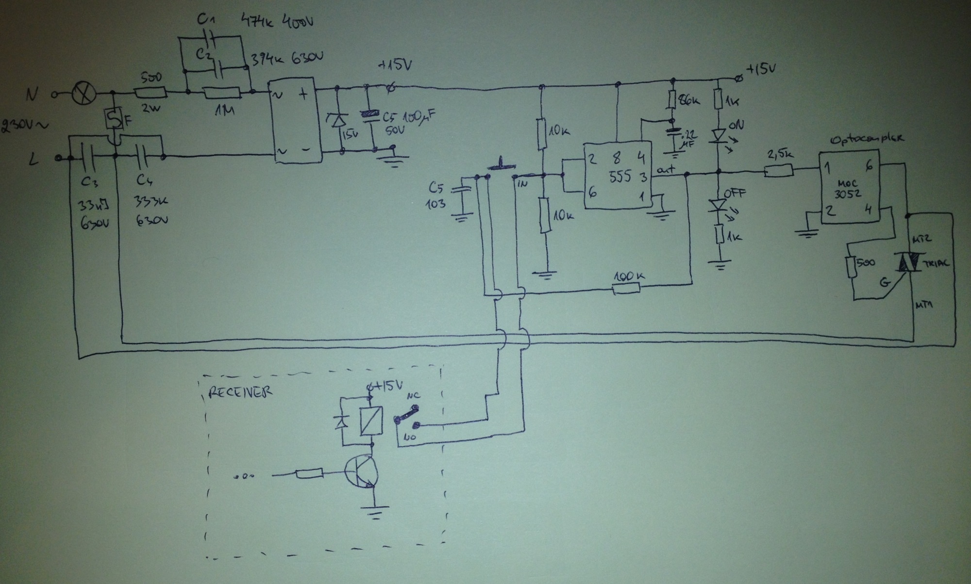

Those 2 caps are in parallel because I don't have bigger and single cap. As far as I know the capacitance total is equal to the capacitances in parallel, so I cannot get your remark about the "network".
I've made 2 small changes in the 555 cuircuit being the following:
- i skiped to draw the capacitor connected to ground and to the button (now it is shown)
- i have connected the ON led to positive (it was in series with the optocoupler before)
- replaced the 12v zenner with 15v zenner.
Nevertheless the circuit is still working as shown on the video and the voltages I am measuring when bulb ON and when relay coil on are the same as mentioned in my previous post.
If you overcome the fact i am changing the circuit can you be so kind to advise on the questions i have listed in my previous post, especially the one how to trigger the 555 with something less powerful than the receiver's relay?
Thanks in advance.
Just saw one mistake: the ON led read as OFF led and the OFF led read as ON led.
Apologies..
Hello,
No i wasnt disputing that the caps are not in parallel, i was disputing the way they were drawn, that's all. The way they were drawn not the way they are connected. If they were drawn better their function would be simpler to see right off. I drew the circuit with the caps shown better, but you discarded that.
I thought you were going to use the transistor that drives the relay, but i see now this isnt so simple because the transistor of the RF is connected to line through the bridge rectifier. So how about using a lower current (coil current) relay?
Or, change the 555 to something else which can trigger with a positive or ground signal rather than a relay (or switch) contact closure. Im sure there are lots of other ways to do that. Then the transistor of the RF unit can drive it directly.

Ok, I have made the optocoupler with LDR!
White LED, LDR. The LDR has 2M ohm resistance when diode off and 0 when diode on.
Now how to substitute tge relay? Just to put the optocoupler made instead of the relay and with 1k R in series, removing the diode across the relay coil as well?
Or even better, maybe I can avoid the transistor of the receiver also and connect the LDR optocoupler right after the R, before the receiver's transistor... ?

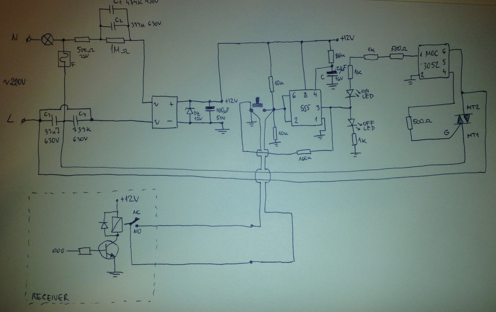

So I used a IC Reed relay and just substituted the RF relay.
You can see video on the prototype:
https://youtu.be/I0CsAzSXdEM
However I can still observe 2 issues:
1. The current dropping R being now 10watt 540ohm is getting really hot!
After 5 mins of work I cannot touch it for more than a second (mains disconnected);
2. If you watch the video at the end of it, several skips can be observed. It happens sometimes the command not to be followed, or just a blink to be produced.
I am suspecting the bistable 555 circuit, but ..
Also tried with a cap 1000uF 16V connected in parallel to the supply before and close to 555 but it happens sometimes with it as well, maybe a bit less...
What is different now on the circuit is that I've connected the pin 5 of 555 to GND via cap .1nF. But with or without it i see no difference.
Any ideas how to improve the above 2 points?

Where can i see the entire circuit the way it really is now?
Hi again,
Here are the changes that will help the problems.
1. Short out the fuse where it is now, move it to be in series with the N input line terminal. Make it a 500ma unit if you can but no larger than 1 amp.
2. Change R560 to 330 ohms, at least 2 watts for now. We can probably get away with a 1 watt here.
3. Remove C2, the 394k cap.
4. Make sure the bridge rectifier is rated for at least 1 amp.
5. Disconnect everything from the bridge rect (+) output, except the C5 cap (+) terminal.
6. Keep C5 capacitor (+) terminal connected to bridge rect (+) output, but that's the only thing to connect the the bridge (+) output.
7. Connect a 100 ohm resistor between the capacitor C5 (+) terminal and the zener cathode.
8. Connect the rest of the circuit to the zener cathode (like the 555 etc.).
9. Redraw the circuit and post here.
10. Test.
The above changes will help it work better and also make it safer.
