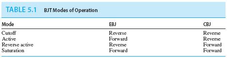

I'm studying for a test in my microelectronics class, and I'm having some difficulty remembering what the tests are to see if the transistor is in Forward Active Mode or Saturation mode.
For both cases ib > 0A, (or else it is cut off).
In my notes I have:
Vcb > -0.4V for npn and Vcb <-0.4V for pnp in F.A.M.
Is this correct? My friend who took the course last year said that it should be Vc<Vb for a pnp. So I'm confused?? If i do use the -0.4V, where does that value come from?
Now for Saturation mode, am I just checking to see if the calulated Beta (by using a ratio of the currents, like Ic/Ib) is less than the given Beta?
Where would I use the Vce(sat)=0.2V that is given to me?

Here's my 2 cents;
For a transistor to operate normally the base should be reversed biased with respect to the collector and forward biased against the emitter. So for a NPN, base less positive than collector. For a PNP just the opposite, base less negative than collector. I am not sure where the 0.4v fits in, 0.6 or 0.7 I know :?
This implies that Vce(sat) is 0.2 volts, which is not universly true. In the active mode, the Vcb is usually positive.
You are correct that in the saturated mode, the base current is higher than in the active mode.
Cutoff - emitter base junction reverse biased and collector base junction reverse biased
Active - emitter base junction forward biased and collector base junction reverse biased
Saturation - emitter base junction forward biased and collector base junction forward biased

oh okay. i only have the 5th chapter of the 5th edition which can be downloaded free from sedra's website. anyway i have attatched the table which shows the modes of operation of BJTs.
