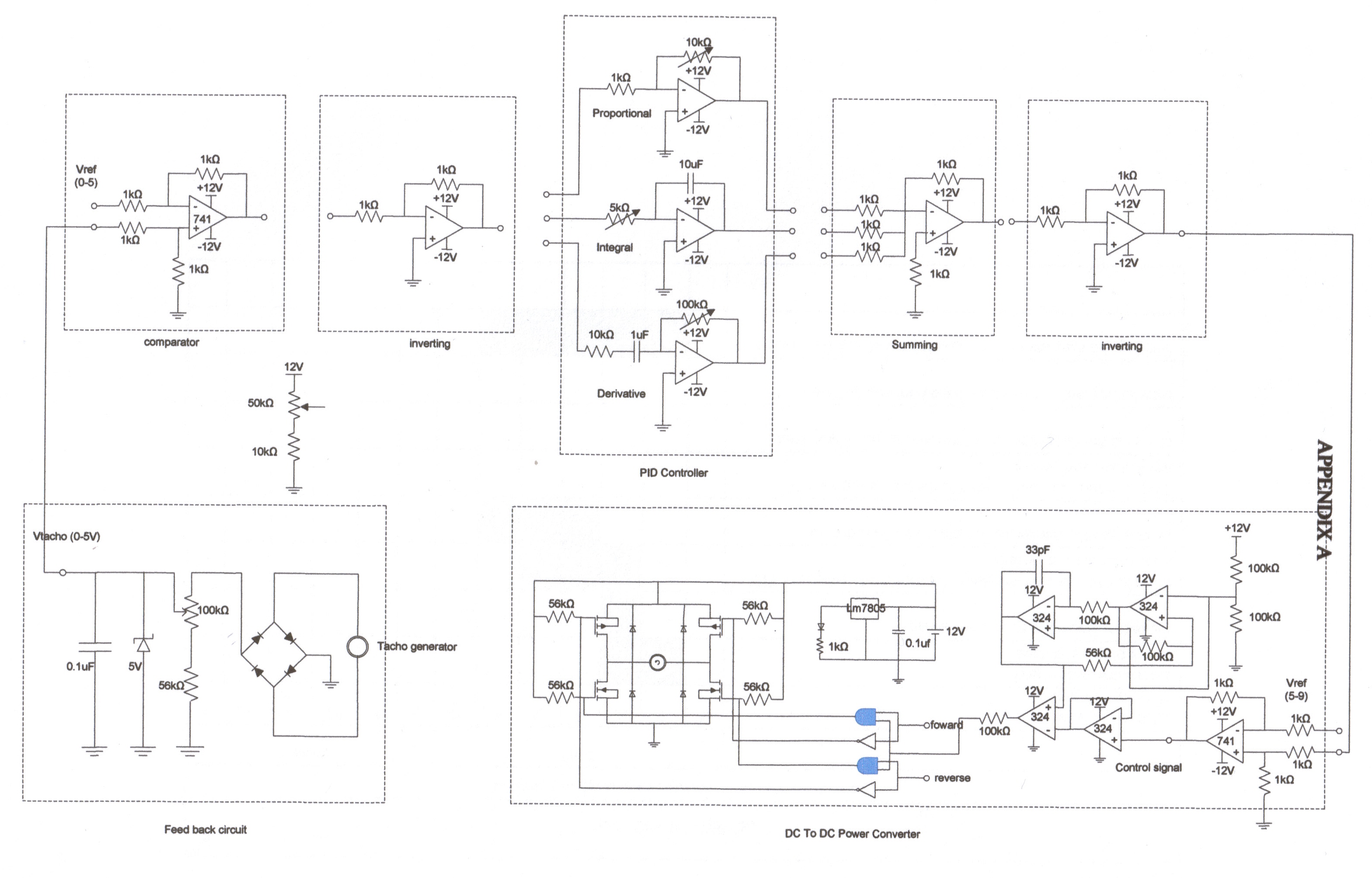

My lecturer gave me a circuit to complete the PID controller project. however I'm not understanding the functions and the way the circuit is given. Can someone tell me what is the function of each part and how it operates and I'll be happy if can give the link of this circuit
