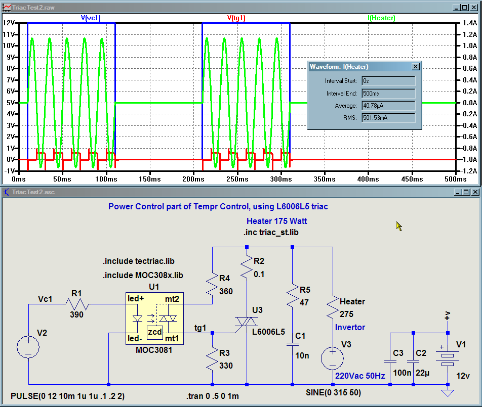

hi Andrew,
Look at this simplified circuit showing only the power side.
With ref to the 'high' currents you noted, these are peak currents.!
To see the RMS current value window, press and hold down the kbd Ctrl key and left click on the Heater current label at the top of the plot.
  • TriacTest2.asc

1.) The file I sent you had one error. The value of C4 I entered as 0.01 ...... it would appear as if the model does not understand 0.01 and requires at least a "u" behind for the value to register in the model. With the 0.01uF value correctly entered the file I sent you appears to operate correctly. Sorry about that ommision that is part of my Spice learning curve. Would you please confirm this fact on your side?
2.) Inadvetently, through playingwith values, I came up with a trace that I am curious about. On the model I sent you last night make R15=680R and the C4=16uF. When running the simulation, a current of about .22A r.m.s. flows during the OFF period. Surely this cannot be as the Opto device is OFF. If this is correct would this not be good news as then in the OFF stage there remains some residual heating not allowing the element to get cold, improving the response time on the next heating cycle.

The 16uF in the suppression circuit is a no,no...:)
The residual current is due to the capacitive reactance of the cap at 50Hz.
So Xcap = 1/[2*pi*50*16*10^-6] = 200R
So I= V/ ([R15] + Xcap) = 220/[680+200] = 0.244A.!!!
I would use a 100nF max.

At 100n little happens
I would not recommend it.
Consider this:
thru the 680R and 16uF you have 0.244A flowing.
So the heat dissipation in the 680R is W= I^2 * R = 0.06 * 680 = ~40Watts of wasted power!!!
EDIT:
Another important point is that 16uF will have to be a mains rated non polarised capacitor.

As I have said, the only change in this latest version is that the relay was changed to a ZCD triac in order to eliminate the relay clicks which you complained of and also allow 'ac' mains control without too much EMI.
Please refer to my previous posts regarding the changes.
