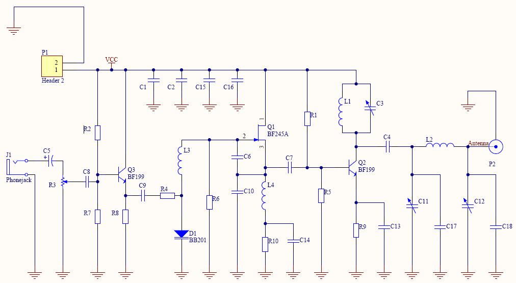

I need to make under 50mwatts FM transmitter for my uni project.All they gave us is the diagram.I have some idea about how op-amp,capacitors and resister works but when i take a look at the diagram it doesn't make any sense to me so if any1 of u please explain me where from i could begin ma project.thanks.

D1 is upside down, it's a varactor diode and should reverse biased in order to work.

The varicap looks the correct polarity to me. Don't forget it's an RF circuit.
No, it should be reverse biased, I think you're confusing it with a normal diode.

It is reverse-biased. Don't forget it's an RF circuit.

I thought varactors worked in reverse bias region? How is it reversed biased?
Whether it's RF or not makes no difference to the DC voltage across the diode.
All right you tell me, in the original circuit, what's DC voltage across the diode? Please annotate the schematic.

The varicap diode has NO DC bias. So it will work with either polarity to ground.
Correct, there is no bias.
A varicap won't work properly without a slight negative bias.
I discovered this myself when messing around with a varicap VCO.
Where does it get its negative bias from?
The cathode is connected to 0V and R6 connects the anode to 0V. If anything there's a slight positive bias from the tiny gate leakage current from Q1.

D1 is upside down,
So it is - well spotted.

I still say there is reverse bias.
Shall I go with the majority and 'say I was wrong' ? Or shall I prove it ?
Nah!!! I'll leave it open...... :D
If you let the preamp blast a very high signal then the vari-cap diode will rectify the signal and develop some bias. The audio coupling capacitor C9 might be able to hold the bias for a moment until the next audio peak.
