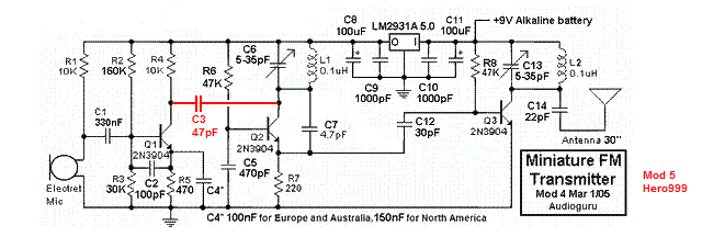

Just thought I ought to re-post the OP circuit, for easy reference.
diagram-jpg.31726
It makes some AM in addition to its FM. But an FM radio ignors the AM.
You don't get any AM from a varicap oscillator, you can bias it to give maximum output so you don't have to worry about any clipping.
EDIT:
Here's an idea: why not RF couple the oscillator to the amplifier?
The capacitance of Q1 will change with the audio level and C3 will have a very high impedance at audio so it won't cause any AM. The output impedance of Tr1 should be high enough not to load the RF stage too much.
