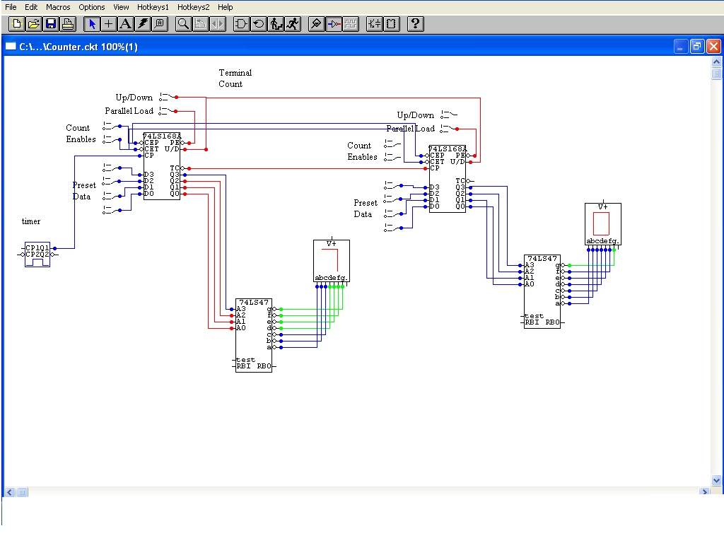

Up/Down counter
You can also make an U/D counter using a 74LS192, a synchronous binary U/D counter. If you don't need the preset values just don't wire them. Keeping "up" input high and clocking "down" input it will count down and it will count up keeping input "down" high and clocking "up". They can easily be cascaded by using "carry" and "borrow" outputs to clock the next stage.
A 74LS47 will decode the 4bit binary outputs to seven segement common cathode displays, using a 74LS48 the sixes and nines will have tails.

my project still not working.....i've construct the circuit using multisim....but not working...anyone else could help me..???i have little knowledge in electronix....so complicated explanation sometimes i not understand.....:)

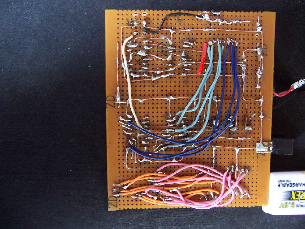

I have a cct for you, sorry I took so long Ive been on holidays but I wanted to build it so that I would not give you a cct that did not work. It counts up and down from 00 to 99 and has a reset to 00. Tomorrow I will get on the FL part. The question is do you require to keep the count when you display FL? or do you display FL and do a reset to 00?
By the way although the cct is reasonably simple. the actual construction is quite difficult, roughly 100 -120 connections to solder depending on which way you route the connections.
Cheers RH

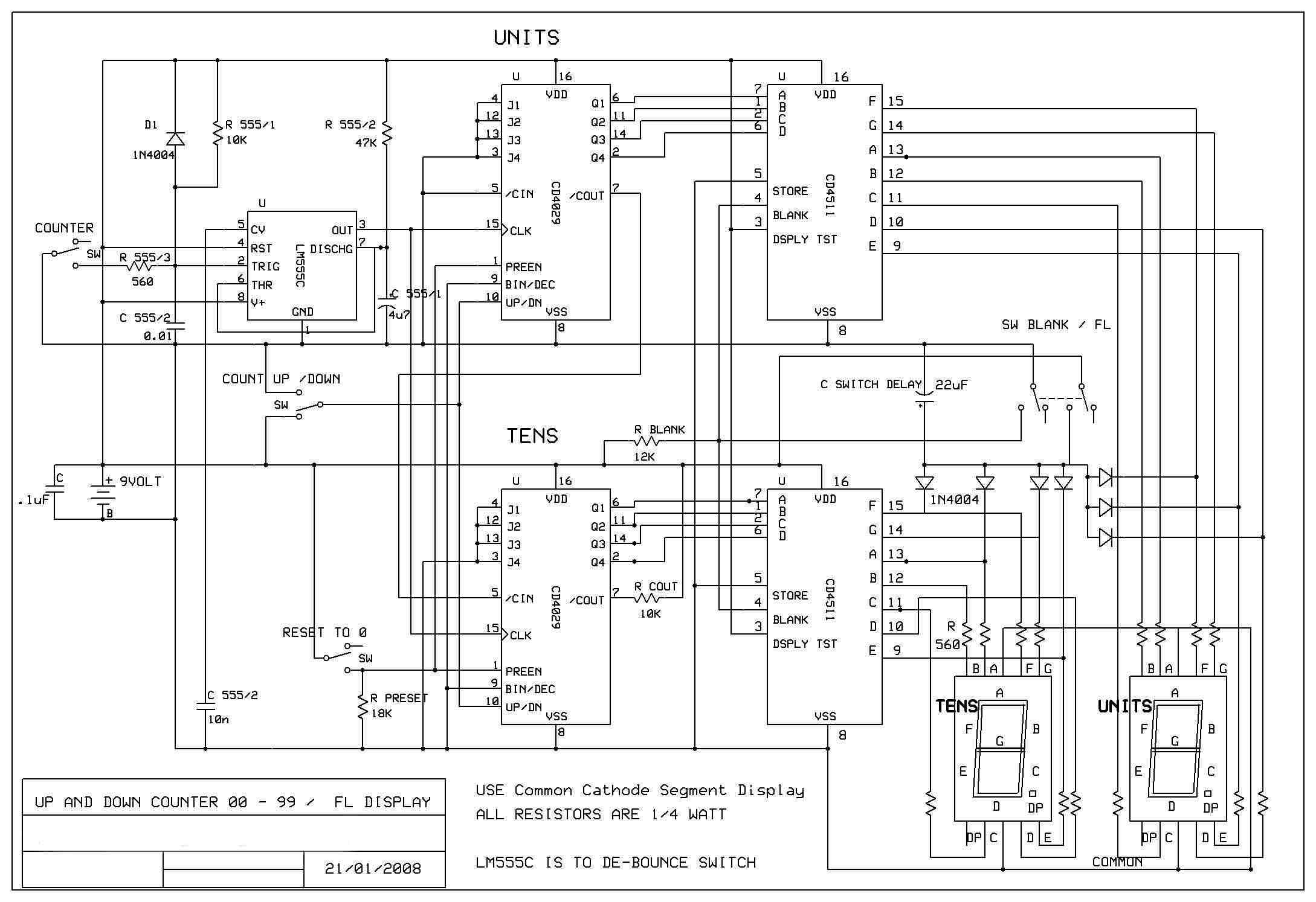

counter schematic

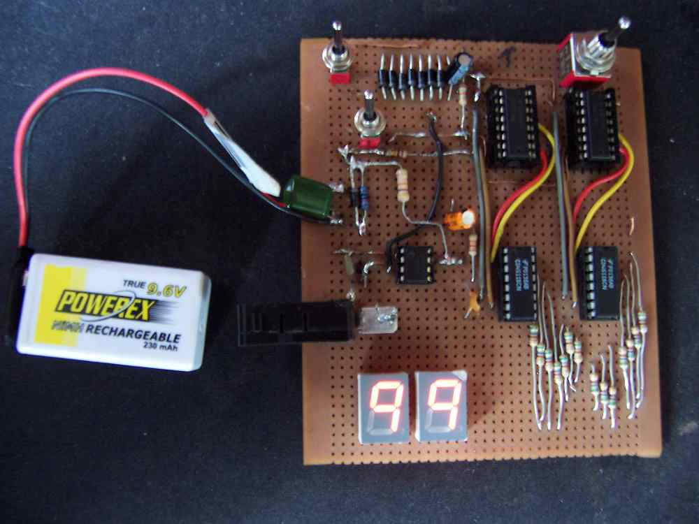

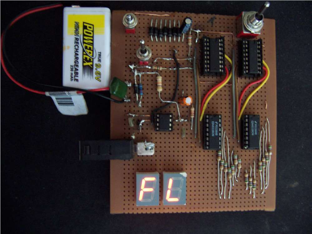

Hi, Hafi2_07 here is the circuit, I tried to upload last night but my ISP had problems.
The cct is built and tested. it counts up and down from 00-99 backwards or forwards. It keeps the count or you can keep counting while FL is displayed.
It resets to 00 if you wish. I had to use 4029's as I could not get 4510's.
i used a 555ic to develop a pulse for counting as the switch was very noisy and cused extra pulse to be counted. r 555/2 and c555/1 can be altered if your switch is extra noisy. I selected these values to give a fast reliable count. If you really are counting very fast then yo can probably lower these values. C switch delay 22UF is to allow the display to blank before displaying FL.
More experienced persons will probably find more elegant ways to do some things, but this circuit works well as it is. I have built and tested it.
Enjoy, btw what will you use it for and what does FL stand for.
As I said before the cct is reasonably simple but the construction is a "*****".(About 140 solder joints)
Cheers RH

Dican, sorry, I have never used a 74lsxxxx IC so I would be giving you the wrong info. However, apart from the voltages there should be no problems using 74Ics as they are basically the same (I believe). The cct using 4XXX ICs works. Substitute the equivalent 74xxxx IC (look at the data sheets) and you should be able to construct the same. OR use the the cct I supplied --- it works!!
NB, I had never used an 4000 IC before this project (up/down counter) so I learned using the data sheets. It really is not so difficult and there are any number of 555 IC tutorials to help you to "debounce" the switch.(stop it from counting noise pulses) and give the wrong count. (I used this project as a learning experience for my next project) I learned a lot. Give it a go yourself.
