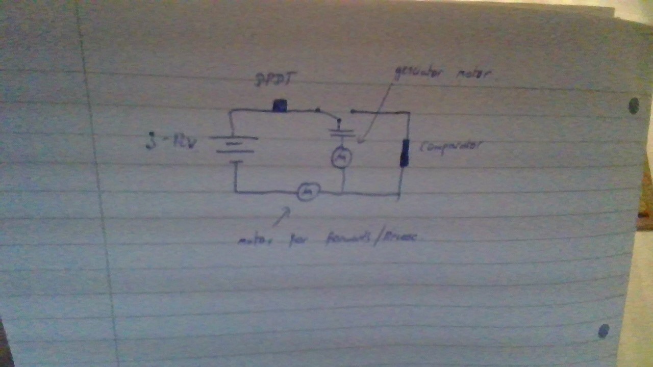

Basically i need to make a autonomous model car to hit a wall at an unknown distance and return to its original position.
My idea was to potentially have a capacitor charge and discharge 2 different motors, with a DPDT switch to reverse the polarity of the 2nd motor so that it reverses.
A circuit diagram would be incredibly helpful.
Thanks in advance.
This presumably is a school/college assignment?
I have no idea what you mean. You can't 'charge' a motor.
Why do you need two motors?
What will the first motor do when the second one is reversed?
Because it has to hit a wall at unknown distance i thought a capacitor could charge on the way there. Then when it hits the wall it starts to discharge in reverse so it goes back to original position.
i have attached what i kind of had in mind.

I think you will have one motor to drive the car forwards and reverse. Then the second motor is a generator that measures the distance by charging a capacitor while the car drives forwards then the capacitor discharges while the car drives in reverse and causes the car to stop when it is completely discharged. Then you need an electronic circuit to measure the capacitor voltage as it discharges and to stop the car when it detects a full discharge.
The battery must power the driving motor in reverse because even a huge capacitor cannot produce enough power to drive the car.

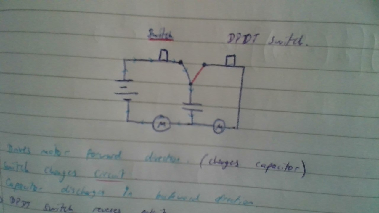

Excuse my knowledge, quality of image and representation of the components but is this something it would look like?

You show the drive motor powered only for a fraction of a second while the capacitor charges then the drive motor stops. Also, you show a single pole switch (SPDT) that completely disconnects the drive motor when it is switched to the comparator. But your comparator circuit looks like a simple resistor that will do nothing.
Why try to do an electrical/electronic project when you know nothing about them?

I think the idea of measuring the distance an storing the information aa a charge on a capacitor is a non starter. I would suggest putting a sensor on the motor to count revolutions. Use the pulses to increment a counter when the car is moving forward and decrement them when it is reversing. When the counter reaches it's starting value (Which could be chosen to be zero.) the motor is stopped. Using a microcontroller would be the simplest way to implement this.

Google should find you motors with sensors ('shaft encoders'). An H-bridge of transistors can be used to reverse a motor. Incrementing/decrementing a count is a standard software procedure.
You wil not need the DPDT switch as the reversing of the motor can be done using a H-bridge as alec_t suggested. You will need some form of switch or sensor to detect when it reaches the wall. You can get motors with quadrature encoders which give direction information as well as the number of positiones moved. You may get away with just simple sensor that gives one (Or more.) pulses per revolution. You would then use the direction informaton to decide if a pulse increments od decrements the counter. I have used this system to control a roller blind. It had to initially be tought the count coresponding to the up and down positions. It has worked perfectly for several years.
You will have to write your own software for the microcontroller. I would suggest one of the PIC16F series or Atmel ATtiny series of microcontrollers. You could do this without a microcontroller but it would take quite a number of ICs.
