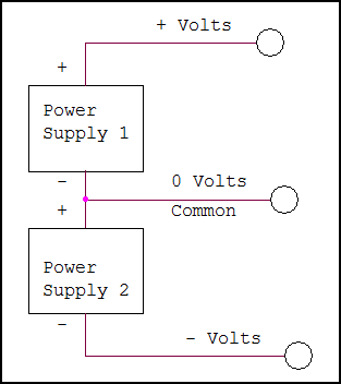

I have two +15V separate supplies. How can I cascade them to get +/- 15V dual supply ? Is it possible to make a virtual ground there ?
If the supplies are separate then.
+15v ..... 0V link to +15v ........-15v
the 0v & +15V link are your common 0V.
Like the attached picture. Just remember these are isolated output supplies as Eric mentions.
