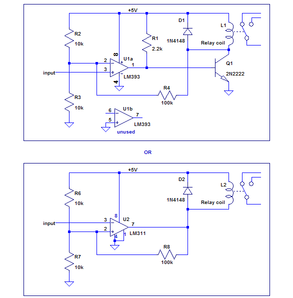

If you use a small enough relay then you could use an LM311 as it can power it without an external driver transistor.

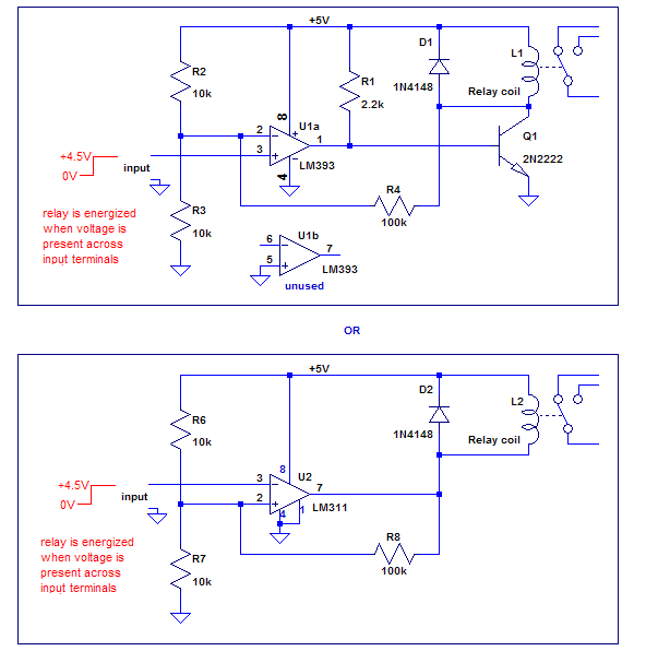

Here are a couple of options.

Thanks a bunch! I see the second one uses the LM311 to drive a small relay directly (thanks Hero999) without the need for the driver transistor as for the LM393. I think I will get some of each to try it both ways. I can think of plenty of uses for this item!
In reading through the data sheets, and analyzing the schematics, I am trying to understand why the LM311 can drive the relay directly, while the single voltage comparator (U1a) needs the R1 and Q1 to drive the relay. Is this just to show how to do it if the relay had a heavier coil (L1), or am I missing something in the different output level provided by the LM311 vs the LM393 ?
The input pin #3 on the schematic for the LM393 is marked as + (pos), while the input pin #3 for the LM311 is marked as - (neg). Does this mean that for the LM393 circuit the input is the positive side of the flash trigger circuit, while for the LM311 circuit the input gets connected to the negative side of the flash trigger circuit?

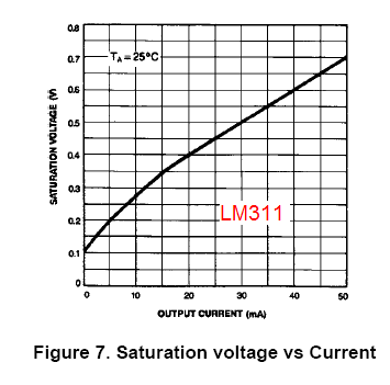

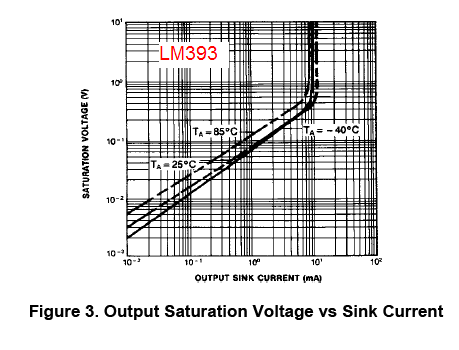

The LM311 can sink up to about 50mA, while the LM393 can only sink about 10mA max. See the curves below.
See the annotated schematic below. If you use a form C relay (SPDT), you can use the appropriate set of terminals to energize your slave. If you use a SPST relay, and you need the relay energized when the input is zero volts, we will have to make a few changes to the circuits.
If the supply voltage were 9 or 12 volts, would the input resistors need different values? It doesn't appear that way, as the data sheets allow a supply to 15 volts.
The voltage divider on the input would need to be changed so that the switching point stays at around 2.5V. Alternately, you could change the lower 10k resistor to a 2.5V reference IC. Then it would be independent of the supply voltage.

I used Linear Technology's SwitcherCAD III (aka LTspice), which is also a simulator, although I didn't simulate these circuits.

At the local Radio Shack, I was only able to get a LM339 which is a Quad Comparator similar to the LM393. I made the first circuit powered first by 3 AA cells, then 4 AA cells (5.6 volts), with the same results in each case:
Findings:
1) To fire the flash- short across the flash terminals (input pin 3 to ground). This will only occur if the positive leg of the flash is attached to the circuit ground and the negative leg of the flash goes to pin 3 which is marked as the positive input. In the circuit for the LM311, the flash input is marked as the negative, while it is marked as the positive in the LM393 circuit. Does this polarity matter?
2) Relay is immediately energized upon connecting the power supply, even if flash trigger voltage goes to zero, or flash is taken out of circuit.
Components of circuit and wiring have been checked and rechecked...
I tried wiring without the transistor as in the second schemetic, but the LM339 didn't provide enough output to drive the relay at all.
The relay should not energize upon adding the 6 volt power supply when the flash is not connected, and I am not sure why it seems that the flash is connected in reverse.

The output pin for that comparator on the LM339 is pin 1, not pin 2, according to the **broken link removed**.
