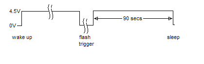

Here is a timing diagram of my understanding of your input signal to the comparator. If you can add a line to show what you need the output signal or relay closure to do, it would be helpful.
The squiggly lines just mean the time interval is indeterminate.

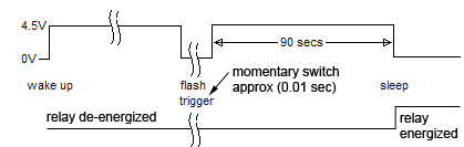

I added the timeline in the lower portion of your image showing that the relay gets energized when the flash goes into sleep mode. (I might have to also try it that the relay is de-energized when it goes into sleep mode.) The flash goes into sleep mode when there has been no activity to fire the flash within these 90 sec. The same momentary switch that is used to fire the flash is then be used via the energized relay to now connect the 6v supply to the extra wakeup contact. When the momentary switch is pressed and the flash is in sleep moed, the flash will first wake up and stay awake for another 90 sec. The relay will be de-energized connecting the momentary trigger switch so that the next time it is pressed, the flash will fire, as long as 90 sec have not elapsed, and the flash went back into sleep mode.
If this couldn't work because of something to do with the flash circuits, my next test is to use an optical sensor taped against the flash ready light. When the flash goes into sleep mode, the ready light (usually a red or green LED) will be off. The disadvantage here is that while the flash is powered on and charging the main capacitor, the ready light is off, until the flash is actually ready to fire, so the relay would cycle many more times this way.

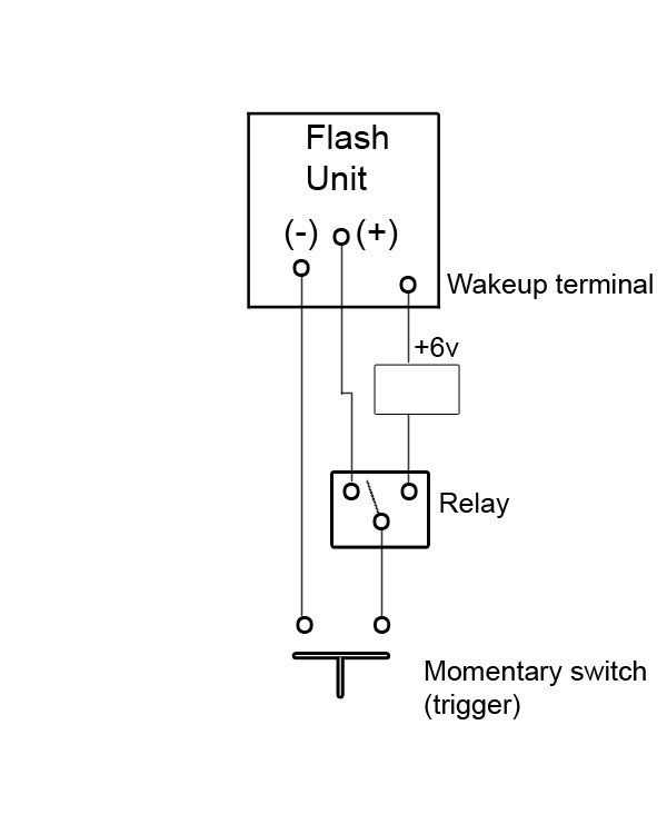

Here is what I am trying to accomplish:
It is this item # 3) which is what the relay will allow me to do, using the same momentary switch that can normally fire the flash. If the flash is awake and powered on, this switch will connect through the NC contacts of the relay to the pos terminal of the flash with the ground of the flash connected to the other side of the momentary switch. Any press of this momentary switch will fire the flash if it is charged up (ready light on).
After the 90 sec of inactivity, when the flash goes into sleep mode, the relay will energize, connecting the NO contacts of the relay to the "wakeup terminal" through the 6v supply. The next press of the momentary switch will send the 6v on to the "wakeup terminal" of the flash, which will then wake up, energize the relay which will disconnect the connection to the "wakeup terminal" and then the next press of the momentary switch will again fire the flash.
There is the possiblity that the relay will need to be energized not when the flash is in sleep mode, but in awake mode. I attached a rough drawing showing the relay, flash, and momentary switch.

In your timing diagram, you showed that the momentary contact closure would last about 10mS. How is this controlled? What if the relay switches faster than this? If this is a problem, we could probably add a little delay to the comparator.
Well, it might be a problem, in that when the flash fires, the voltage drops to zero, and the relay would try to energize briefly, which technically should be ignored, but the circuit isn't working yet, so I don't know if it is a problem. Right now the momentary switch is just a pushbutton.

I just realized that making the comparator ignore the momentary closure will allow the comparator to trigger only on the transitions to sleep, which I believe is what you want. Otherwise, it will trigger whenever the input goes low. Unfortunately, you can't possibly make the contact closure as short as 10ms. It would be easier for the comparator if the contact closure time was consistently the same, but this would require putting some circuitry between the switch and the flash. Short of that, we could make the comparator ignore anything shorter than, say, 100ms, but you would have to be certain to make all your contact closures shorter than that.
