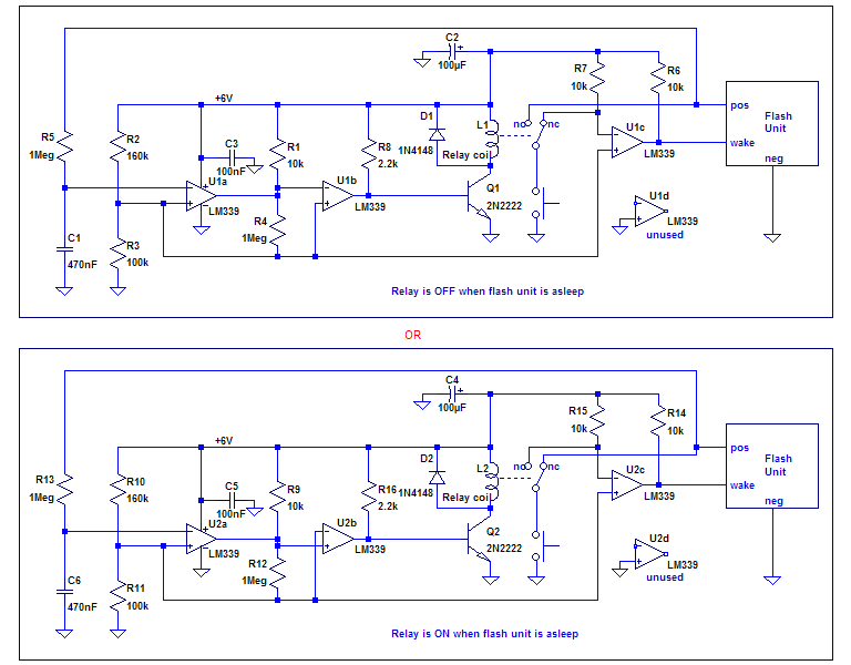

I'm working on what I hope is a final schematic. Will the flash unit spend more time asleep or awake? We can design the circuit so that the relay is off most of the time, saving power.
I have been using the time to read more about these circuits, and make notes and order components!
I think the flash usually spends more time on, but would want to be able to try it the other way also. Thanks!

You should have some LM339's on hand, as I think I might use one in the circuit.
If I understand what you are trying to do, I think this will work.
I'm sure this could be done without a relay, but I haven't put any thought into it.

Thanks, and I will play with these, and let you know what I find. The more I read and learned about these circuits, the more I kept thinking that it could be done without the relay also, but I hadn't really learned enough to figure it all the way out myself.
