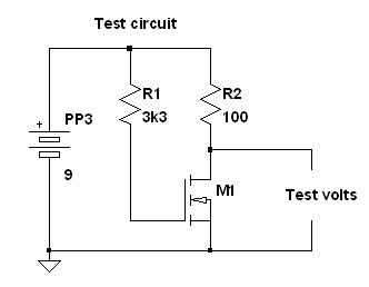

Here's a simple test circuit for the FET. A Vds measurement > 50mV would indicate the wrong FET type.
The same circuit can be used to test an SCR as used in the bulb bypass. R1 is optional for the FET test, but not for the SCR test.
Don't keep the battery connected for long, or it will die :).
I'm building the test circuit in preparation for receiving the mailed FET, but I need to test for ">50mV?" I'm not sure my multimeter goes that low. A mV is 1/1,000 of a volt, right?

Some multimeters have a low voltage scale. Mine has a 300 mV scale, but even on a 1.999 or 2V scale, you should be able to tell.

Kiss thanks. I checked mine, and it also has a 300 mV scale.
When I saw "mV," I just assumed it needed a expensive, precision instrument that I didn't have.

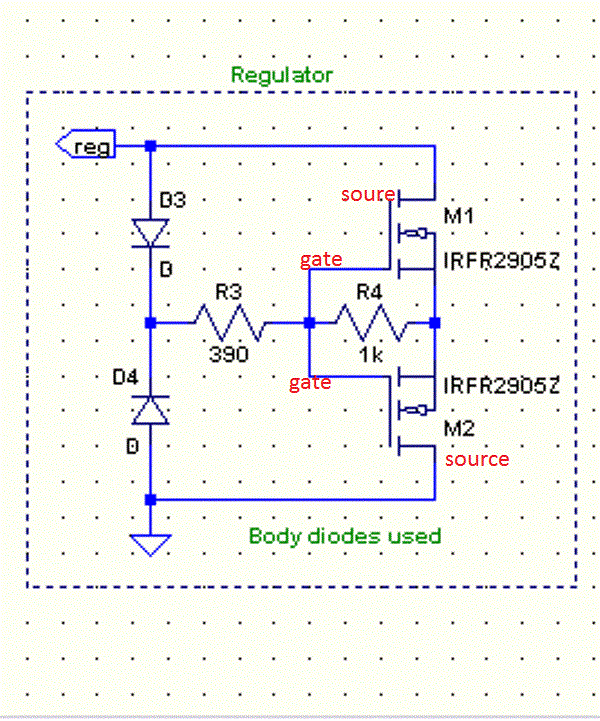

I built the circuit on a bread board, but I must admit I don't know how to test it. If I hook a battery to the board's + and - strips, then all I get is the battery's reading.
How do I set up the circuit for testing? Attached is a copy of the diagram.

Without the bulb there was no (or very little) current-limiting, so the FETs almost certainly got fried.:( Either that, or their threshold Vgs really is 8V so they're hardly turning on.
Did you use the FET-test circuit I posted, before building the regulator?
Edit: Have you correctly identified the G, S and D terminals of the FET? The two FETs should be connected S to S.

I may have misunderstood your circuit diagram as to where FET terminals go. I identified the terminals w the FET data sheet.
Attached is how I have it. If I'm wrong, can you attach a corrected version?
