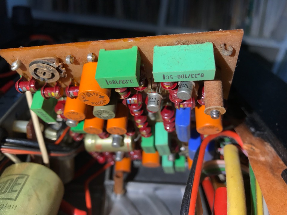

VU meter not working. Dynacord Echocord Super 76
A BC547 is rated for 45V so should do as a replacement.
Snipping the legs of the old T200 might be easier than de-soldering and would not risk copper track damage.
R206 is only 50K measured. Should be 68K.
R206 has R202, 207, 209 in parallel with it, so 50k is a reasonable measurement.

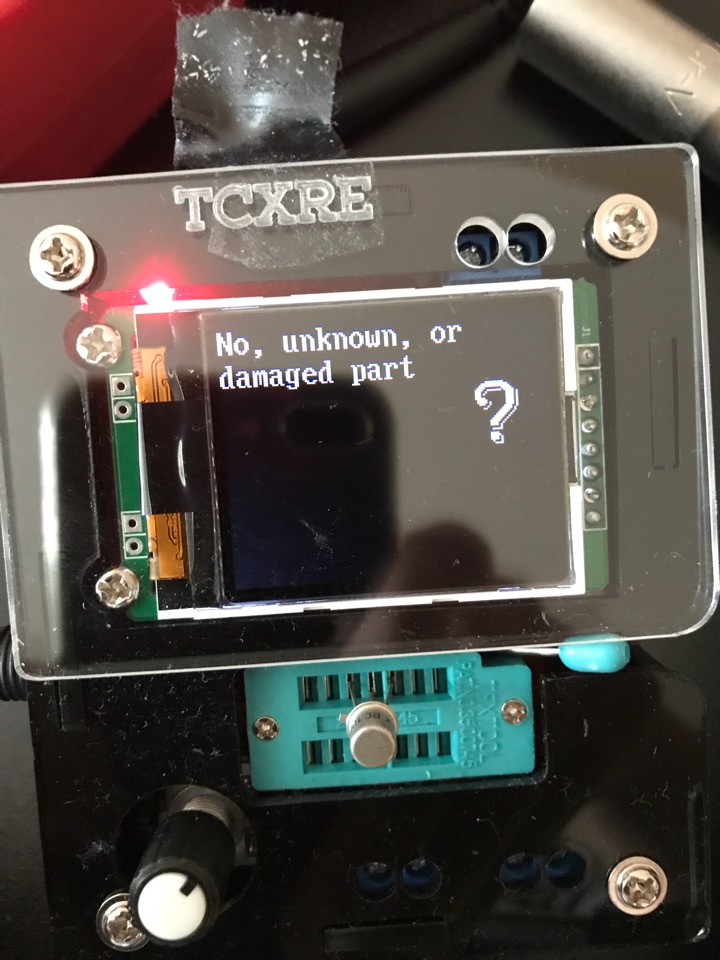

Ok have it apart now and desoldered transistor. Seem like it is a different model than whats in the schematic. BC107B
Can I still replace it with my BC547B?

Compare the information in the datasheets for both devices. If you trace the schematic of that area of the board and it matches the schematic thet you posted then almost any small signal silicon NPN transistor should work. You should be able to find the data sheets using Google or any other search engine.

Earlier type of transistors sometimes suffered from bonding wire unreliability, as others have mentioned. With the actual current and voltage levels it is unlikely that an electrical over stress damaged it.
